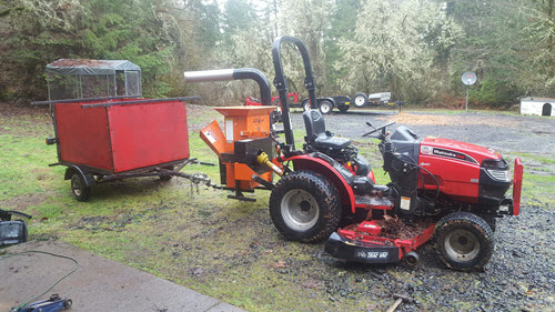

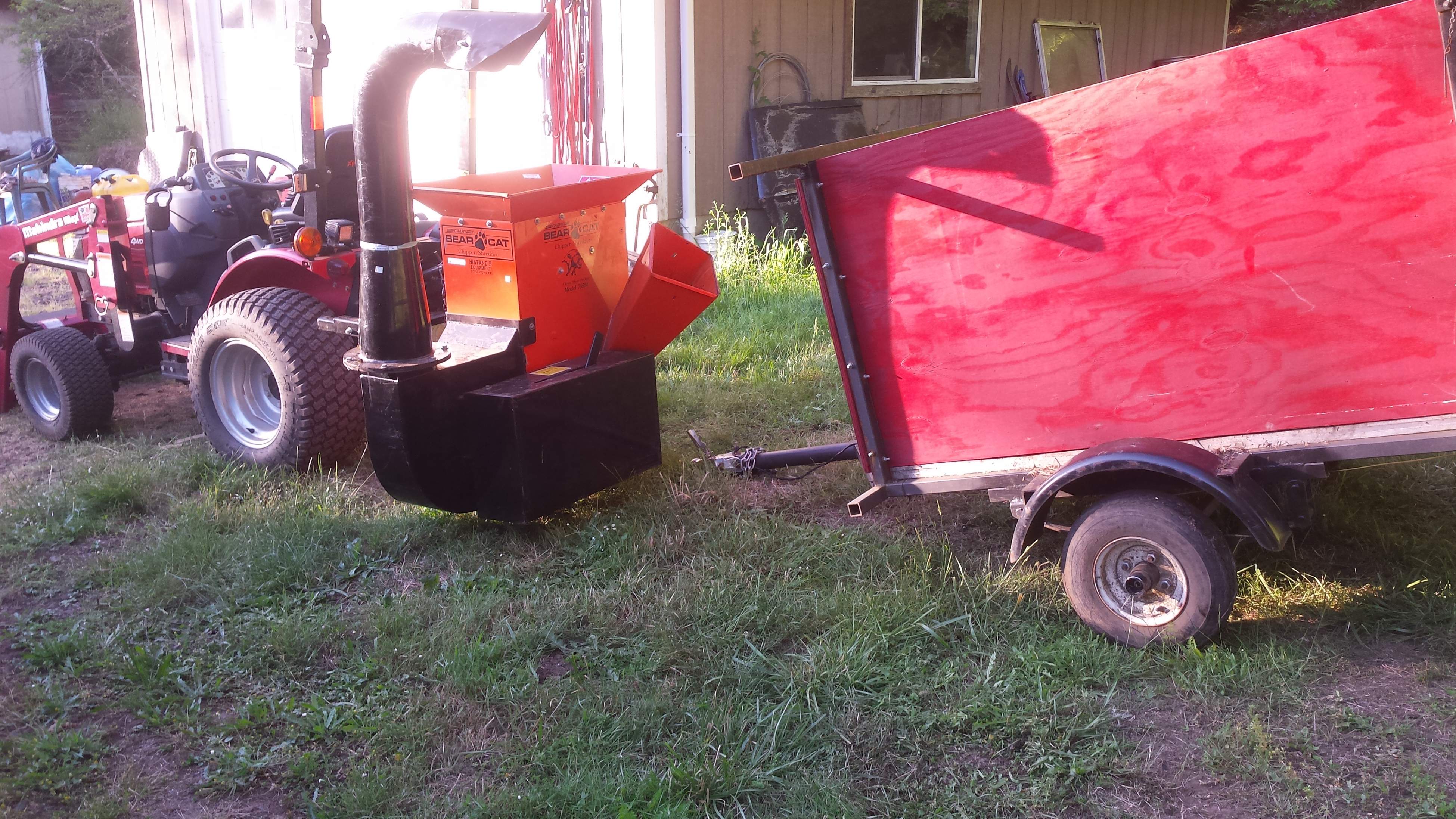

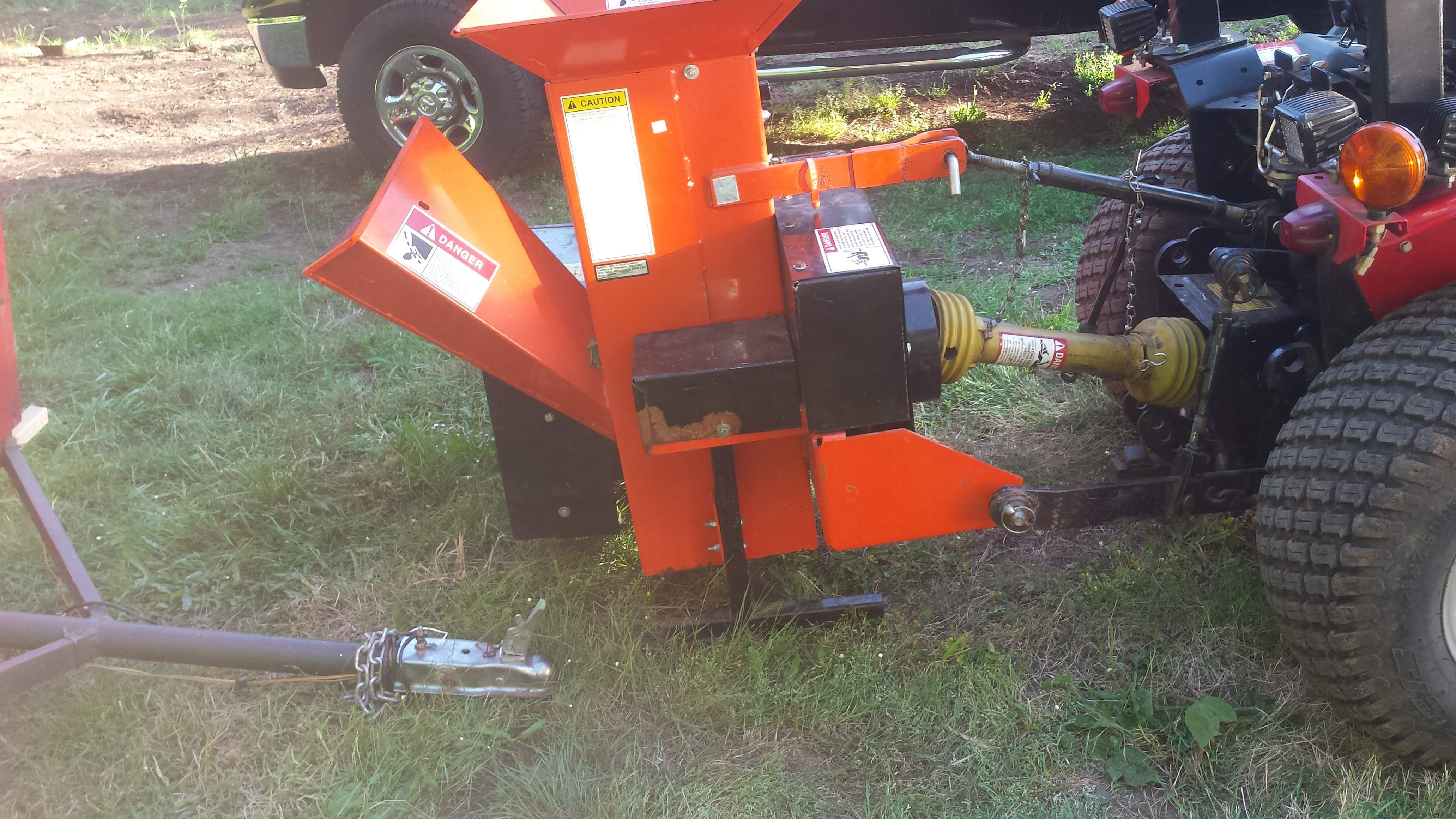

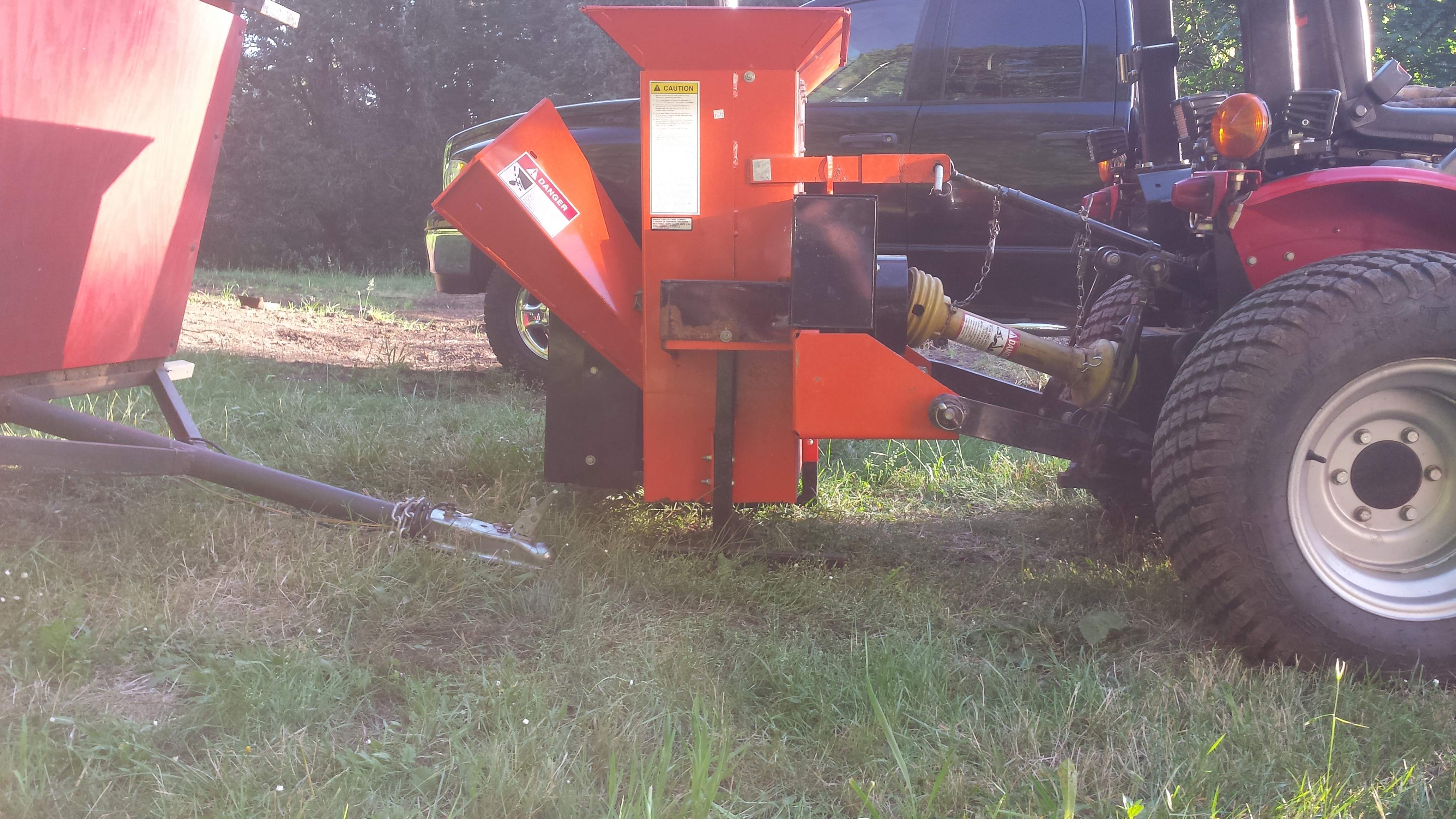

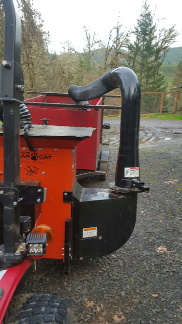

Funny you should ask... I just got it all pretty much together. Its been a fun project. Here are a few in-process photos, but I will post more of it completed. It is functional but it has been so wet and rainy here to really give it an objective thumbs up or not.

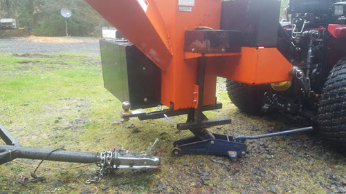

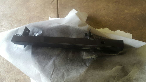

I made a bolt on receiver for the hitch to the bottom of the chipper and hit it with a little paint.

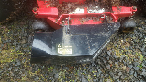

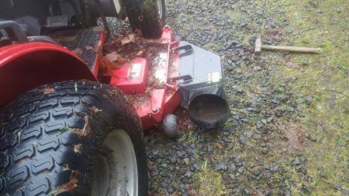

A little bit of "fitting" to do with the Trac-Vac discharge chute.

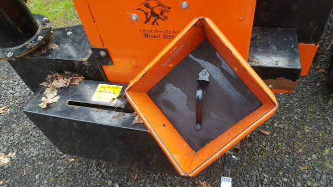

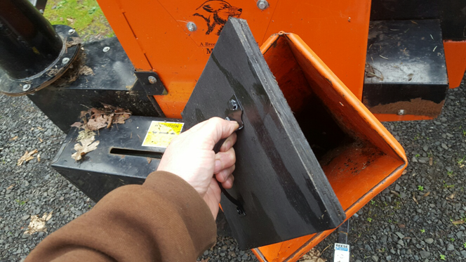

There is a square block-off plate that goes in the chipper inlet to increase the vacuum. This was made out of 3/4 plywood and a purchased handle. (not shown)

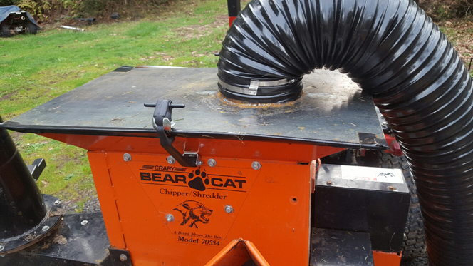

The inlet bonnet with the 8" collar is made out of steel plate. (not shown) This was a fun day teaching my son how to stick weld. But I myself (re)learned a lesson. The plate "potato-chipped" from the welding and doesn't sit flat to seal. Not sure what I'm going to do long term but for now duct tape it is! (photos forthcoming)

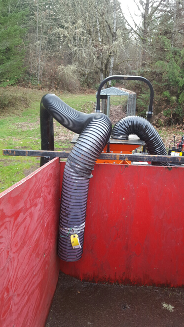

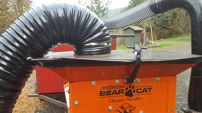

I had a short piece of 6" ss flex ducting from a chimney liner project, (shown) I was hoping to be able to use, but is too short. I purchased the 8" hose for the vacuum side and 6" hose for the discharge and clamps. (photos forthcoming).

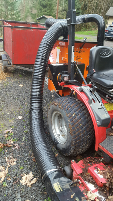

I bought a 25" length of the 8" hose and cut it to length. I have a hose coupler to re-attach it to use the excess for manual suction jobs even if the mower part doesn't work out.
The 6" discharge hose just dumps into the trailer and is held in place just with a bungee cord. This works for now, but the volume of air this thing moves is intense! I need to make a cover to help contain the debris from just flying everywhere!

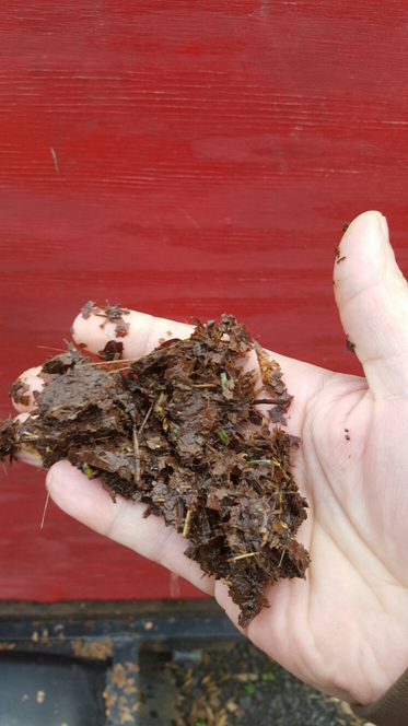

The shredder really chops up the leaves into tiny- almost dirt sized particles- much finer than I was expecting.
The whole apparatus is all pretty large and cumbersome. I have a lot of hilly and uneven terrain with trees. I will likely just mow it into windrows as much as I can first then follow up with the vac. Just waiting on dryer weather so I can deal with these leaves from this last fall that are soggy and starting to decay.

When operating, what angle do you have on the PTO? Looks pretty steep in the photos, but I suppose you lower it some while operating.
/ Leaf Vac/Chipper/Shreadder
#26
You are right. It is pretty steep. But it runs pretty good where you see it in the photo. Any higher and the safety collar would start to rub and put things in a bind. It wouldn't be an issue with a larger (taller) tractor. Its not optimal for sure. I realize what I am doing is "unconventional" for its intended purpose. In fact, I know I shouldn't even be running the chipper with it not setting down on its legs. I don't think I want to chip any wood that way.

Here are a few more photos. As you can see things are still pretty wet.

Do you have plans to add some sort of top to the cart? When things dry out a bit, the leaves will likely fly all over!
