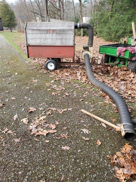

Because I hate when people don't ever report back on their thread with results...
I got the blower going again... Had a stuck valve giving me fits...4 Horse K91 Kohler... Lots of sound and furry from that vintage iron.
It is still mounted on the frame that hooks on the back of the 140. I got lucky, and that whole frame dropped on the mounting pad for the 8" blower and motor. 2 bolts, and I was in business. I had ordered the 6" adapter, and quick disconnect parts from Trac Vac, so that went well.
The 50 year old hose from the top of the blower to the hopper was a touch long, so I cut that, and it held up for today... I'll get a new hose for that.
The long hose my father got a couple decades ago was in fine shape amazingly...
So, I blew the leaves in to long piles with a backpack unit, and then we fed the leaves in with a rake.
The 6" blower worked great. I'm sure the 8" would be better, but this works fine, and I've no reason to upgrade at this point...
Unloading kinda sucks as the trailer is so low to the ground tipping it doesn't really do much. I just ended up hooking the leaves out with a hoe, which is fine...
We did two loads today, and then ran out of light. Other plans for tomorrow, but next time I'm out here, I think it'll be another half day, and it'll be done... Trees are basically done apart from those few oaks that seem to hang on to them all winter.

Depending on where you are dumping, you might try reconnecting the hoses to suction them out of the trailer.
/ Trac-Vac Rehab/Refit
#12
That could be interesting... Could even throw the output in to the input of the MacKissic shredder...
Probably too much business though unless I really need to shred them.
The hoeing works fine. I'll just be pushing the pile up once I'm done with the loader. In a season, they'll be completely composted.
