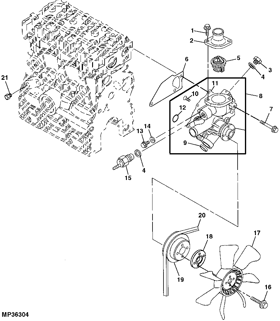

I noticed yesterday my 2320 is leaking antifreeze (2008 and about 250hrs).
It seems to be come from either the water pump gasket(s) or # 9 as depicted in this picture.
Can anyone tell me what the heck # 9 is? The parts diagram labels it as "plug". For what, a freeze plug maybe?
Could the bots just need a bit of tightening? Why now?

You sure the leak is coming from the front of the engine? Dripping off the bottom of the pump?
Reason I ask; when I plug my block heater in for a couple of hours - (it's been below minus 20 here most of this week) - my tractor will have a nice little puddle of anti-freeze near the radiator overflow hose.
I'd guess that part #9 could be an expansion plug... it'll bulge out - before the pump housing would crack - if the water mixture should ever freeze.
I'd get one of those little angle mirrors that's mounted on an extendable arm (Napa's got 'em) and look at the pump with the engine running. If it's leaking; you should be able to see it!
AKfish
If it's the gasket - usually just tightening the bolts - doesn't fix the problem. It'll likely keep seeping. You'll need to pull the pump and install a new gasket - with a touch of RV blue!

I guess you know no matter what I'll be pulling the pump. I took my inspection mirror and checked last night and I believe it is leaking from around the O-ring # 12. I want to get all the parts before I take it apart. The leak seems to stop once it is warmed up. This all seems like deja vu as I had had my JD650 for about 4 years and the water pump gasket went south on me. Changed the gasket in that and ran it of 16 more years, go figure.

Better the O ring than the pump it self or it would be an expensive fix. Years ago my JD 2030 (gas) lost the water pump. The fan began clanging on the shroud. I quickly shut it down. The bearing was bad allowing the fan to wobble, but the seal was not leaking . At that time there was a rebuild kit for the pump at about 1/4 the price of a new pump. I pulled the pump and had the dealer rebuild it.

Well my tractor went under the wrench Thursday morning and is now sittin comfortably back in the barn.
I decided to have the dealer do the work, maybe I can cry a bit to John Deere in as much as it is not even three years old yet. Dealer picked the tractor up Thursday morning and delivered it back Friday morning. $285.00 which included pickup, delivery and taxes, said to myself "I'm King I won today" BTW it was the O-Ring that was leaking.
