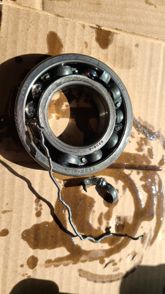

Suspect seal failure from bearing damage to be from bearings being overloaded or lack of lubrication. Changing front axle oil to a good synthetic gear oil and changing every 400 hrs may help. Was somewhat surprised how dark the original UDT front axle oil was at 400hrs in the B26. Black from the M59 at 1100hours.

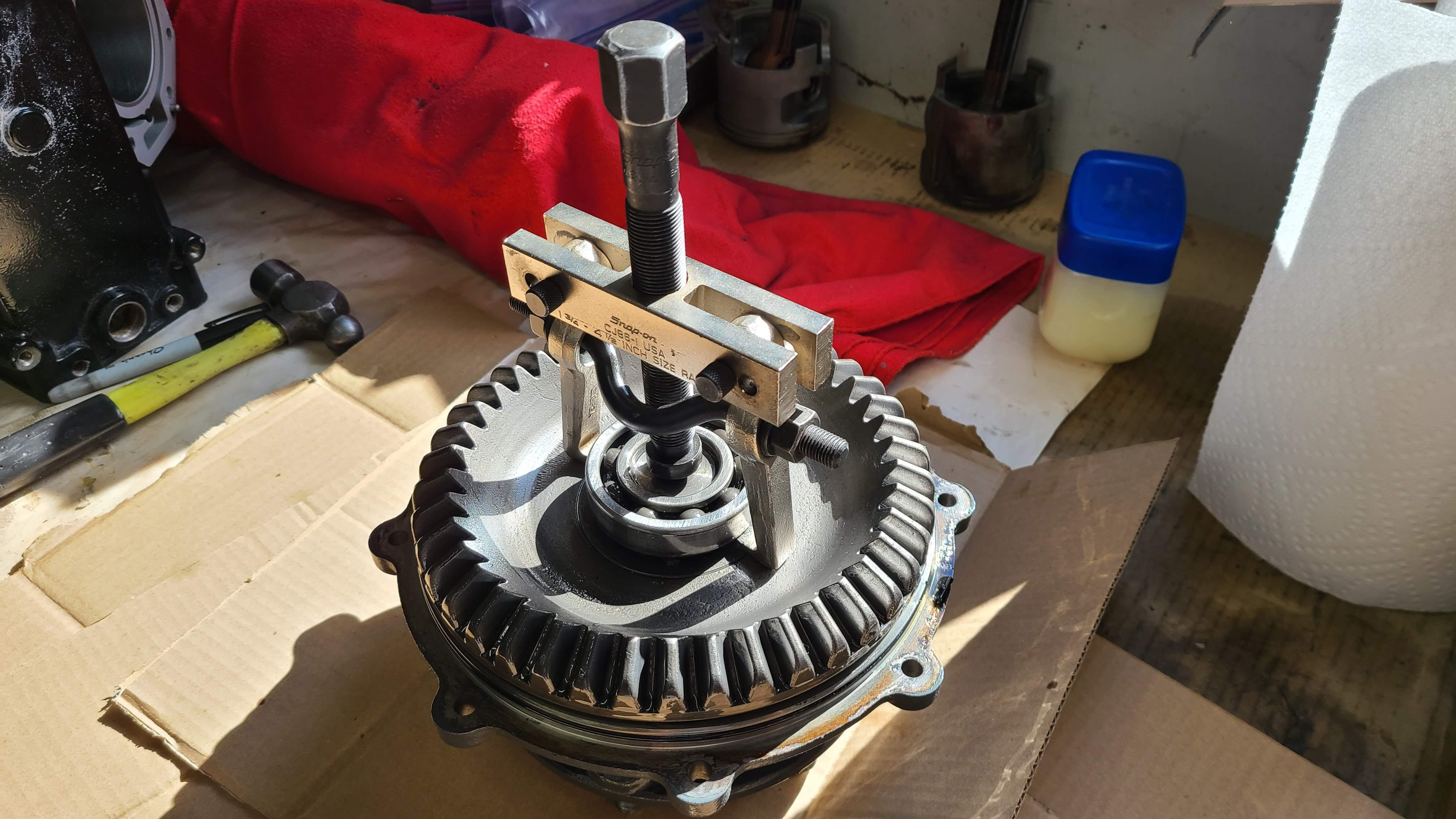

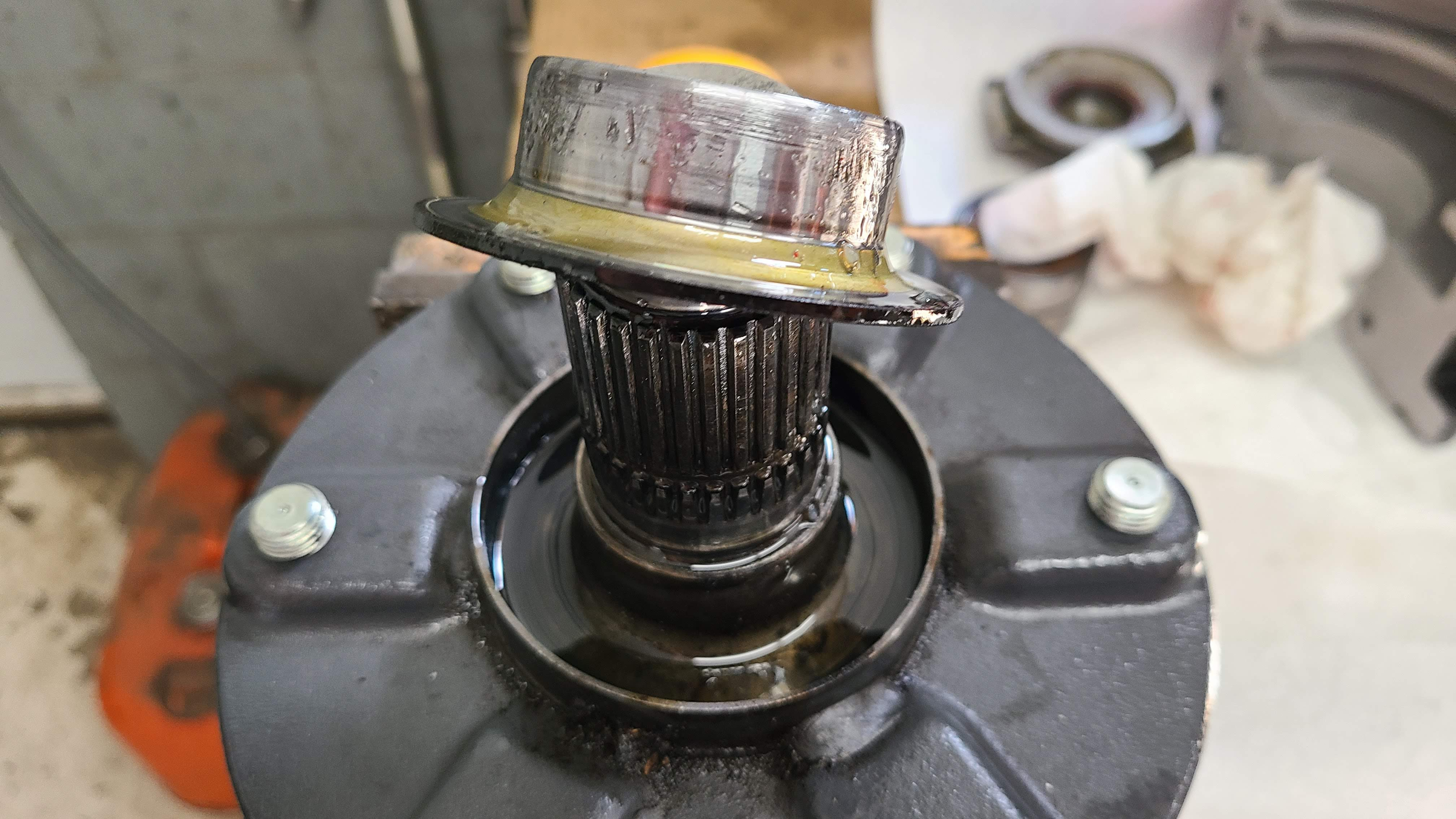

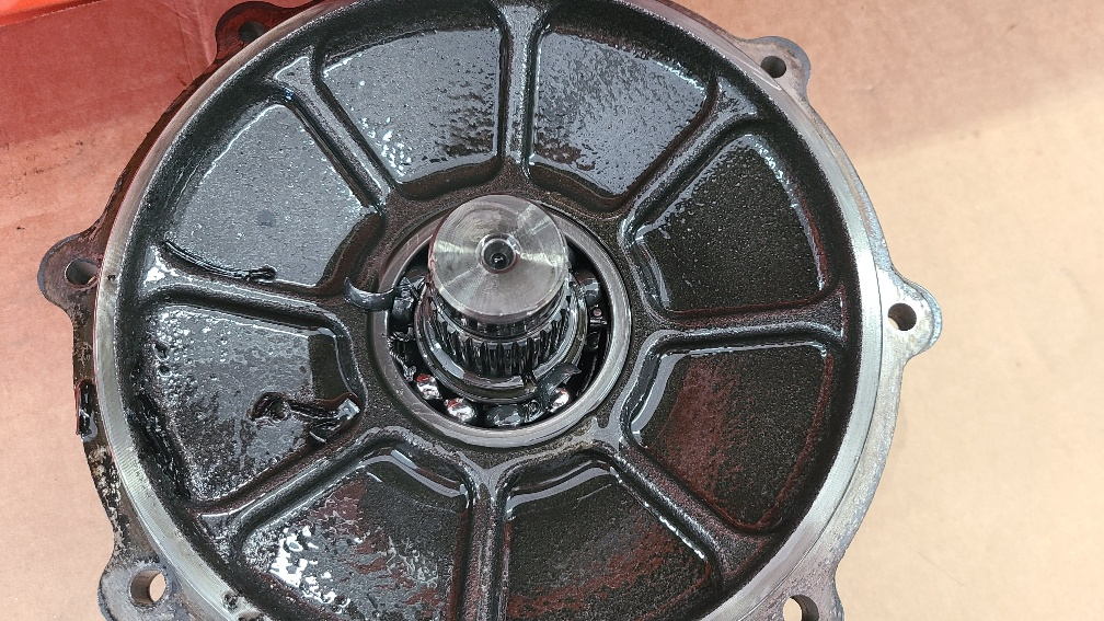

Well after sitting in Memphis for 8 days the parts finally arrived. After taking it apart it looks the same as otherside when the bearing failed. Both times it was the outer bearing. Came apart pretty easy, bearings came out really easy. The seal on spindle I used channel locks to remove it. Tricky part was installing new seal without damaging it. I used the old bearing after cleaning it up as a driver to get it all the way on spindle. 2 hour project and most of the time was fiddling with the seal!

Failure looks familiar. I have a similar puller used to remove bearing. Pick up tools like that cheap at auctions for that one time needed.
