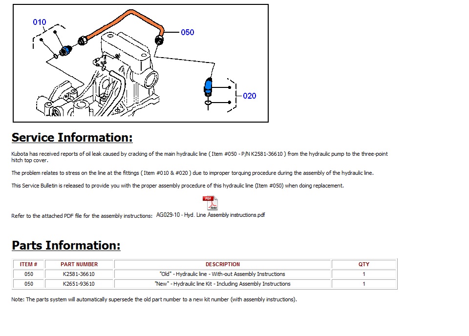

Is this the location of the leak?
   / Leaking Hydraulic Line - Same Repair 3 Times #20
This is the exact line that is cracking on the 1860....does this have a Technical Service Bulletin number or anything I could give to the service department to aid in the repair? It's back at the dealer right now for the fourth line replacement.:(
