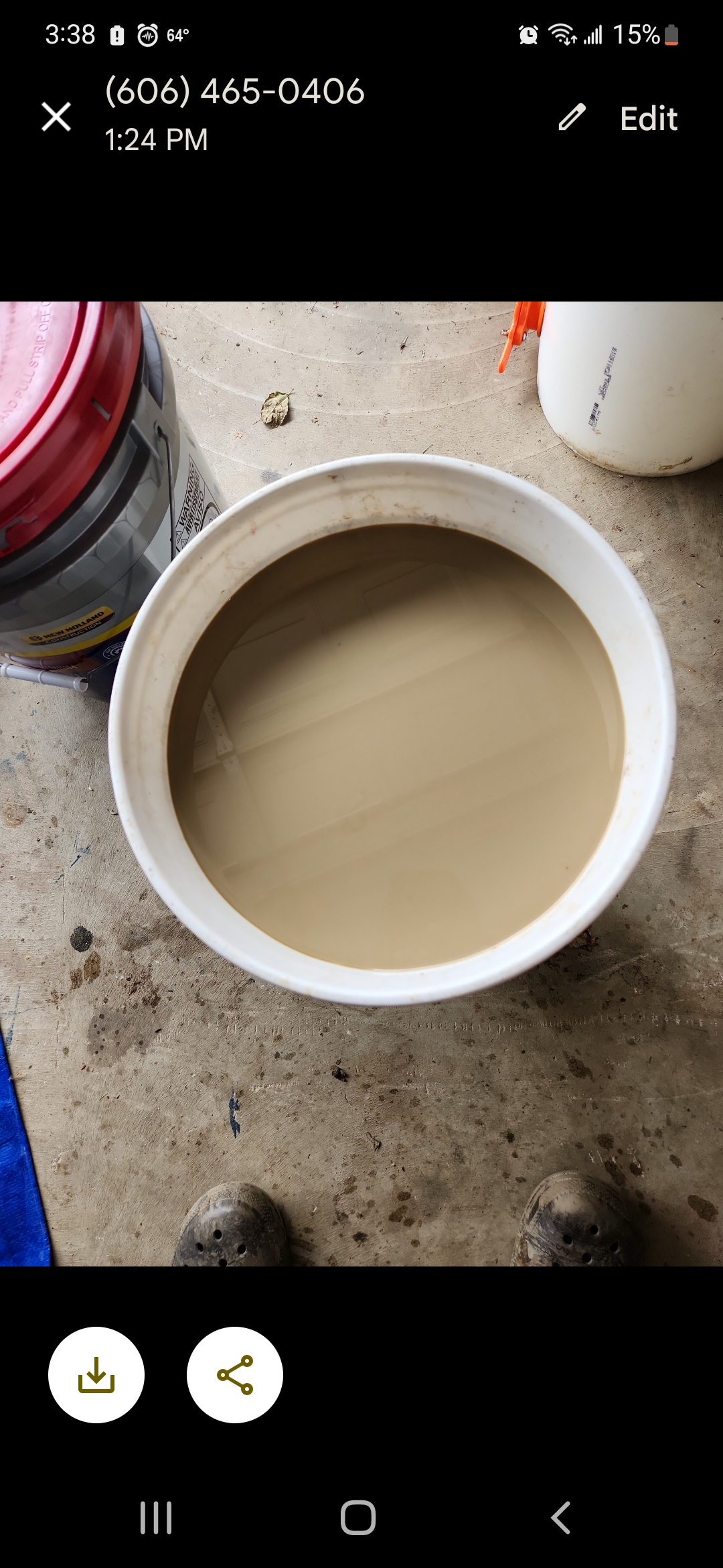

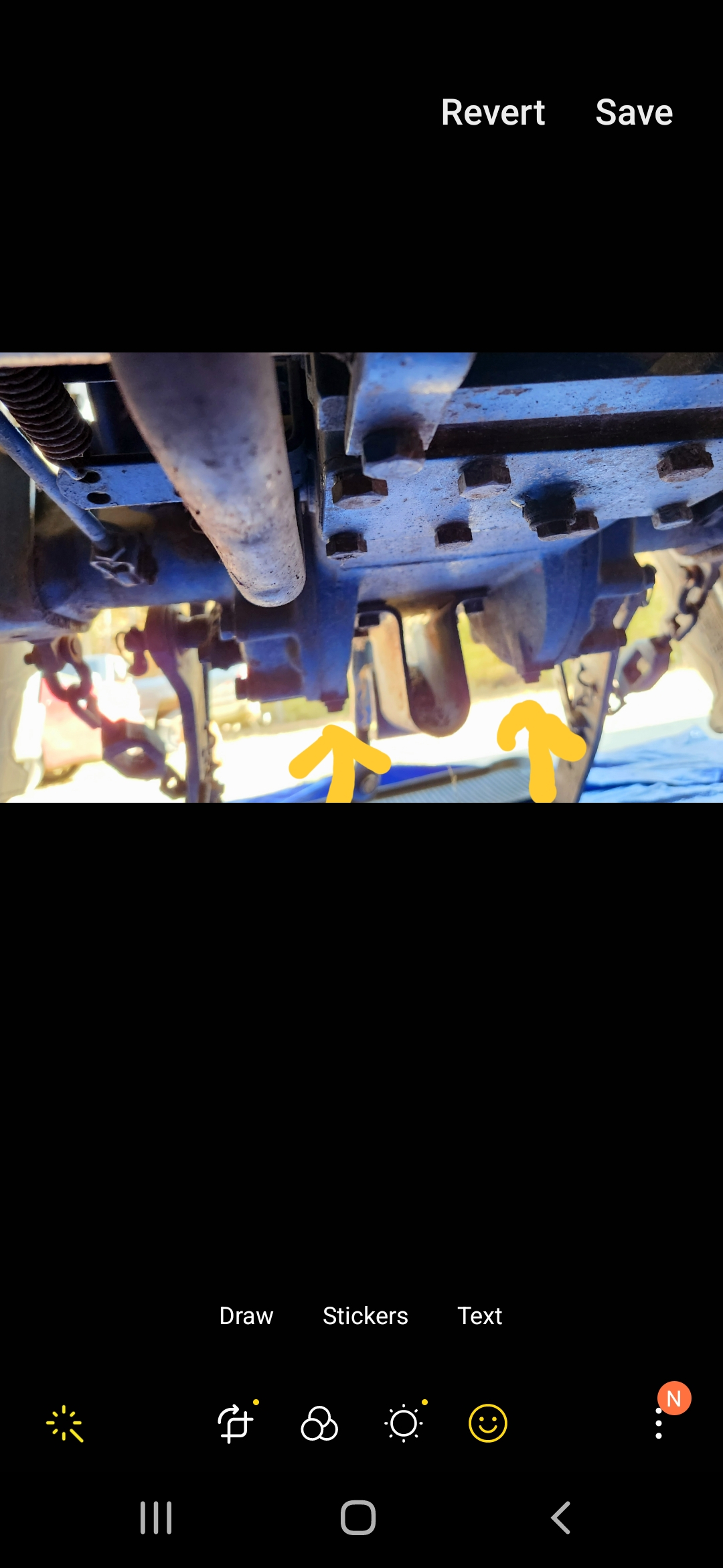

Changed most of the fluids today on old blue that chocolate milk stuff is the hydraulic/transmission oil the engine oil was Nasty and clumpy as well took the air filter off too and it was nasty so I have that metal screen soaking in kerosene but I noticed 2 plugs on the bottom of the tractor under the rear end thats the lowest point on the tractor where something could drain out of them and when I opened them up nothing was in there im trying to figure out what goes in there but I cannot get any answers or find anything as to what kind of fluid goes in there on the internet so I'm thinking that if thats for the rear end it's gotta be gear oil or something but I can't even find a place to put anything in to fill it up so I was thinking maybe it's hydraulic transmission fluid and there is something blocking it from getting to the rear end but that wouldn't make sense either so I'm pretty much lost at this point maybe one of you all can help me thanks in advance

That is the low point on the rear end/transmission. Strange nothing came out, but the fill and dipstick for the rear end/hydraulics/transmission is in the transmission cover. DO NOT use gear oil.
Hytrans, UDT, Trans/Hydraulic oil is what it uses.

when nothing comes out.... and you know there was oil... it is usually plugged with sludge... stick a screw driver in and clear out the gunk... hopefully then it will come out. Just a thought... :)

there are a number of plugs in the 1500 that must come out..usually they may be white.. but anyway.. atleast 5 plugs... 3 on the trans and 2 on the final gear box area.. to get the oil out.. usually if is very sluggy and may need to be helped a little in coming out... but definately, more than two....good luck
