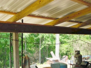

I've added to my shed using 24 foot "Z" bar from metal roof system and 4x4 treated posts. Got metal roof from salvage yard, not all the same color or gauge but grooves all match. With this metal roof my pitch is very slight. Rafters 4 foot center, 2x4 runners approx 3 foot centers.
Here's a couple of pics.
