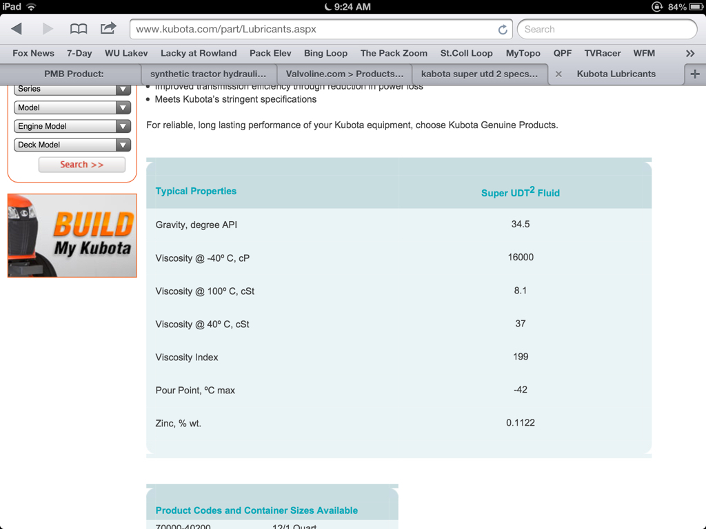

I plow with my 318 in the winter and use Kubota super UTD 2. I find it has very good cold weather characteristics. Under $22 a gallon.
   / Learned big lesson on j20d hy-gard fluid #14
I spent a lot of time on the internet looking for the -40*c viscosity value for the low vis hy guard and could not find it. The kubota super UDT 2 specs seemed to be a little better than the full synthetic Chevron. I bought 2 5gal. buckets of the super UDT2 for my Kioti Ck35 and had enough left over for the 318.
