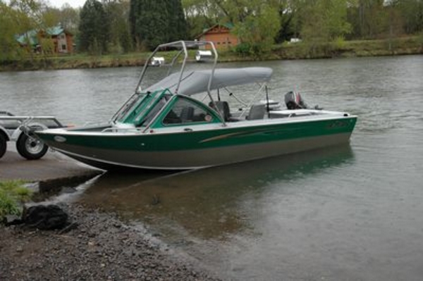

Like You , Been many years since I oxy / acet welded in high school . Never really got the hang of it then , so really doubt I would have the patience to try tig , Even though I watched my Dad weld a complete rear quarter panel on a '59 ford using nothing but a torch and 3 foot pieces of old bailing wire that I had to straighten and cut to length for him .
Here is a picture of the type boat we use to have . All Aluminum , Seen the damage one took when it hit a boulder running 40+ mph in the Rogue River here in Southern Oregon . Never broke through the hull , just a dent the size of a grapefruit which then tapered down to a 3+ foot long scratch . Bottom thickness on ours was .190 , while sides were .125 . , So , depending on what water you would be in , may consider a thicker size ??
This is the company , Fishrite Boats | Custom Aluminum Fishing Boats , ( pretty cool place , although there are several boats always being built at one time , only one welder ever works on your boat . If they are sick for a few days , ( ours was ) , your boat sits . They take a lot of pride in their workmanship as the actual serial number / Vin number includes the welder's initials ) . Sold it when my Father-in-law past away as both the better half and myself just could not get into using it anymore .

I've had some yummy salmon out of the Rouge, sushi grade :) I learn to weld oxy acetylene, because that's all that was available, and found similar skill set with Tig.
