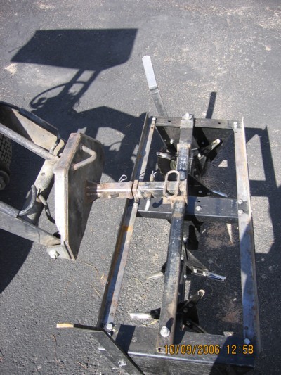

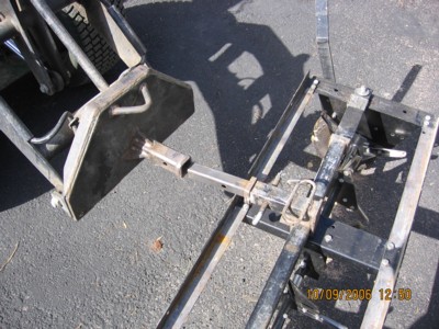

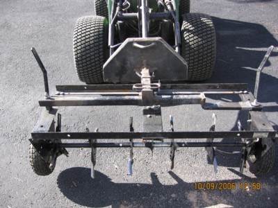

This is a modification of a pull type core aerator I purchased from a tractor supply store. I believe it was Runnings. I removed the original hitch from the core aerator. I trimmed and installed, upside down, the trailer hitch from my Nissan Maxima. I drilled a few new holes added a couple of spacers to install the hitch to the core aerator. I use a 1 1/4 square pipe to connect the core aerator hitch to my PT hitch plate. I modified it a couple years ago but just recently took pictures.
The core aerator works well in float. You must drive straight with the core aerator in float. The assembly does not like to turn while aeratoring.
Dale

Looks good. Thanks for the pictures. This would be a good choice for me. Is the unit holding up well? I want to get a good quality unit. There seems to be a large range of quality in the units from various companies.

It is not a heavy-duty unit. But, it works better with the PT than pulling it behind because I lift it while turning. The coring knives are replaceable. It works well for my two-acre lawn.
Dale

Dale, is this unit still working OK for you. I would like to modify mine, but want to make sure this does not abuse the unit.
   / Least used attachment #29
I have a very similar unit from AgrFab. I think it will attempt to skid when you turn the unit. With the articulation of the PT, if the knives are in the soil and you are standing still, if you crank the steering wheel, something is going to give immediately. It will either be the soil or the unit. I see big gouges in your soil future or bent aerator parts, or both.
Dale put his on the front of the PT and lifts at turns. My concern is having the aerator carry the weight of the arms.
