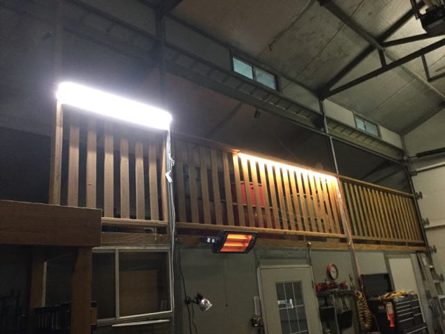

This is a really good price but, I think that the 4100 K color temperature will be a bit too "yellow" for shop lights?
Any feedback from someone who installed some of them?
Light on left is Sam's Club which is 5000K and light on left is 3000K.
Big difference?
   / LED Garage Lights #129
Big difference?
Nope! I put Costco 6 qty of 4ft fixtures (2 bulbs each) with 4100K in my garage/shop and they are a nice clean white. Not yellow at all.
