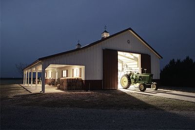

A month ago, I attempt to replace the garage lights with LED because the brightness falls to 30% of metal halide lamps.
I am still testing the performance of this ceiling lamps for garage. I am expecting decrease in electricity cost and brightness increase. this product is also appearing at amazon, but I directly buy from manufacturer and thus the cost is lower. the installation is quite easy. since the weight of the luminary is not very heavy, i can DIY the installation.
The garage flood lamp is quite impressive. But my tractor garage has a very high ceiling of 10 meters. Perhaps a need a high power led lights.
