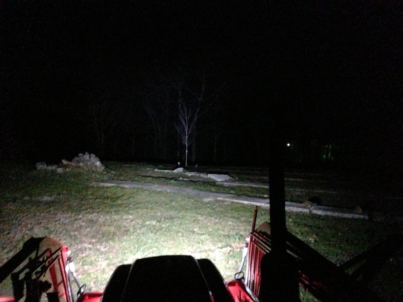

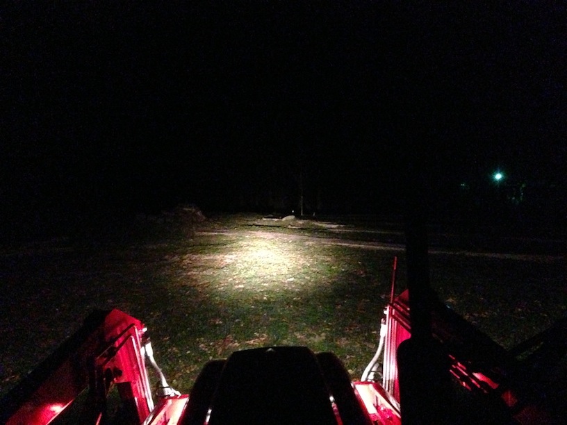

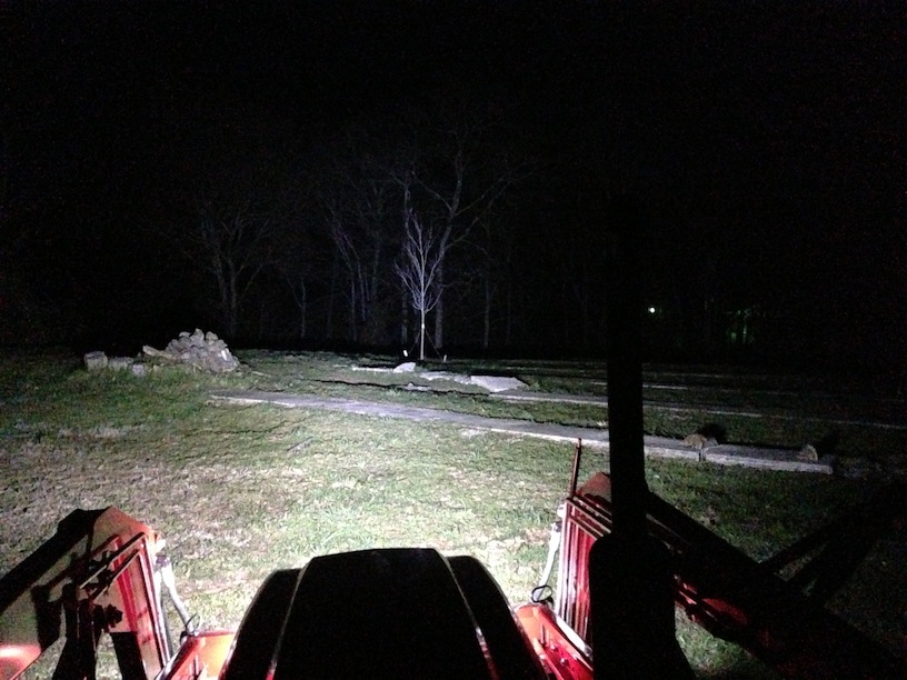

Hi 284 International, here is a before and after shot of just the headlights.
BEFORE (OEM High Beams)
AFTER
(LED High Beams)
(LED Low Beams)
   / LED headlights and light bar for YM2620D - pics and summary #25
Very nice!!
   / LED headlights and light bar for YM2620D - pics and summary #26
Wow, that looks to provide ample lighting even with the headlights only. With the light bar on too I imagine it would be even better. Thank you for the photos. I need to start doing some scheming and pondering on what steps I will take.
