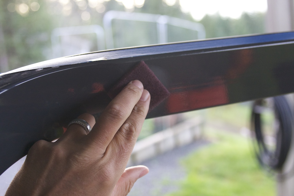

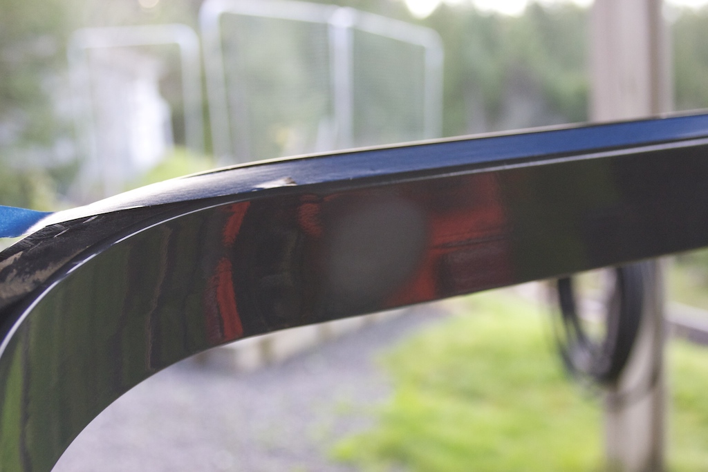

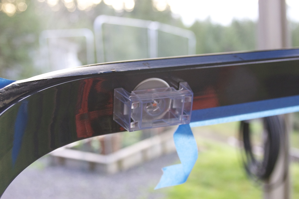

Most important in adhesive bonding, you must understand the materials and finishes that you are bonding and select the proper adhesive. Environmental conditions such as temperature, vibration, contact with various fluids, etc. are important in selecting the adhesive. I used a fast curing two part modified epoxy/acrylic blend. It has the quick cure of methacrylate with the toughness of an epoxy. Clean surfaces are paramount. Removing any oxidation, mold release, dirt, grease, oils is a must for a structural bond. Scuffing and solvent wipe to clean.

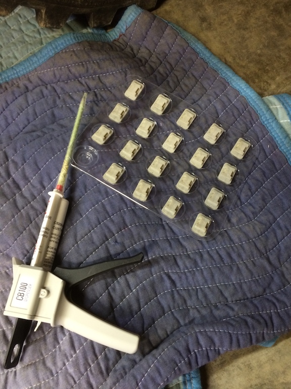

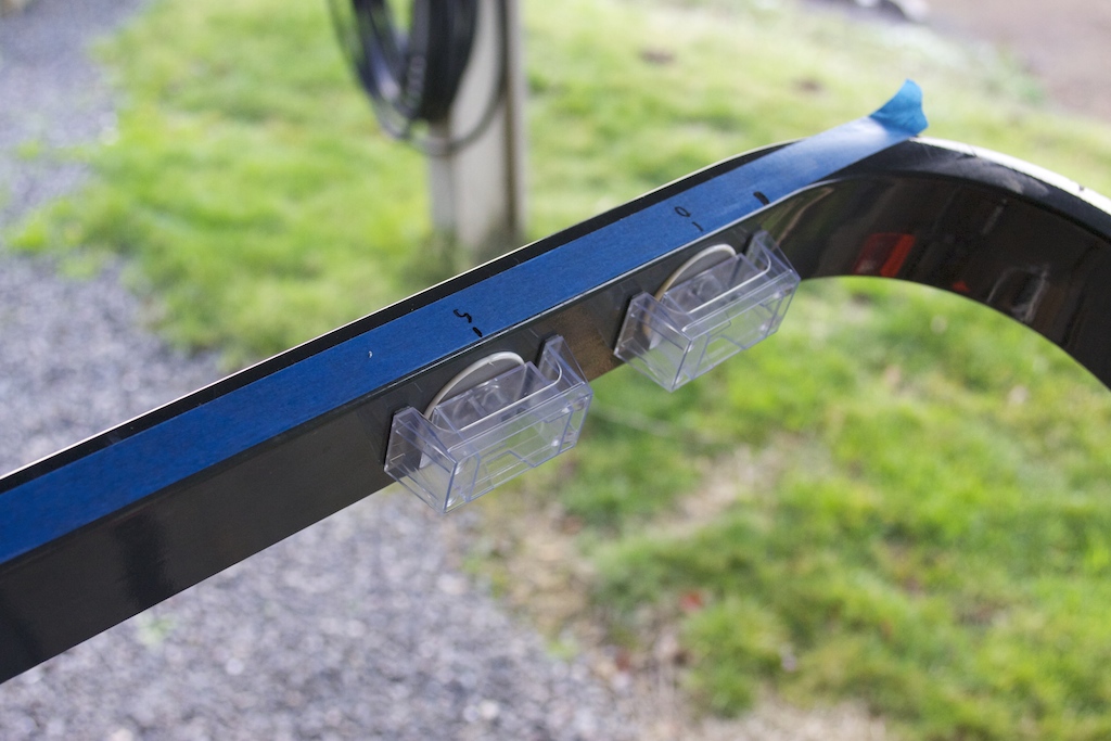

Then the handy dandy Click Bond parts... these are installed with self fixturing pressure application fixtures (PAFs).
View attachment 351150 View attachment 351149
View attachment 351151 View attachment 351152

These fixtures are temporary holding devices. Like a spring loaded clamp. Almost all adhesives cure as a result of an exothermic process. Okay maybe starting to dive too deep here but simply put the adhesive tends to shrink as it cures. The CB fixture continues to apply pressure during the cure so a thin and controlled bond line thickness is achieved thus preventing any air/moisture to penetrate the join. This means no corrosion will migrate under the bond thus resulting in a lifetime connection.

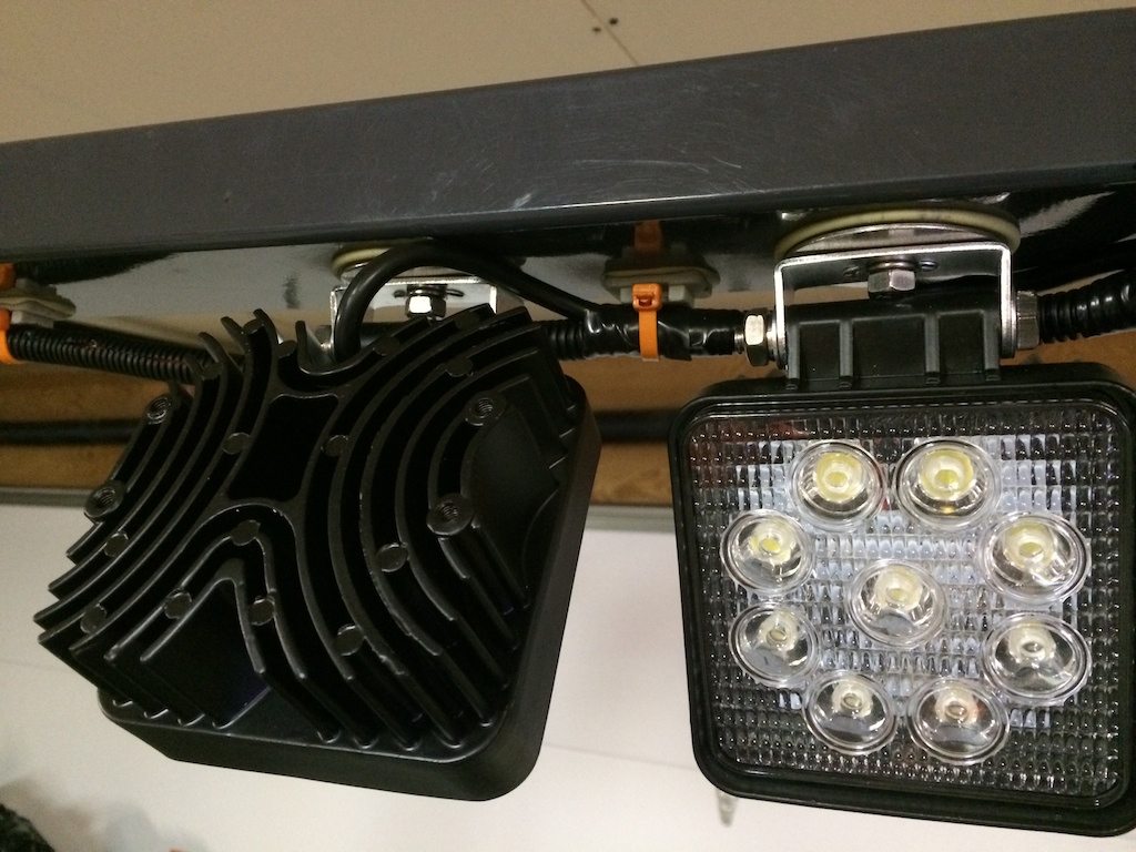

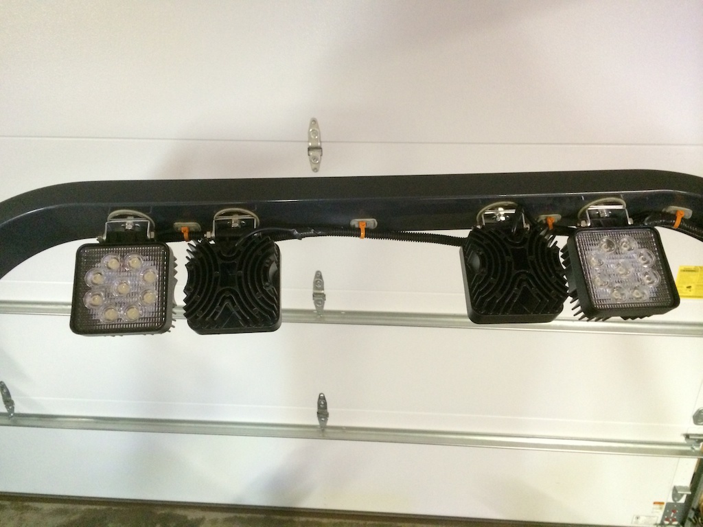

So... the lights are mounted. No holes and I could probably hang on them. Well I guess I would surely bend the mounting bracket. Nice thing is I can angle and swivel the lights 180deg. The one concern I had about mounting these overhead and under the ROPS was head clearance. I have to admit here that for short jobs, I have a bad habit of occasionally working the BH on my knees without swiveling the seat around. So, my head does fit between them but barely.

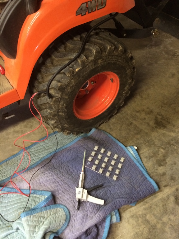

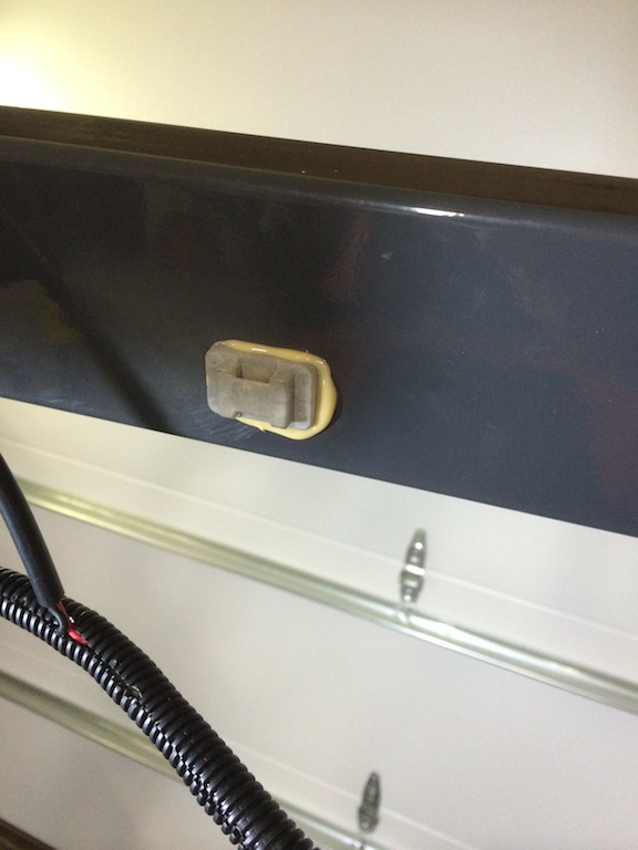

Next, the wiring down the ROPS, under the fender and deck. Again, I didn't want to damage the ROPS so I used some composite cable tie mounts. Now these are not the sticky backs that people are familiar with... these are glass filled thermoplastic mounts that are capable of about 100lbs or more. These guys mount a little differently than the studs. They have an internal fixture that 'sucks' down the mount during cure. Sorry no picture of the clever mechanism (maybe later). Trick here is to have your route figured out and clean the locations prior. Then using the adhesive dispenser, you can quickly apply the 'glue' (we say structural adhesive) and install all of the parts in an efficient manner. The adhesive cures quickly so it is important to plan out and stage the work to keep the adhesive flowing. No smoke breaks here unless you want to replace the mixing tip (no big deal though).
