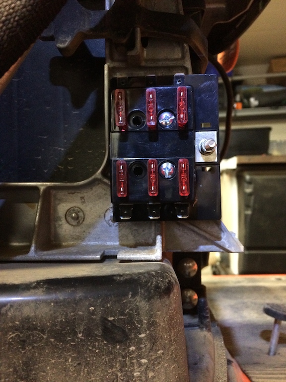

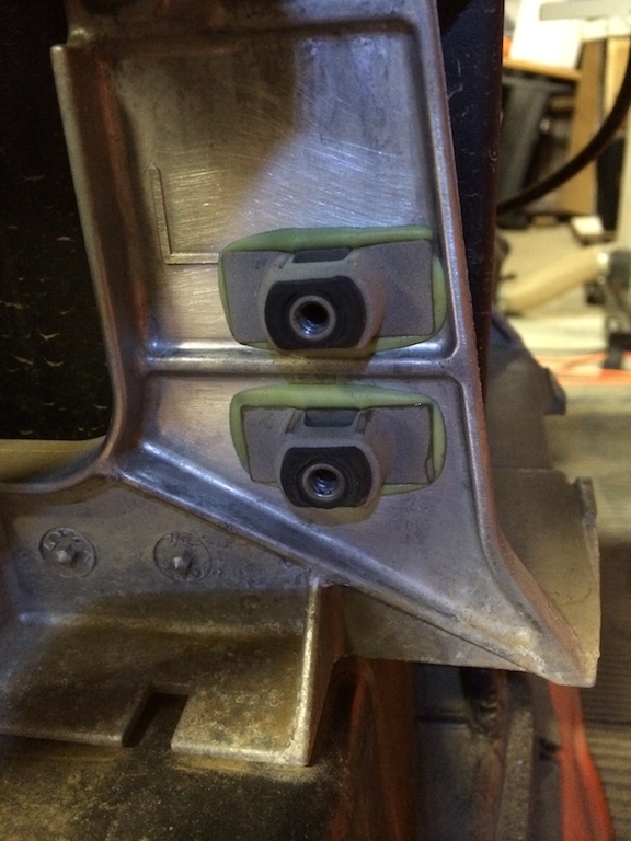

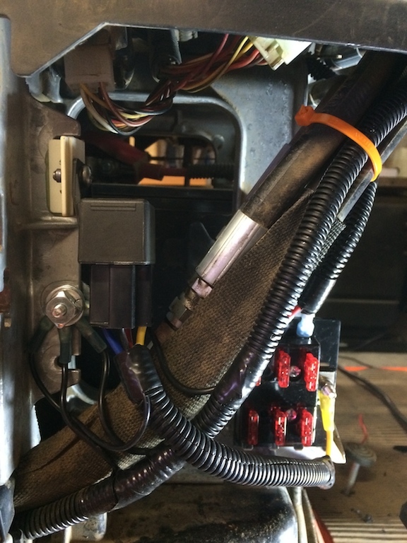

Next to mount the brains of the system. Again thanks to 4shorts for some prudent electrical guidance here. This is also where I took the liberty to overkill the project a bit but since I had the parts... what the heck. I mounted an auxiliary fuse panel and relay also using some CB parts. For the fuse panel I used some vibration dampened standoffs.

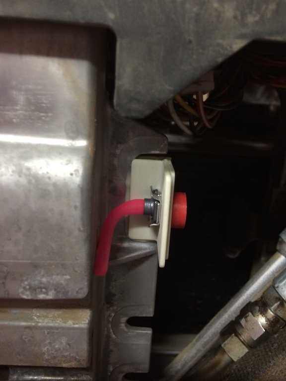

For the relay I used a 'PinchMount' fastener. Another clever little part that 'pinches' the flange of the structure and accepts a screw.

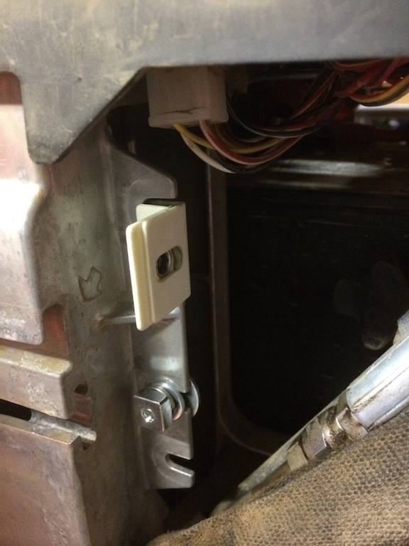

Again... no holes so far. I used the slot on the frame with a bolt/nut and mounted all of the 'ground' leads. See also second pic in last post.

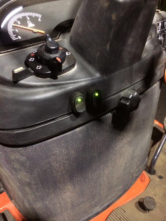

Next step was where I ended up deviating from the 'no hole' plan. I just couldn't come up with a slick way to mount the lighted switches that was ergonomic, looked good, etc. so I did drill two holes in the plastic dash and easily mounted the switches. Sorry pic quality not good but in person it looks 'stock'. Two switches, one for the fronts and one for the rears.

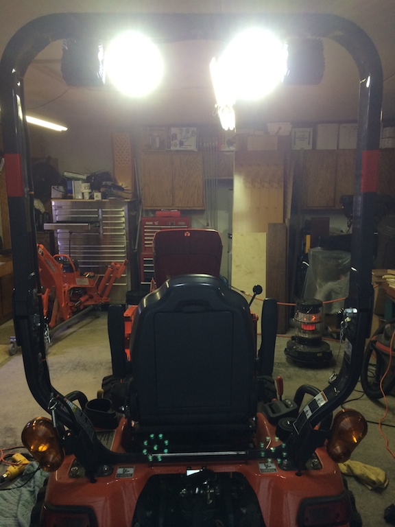

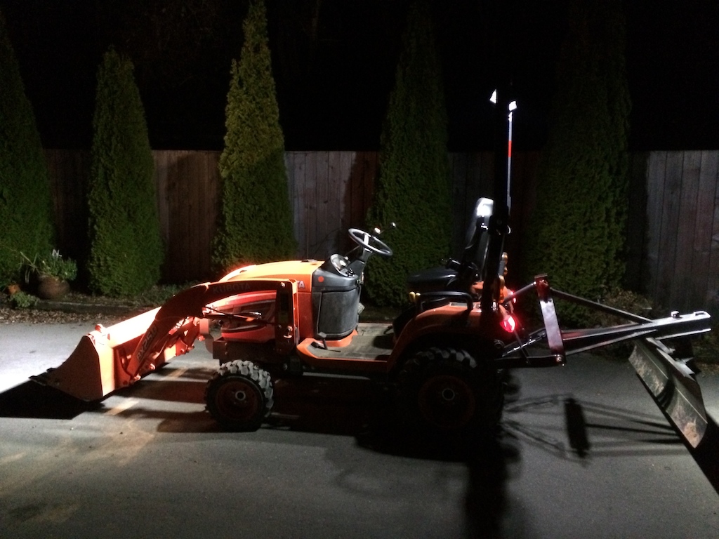

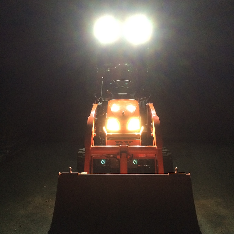

The last step was to tie into the ignition switch so the lights would need a key. It was bit of a struggle but once done I can't believe I spent so much time screwing around. Really pretty simple once I got the ignition switch pulled so I could access a switched wire. Then I pulled the trigger and wallah!!! Let there be light!
Amazing the amount of white light at such a low wattage (and minimal battery drain)! They completely overpower the stock hood lights and now I have both front and rear lights. Best part of it all I got room on the aux fuse panel and dash for more circuits and switches... :cool2:
