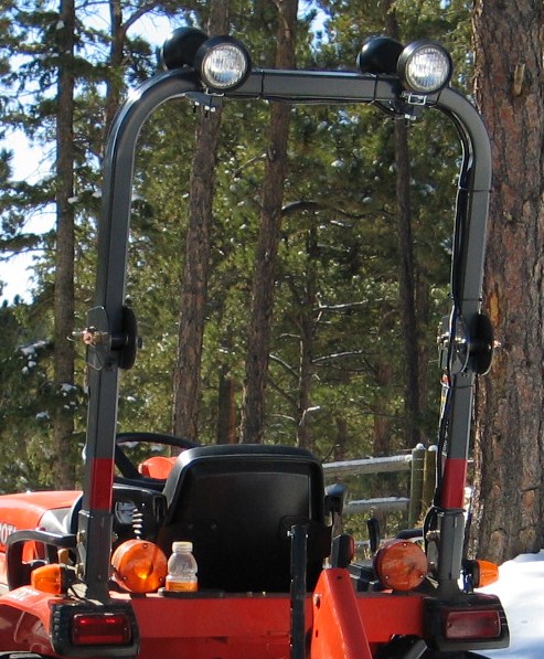

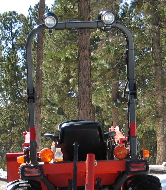

I like it that you put plugs in the end of your square tubing light mounts, and added caps over the exposed threaded portion of your U-bolts. Now all you have to do to complete it is put the exposed wires inside some 1/4" corrugated wire loom to make it look snazzy.
   / led lights tying into factory lights? Kubota L4330 #22
Bandit:
Being that the tractor was pretty new when I did the lights, I didn't want to drill the ROPS to feed the wires down inside the ROPS. So I wire loomed the wires and zip tied the wire looms to the ROPS. Four years later, the lights are still working great, and the wires have been protected from tree branches, held up to snow clearing during blizzards that soaked me through my supposed Gortex outerwear, etc. The bolt caps were to keep my noggin protected when climbing on and off the backhoe.
Here are a couple pics showing the wire looms running down the ROPS.
