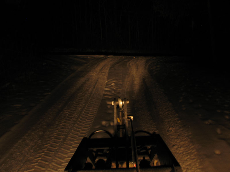

I finally got around to installing my LED work lights. I am quite pleased with how they work.
PT1850 LED Lights
Here's a couple of pictures showing the difference:

They are 18 Watts each so pull 1.5 Amps each.
Besides the added lumens, the CRI is pretty good which improves what you can see with each lumen. I really am very pleased with them. I have a third one - thinking of mounting to the back of the Fops facing the rear but i might replace the existing one instead. I will do a temporary install on the FOPS and see what i think. With the fops mounted to the front of the tractor, the articulation meand the light could easilb be facing the wrong way but it might have enough spread.
By the way, i double nutted the lights tight enough that tey stay put but i can rotatet and angle them to point where i need then to.

I have my additional rears on the FOPS. I run both chasis and FOPS when rears are activated. Didn't find that the amount of light really improved much by keeping the lights low on the chasis. Better results for me up high.
/ LED Lights
That's why i wanted to try up high - seems like the better dispersion is worth that the center is not always pointed where you wish.

Plowed tonight with the LED lights. Actually nicer than daylight because there was no glare. They light up in front of you better than the pictures show. I am REALLY pleased with them.
Ken

These lamps still work fine. Now they have the 27 watt ones for less money on Ebay. I bought some for about $25 each.

Since the actual LEDS need to run at tight voltage, and current specs, I can easily imagine that poorly regulated supplies will blow the voltage control circuit.
I lost two compact fluorescent bulbs recently when the 110V power dropped to 70V for a few hours.
The LEDS are working fine for me.

I think this is correct. If your machine has a true alternator, you should be okay with the LEDs. If your machine charges from a magneto, the LEDs will burn out in a few hours. I put LEDs in last year, and I burned out several different types. I went back to halogen lights.
/ LED Lights #20
I also just received 2 27watt lamps that I purchased from amazon. They are so bright, I just installed one lamp unit on the rops facing forward and I think it is more than enough for my needs. I will probably install another one facing the back on the rops as well - just in case I have to work on the engine compartment and to see the rear side quarters.
