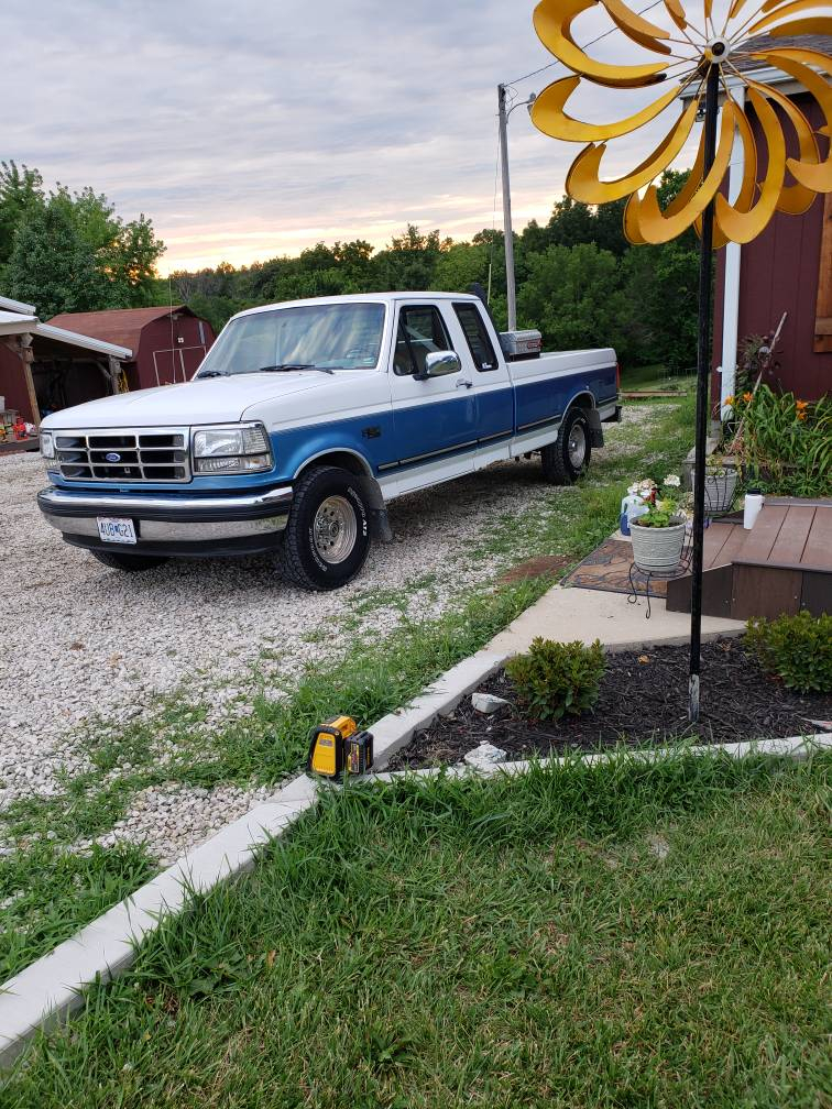

Got a1992 f-150 Changed to clear head lights with led bulbs. Will not be going back to stock ones. You can see so much more including wild life trying to cross the road View attachment 763030
Yeah and run folks off in the ditch that meet you at night.
