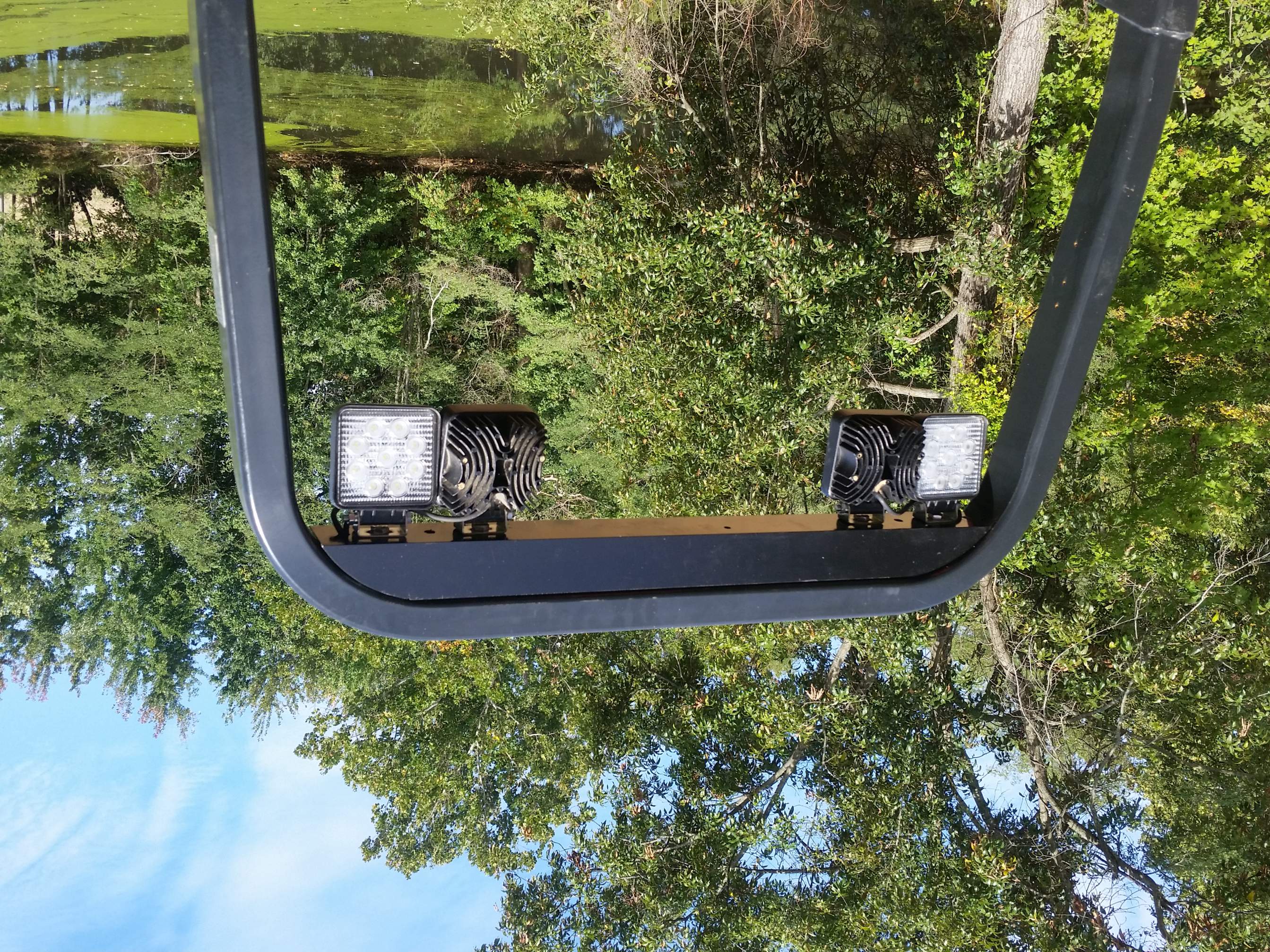

I just installed 3/27 watt led lights on my ck2510. I found a bullet connector on the inside rear fender on the left side. Had power when the key was turned anywhere past the accessory point on the ignition. Found it was on the 10amp horn fuse. I tied into this plug and powered the switch for all three lights. So far so good?

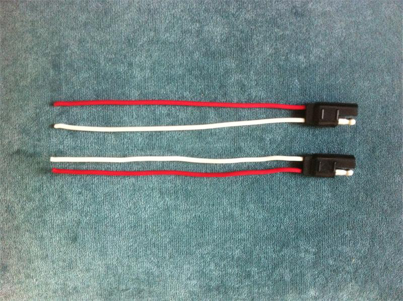

Does anyone know where the matching female connector for the customer use plug can be purchased? Thanks
Should be a common electrical accessory that you crimp on to the end of a wire. Probably several sizes so match it to yours. I just cut the connectors off and used wire caps and electrical tape, works fine for me.
   / LED Work Lights on ROPS - Info and Wiring Questions #19
This type connector?? Not sure what comes on your Kioti?
