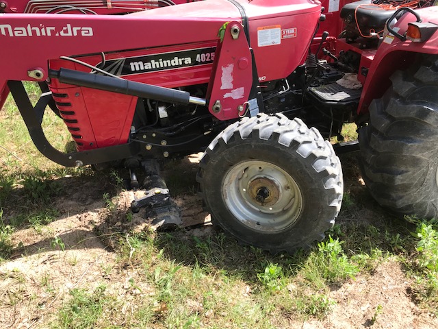

1. wheel drive still buried in dirt where it came to a stop. Left wheel with splined axle sticking toward us.
2. closer view of wheel.
3. closer view of wheel drive skidded into the dirt and the loose wheel next to it.

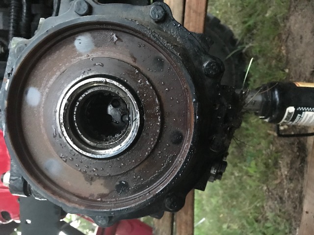

4. jacked up the wheel drive. Looking down into the wheel drive. You can see the three sheered bolts down inside the female splined drive mech.

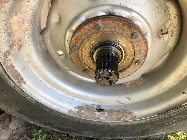

5. close up of spllned axle and the three sheered bolt ends still stuck in the shaft.
You can see the edges of the blunt end of the splined axle is buggered up some. Obviously damaged a little because as the axle walked out, at the end it was barely in the drive when the whole weight of the tractor caused it to pop out.
I understand that this triple bolt method has been redesigned to entail a single center bolt of larger diameter. Not sure, but I think the dealer said they did the upgrade kit on this left wheel. On the right wheel, the bolts were loose....so a pending repeat of the disaster, but they said they tightened the bolts. (not sure I feel so permanent about that).
