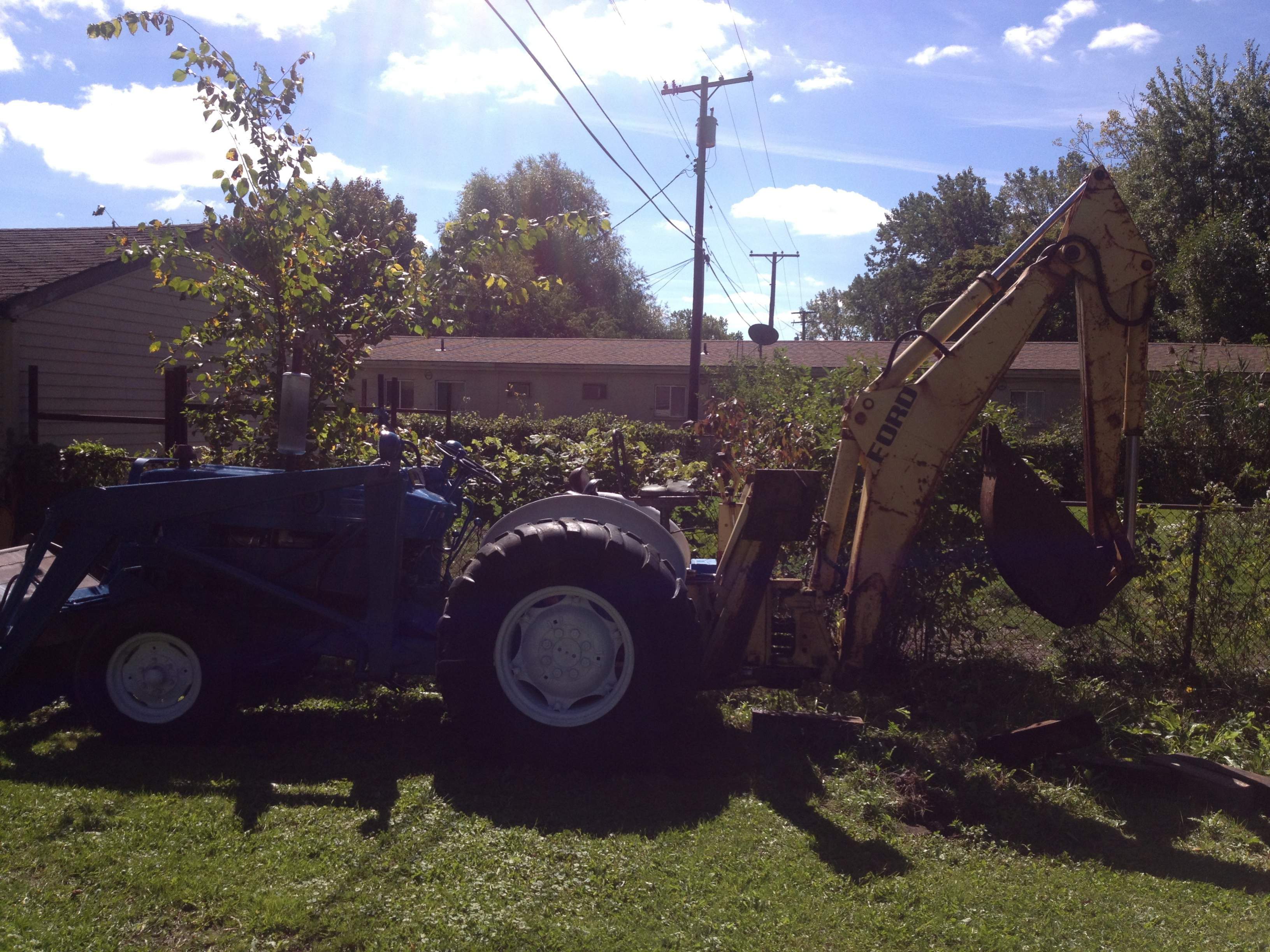

I swapped the carb from the 3000 to the 4400, running like a champ except for a little miss. I'll get to that later this week when I get install the new carb. I got the backhoe on while I wait for the new zenith to get here. I wasn't expecting it to be 24' long!
