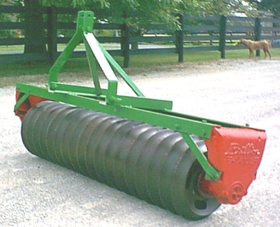

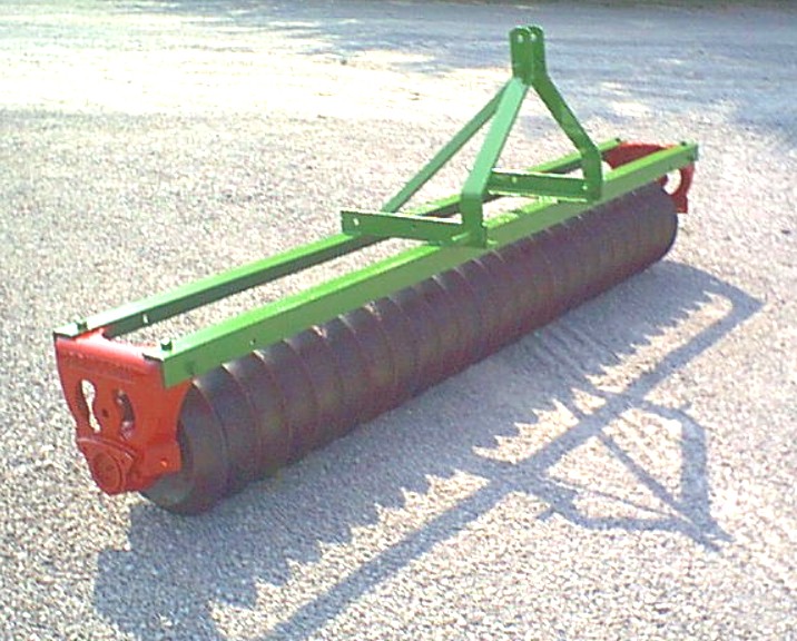

Here is a used rebuilt 6 ft Brillion with 3 point that we sell for $995 and a picture of a used rebuilt 8 ft Brillion with 3 point hitch that we sell for $995 + shipping. Each will weigh 1000 +. Ken Sweet

Ok, so both are 995? how much to ship to oklahoma, and if ordered monday how long to get here? Your 6 footer weighs 1000 pounds?

Could I get your zip for a accurare quote on shipping? PM me if you like or email sweet@scrtc.com Yes the 6 ft has 18 inch oversize rollers and the 8 ft has standard 15 inch rollers. When I get your zip, I can tell how long to get there. Ken Sweet
