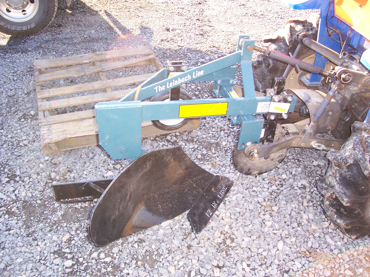

Here's a couple pics of the new plow I picked up yesterday. Seem's to be built very well. The depth wheel and coulter are optional.

Nice looking setup. You're all ready for spring!

Nice looking plow. To what machine do you have that attached? What do you have to do to get it set right. Any pics of the garden?
/ Leinbach model 19-12 plow
It's hooked to a New Holland TC18. To set it right you have to have the front and rear wheels lined up. The distance between the rear wheel and center of the plow has to be set for the size of the mold board, (12"). The lift arms need to be level with each other. Once I make the first pass I adjust the top link so the plow frame runs level to the ground. It doesn't take long to set it up. I didn't take any pics of the garden now I've already tilled it sorry.
