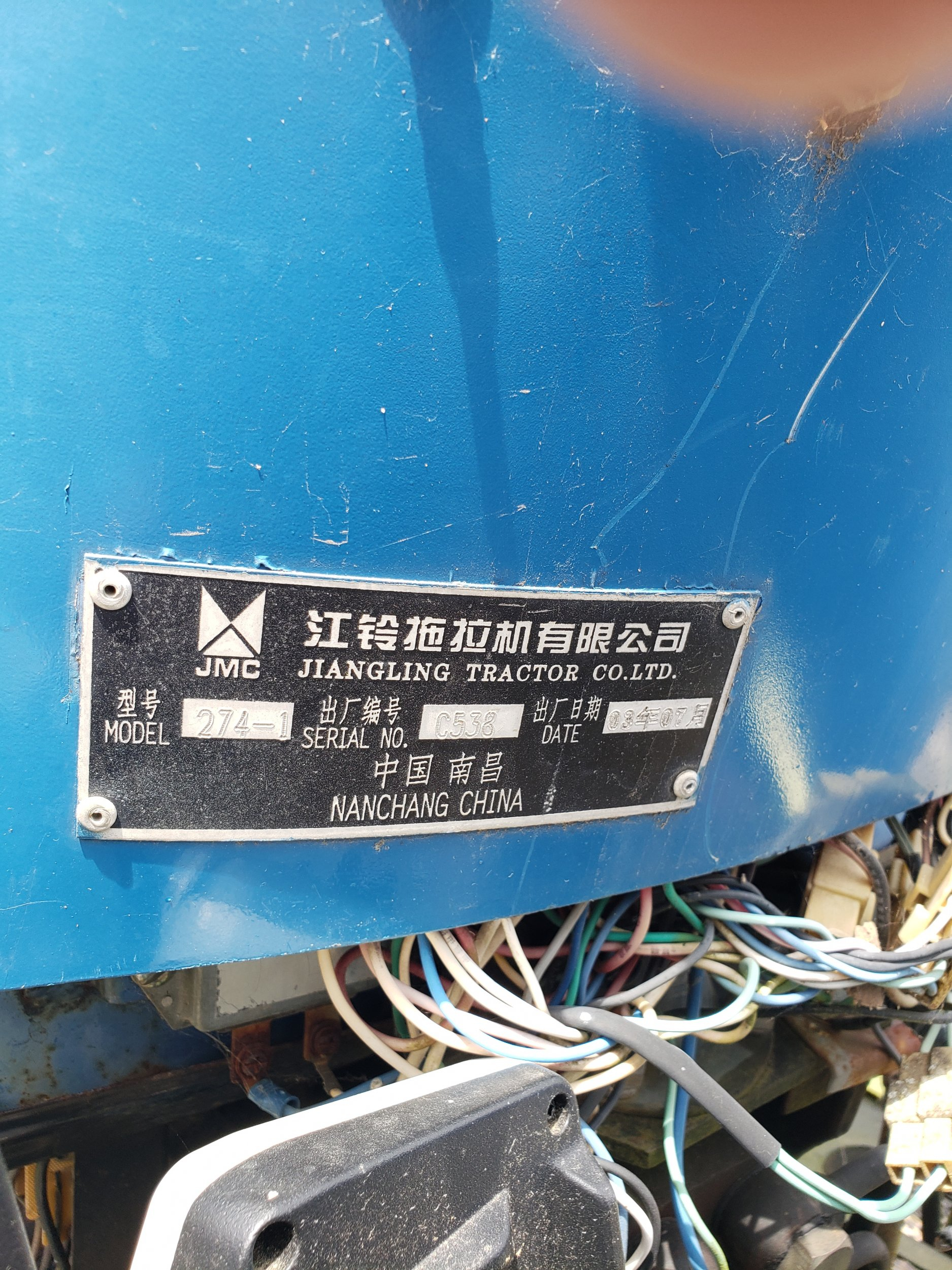

Lenar 274-1
Has anyone had experience removing the starter on the lenar 274-1 without having to pull the hydraulic pump? Any secret sauce or sequencing would be greatly appreciated.

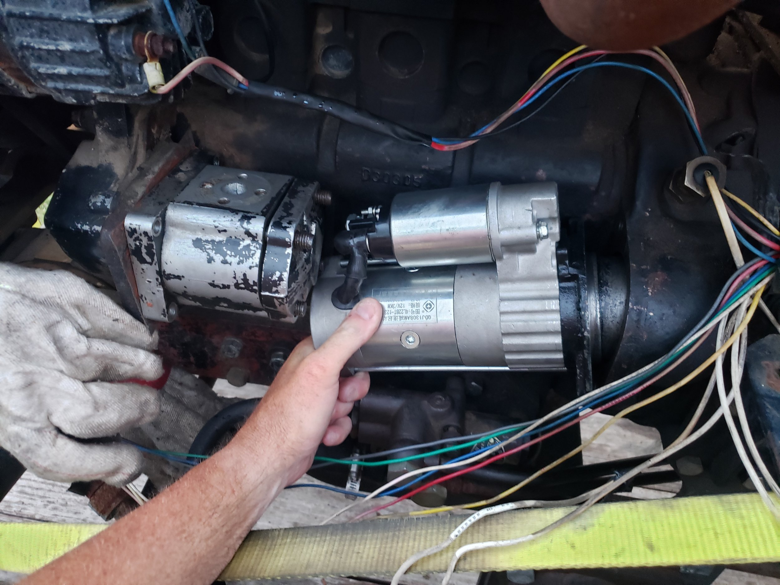

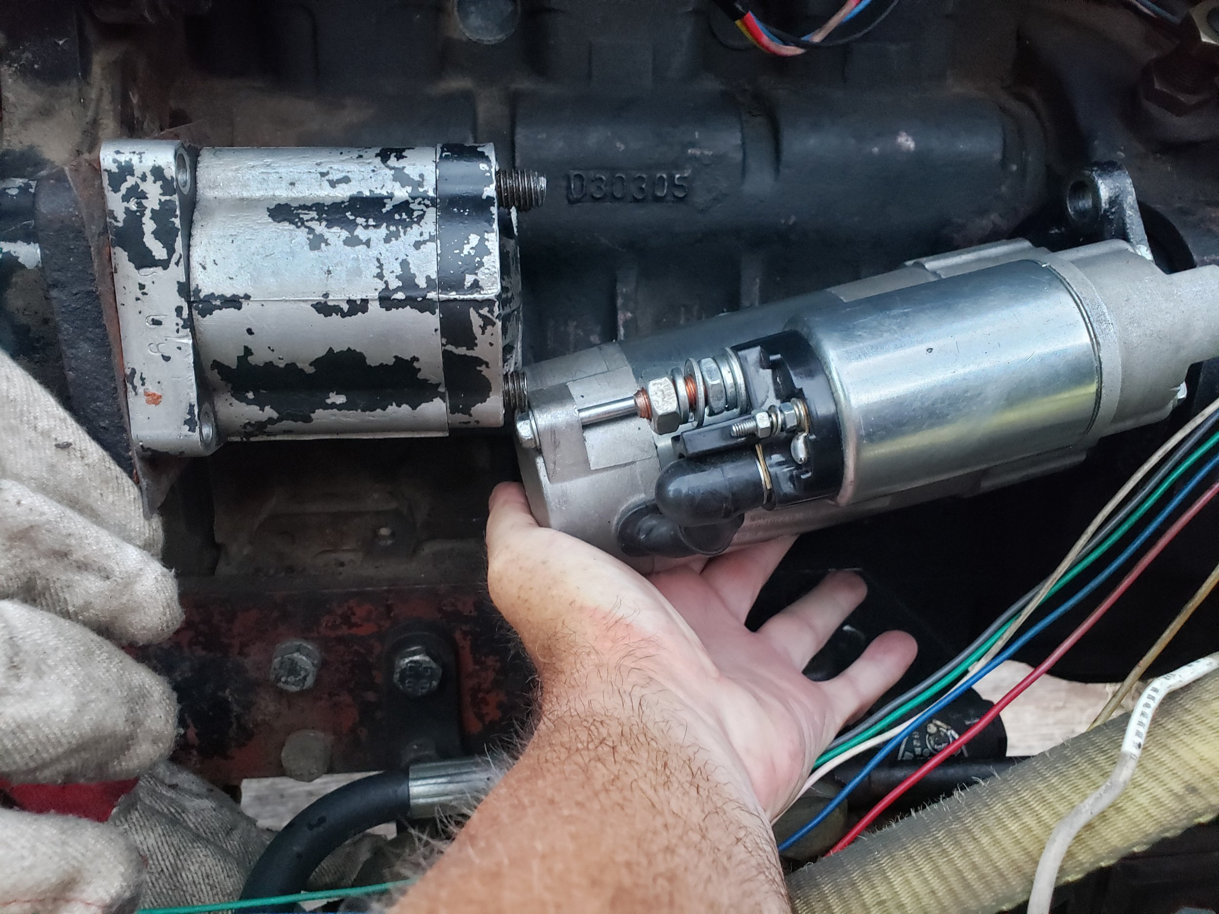

Trying again to see if anyone has any secret. I took the hydraulic pump out and that didn't help either. I can get within 1/8 inch putting the starter and hydraulic pump back in and that is as far as I can get without doing something likely destructive. Any ideas? Is there a hydraulic pump that might be slightly smaller that makes this come together better. Is there a way I am not seeing to stage the pump partially and then pump starter in? These two oppose each other too close to get them in and I still don't have a clue. About to hire a tech but heck it likely might take them forever and still not get this done. Any ideas would be mucho appreciated. I may just sell the tractor for parts and keep the loader for another tractor but was hoping to make this work. Thanks texan bill

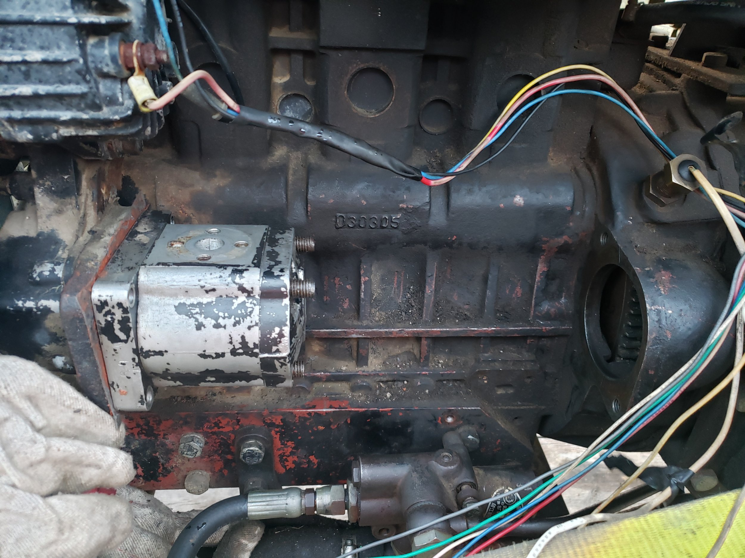

Took front flange off today and that didn't work either.

/ Lenar 274-1 Starter removal #7
I see a pic without the starter. Looks like you finally did it without taking the front of the engine off. o_O

Still have not figured out how to get the new starter in.
/ Lenar 274-1 Starter removal #10
What is the overall length of the new starter ?? Did you get it from us ?? We had some shorter ones, but I think we are out have some more leaving China soon.With the pump tight, you could prob. grind a 1/8" off the back pump plate to get it in
#11
thanks everyone for all your help. I was able to get it on by shaving/grinding 3/16 of the hydraulic pump rear. Now I find I must have a wiring issue since the starter doesn't do anything unless I use a charger. wish I had a wiring diagram. Bought this tractor with wires taken off and alittle rough.
