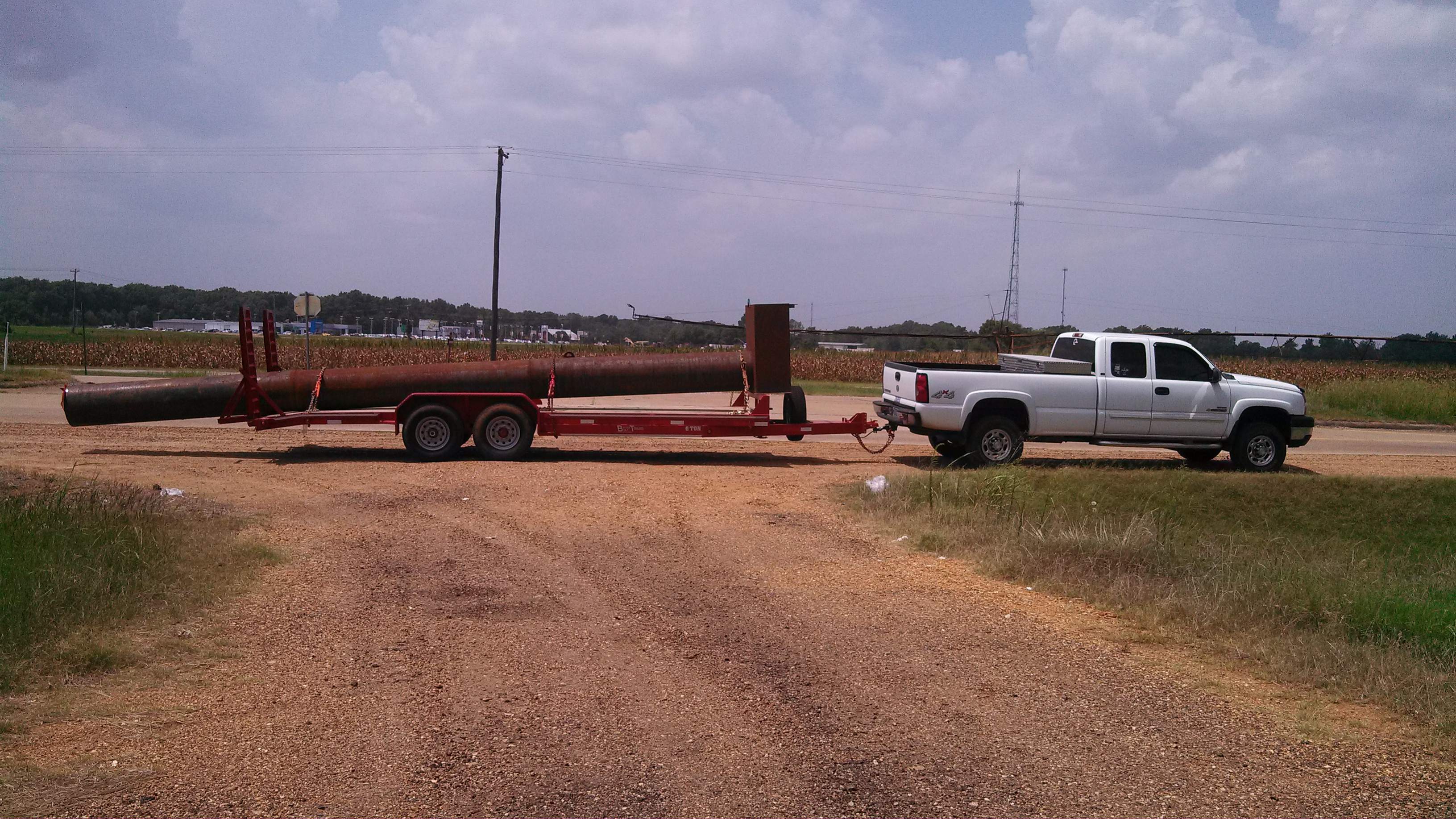

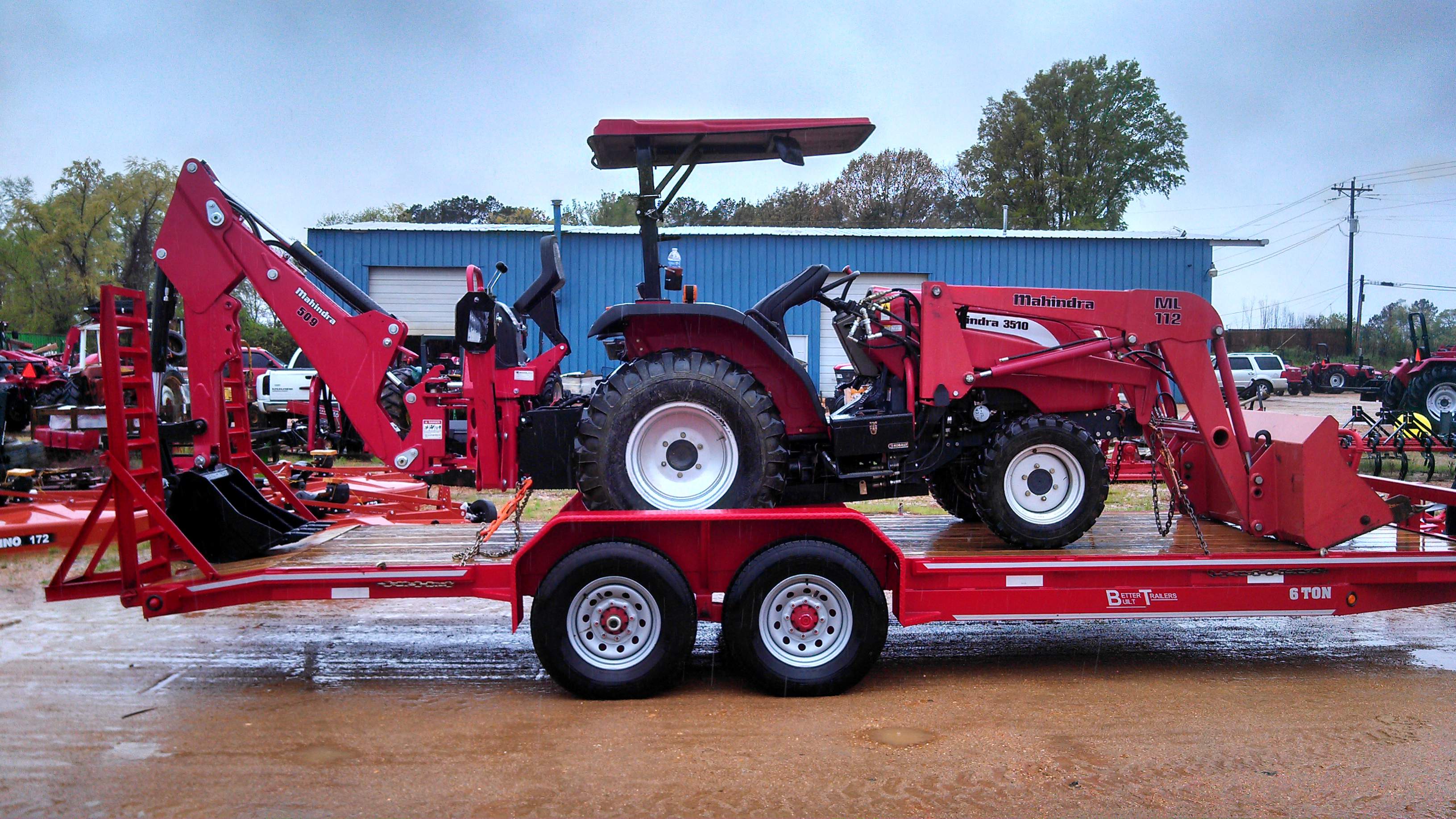

Mahindra 3510 with FEL and BH
Trailer is 20' + 2'. any shorter and the BH would hang off
The pipe is 33' long and weighs 3000#

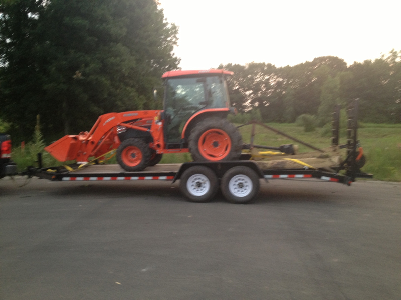

16+2 will be to short.
I have 18+2 for my L3540 (comparable to yours)
Indent know the length of a backhoe vs a 6' brush hog. However, with the hog, I have to lift the front bucket a tad over the front.

Thanks for all the recommendations. This is very helpful. 16+2 is definitely way too short, I'm hearing 20' may just do it, and 22' or more is best. I measured everything and I would just be able to fit on a 20' trailer, but it would only give a few inches to adjust the load if I needed to.
