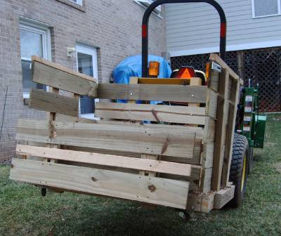

Thinking about getting a pallet and some bolt-on pallet forks (maybe get pallet forks with new tractor planned for this year). Put sides on the pallet. Use grounding straps at service station to put on each 5 gallon container on the pallet to ground to metal on the truck while fueling in bed of the truck. Use pallet forks to lift out of back of truck and carry to fence where generator is. Use 12v or hand pump to transfer from containers to diesel tank. LOTS less expensive than buying anything else.
Would just remove and redo the pallet on my carryall that I seldom use now since I don't have the big garden down below to haul mulch to. Picture attached.
Got a Terra pump on order from Lowes. Wasn't in yesterday. Not sure it has a long enough line to get from fence to generator. Also have a 12v oil extractor pump bought from Northern Tool.

I'm not sure that grounding is really needed for diesel (from a practical standpoint). For legal issues it may be necessary.
