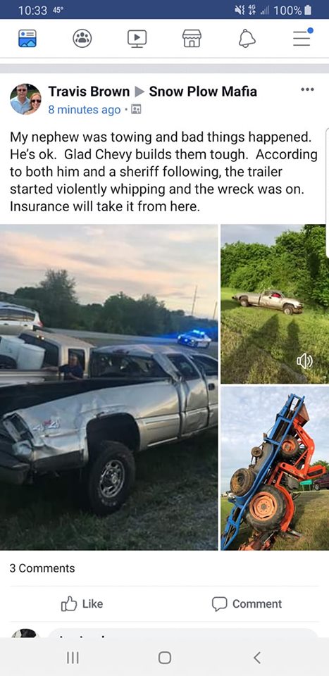

I think we could all take lessons from this guy on how to strap down a tractor. Don't know any details, just saw it on the internet.

Don't take lessons from this guy quite yet. Sounds and looks like he didn't have enough tongue weight. He strapped it down very well, but at the wrong spot on the trailer:
/ Lessons on strapping down a tractor #5
He tied it down very well and it looks like the ROPS held up. Lesson hopefully learned on proper trailer loading.

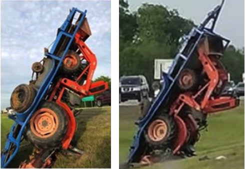

Anybody notice the difference in the two pics of the tractor&trailer?
1 tire showing on trailer
602875d1556714310-lessons-strapping-down-tractor-trailer-jpg
no tires on trailer
602872d1556712608-lessons-strapping-down-tractor-59211521_2419710624728591_4448401626805305344_n-jpg
Perhaps he had a blowout and it started whipping.

Look again rear tire is on trailer, badly bent rim it appears though.... Got to wonder if front tire and rim were ripped off lug bolts during incident or it was a case of stupid and towing without wheel and tire on front (yes seen it)...
Only difference in pictures is camera angle....

Those are different pictures, different cop car, different truck.

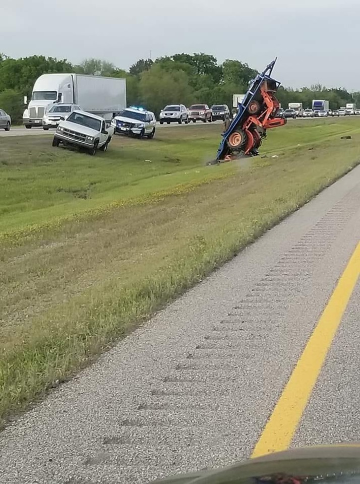

Multiple pictures from different angles. The white truck may be a witness. The silver truck appears to be off the road, down the embankment. Not unusual for two SO units to be on scene, one on each side of the center median.
Do we know where this happened?
