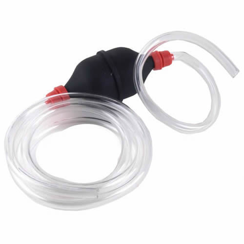

Before you say: "just siphon the gas out" try doing that. You do not want a snootful of gas in an emergency.....
Get yourself one of these tiny squeeze bulb siphons. They work great and no sucking fumes. However, some cars are difficult to get a siphon tube down into.

Siphoning gas from vehicle tanks gets more complicated when they have the blowback ball in the line.
Don't have to suck. Just put ones thumb over the end of the tube and pull up. Release the thumb and push down and repeat the process. Works well.

That's good info to know. Those little $3 bulbs work good too for small stuff.
Newer vehicles are a challenge
