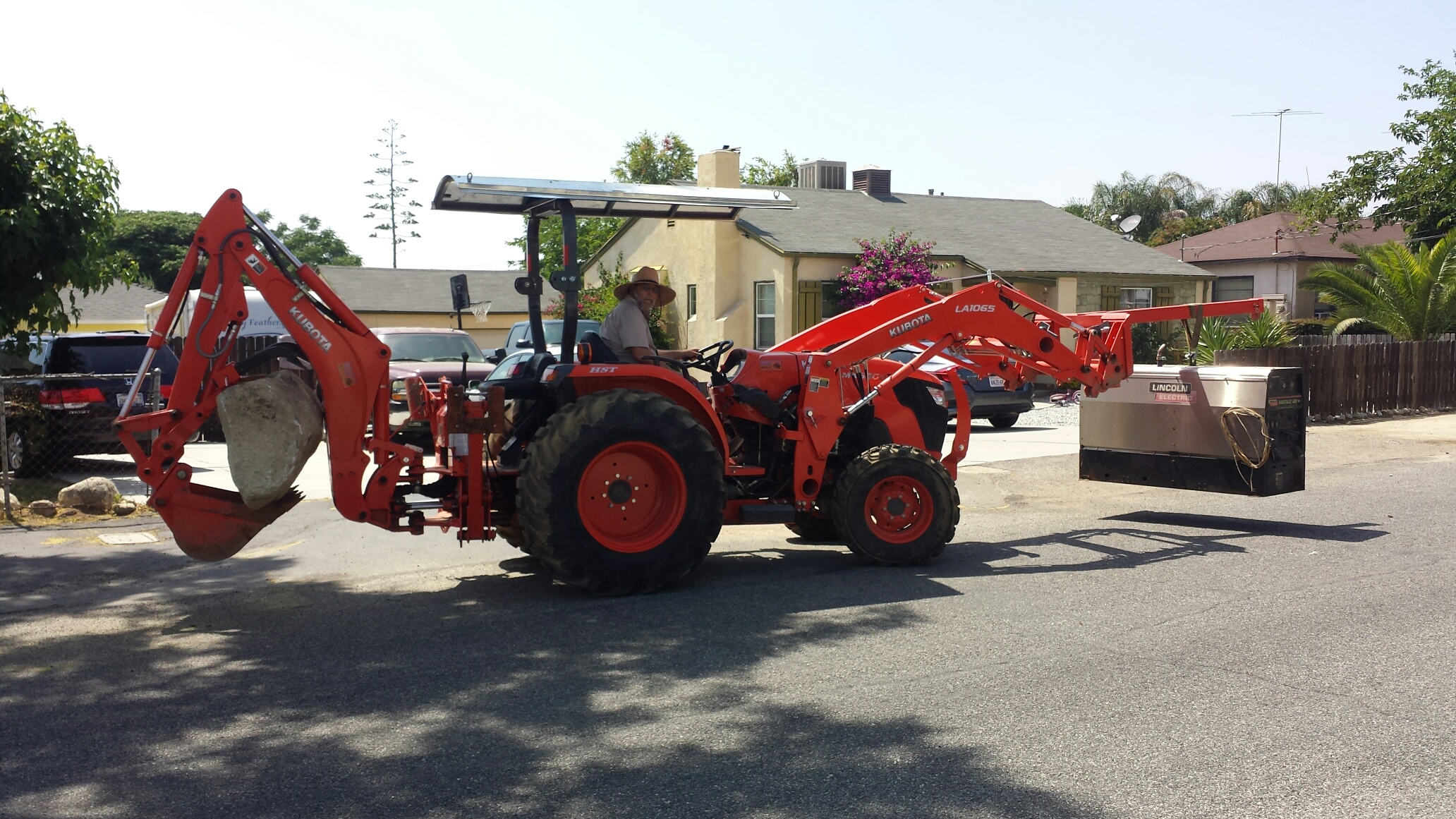

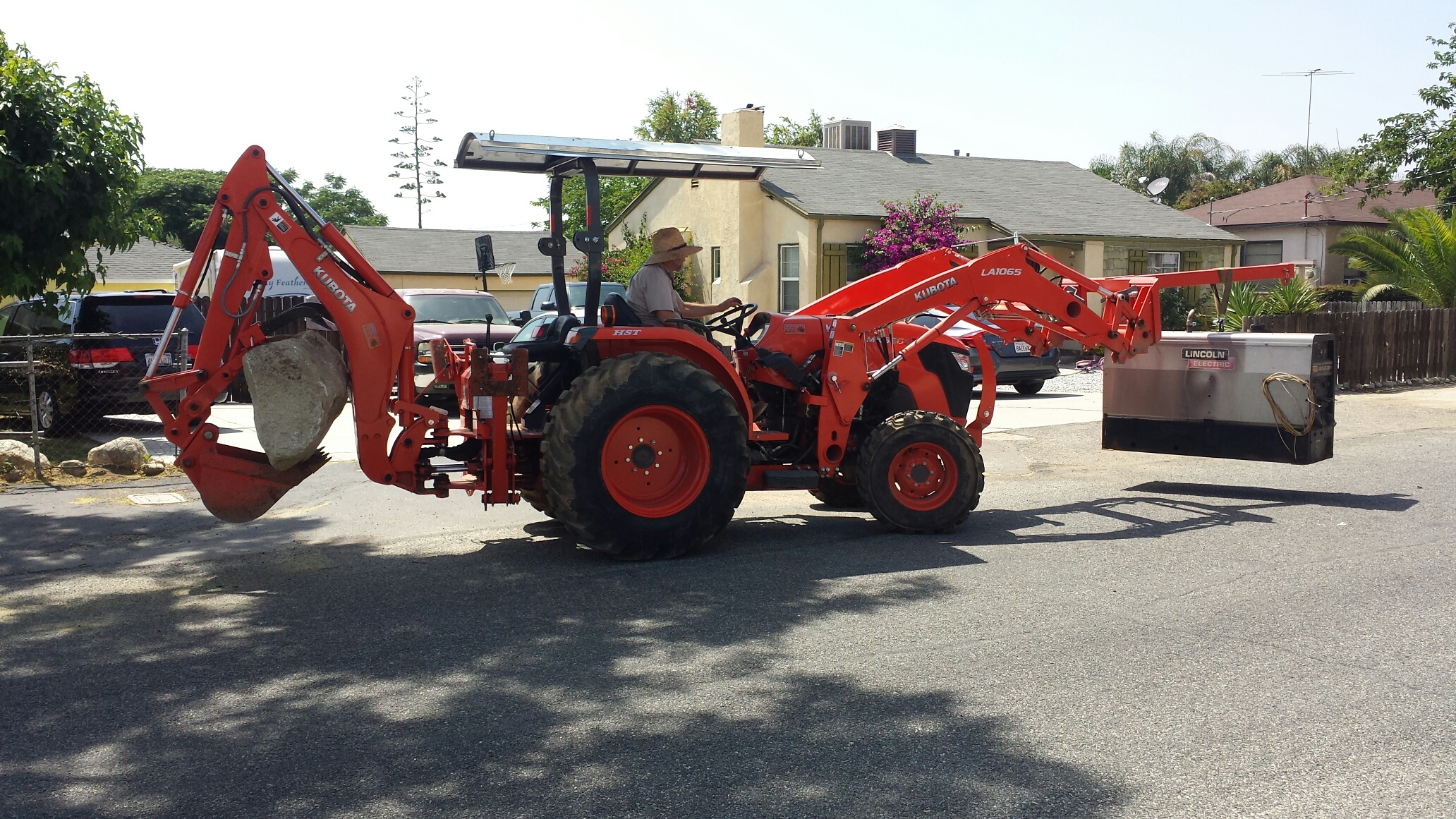

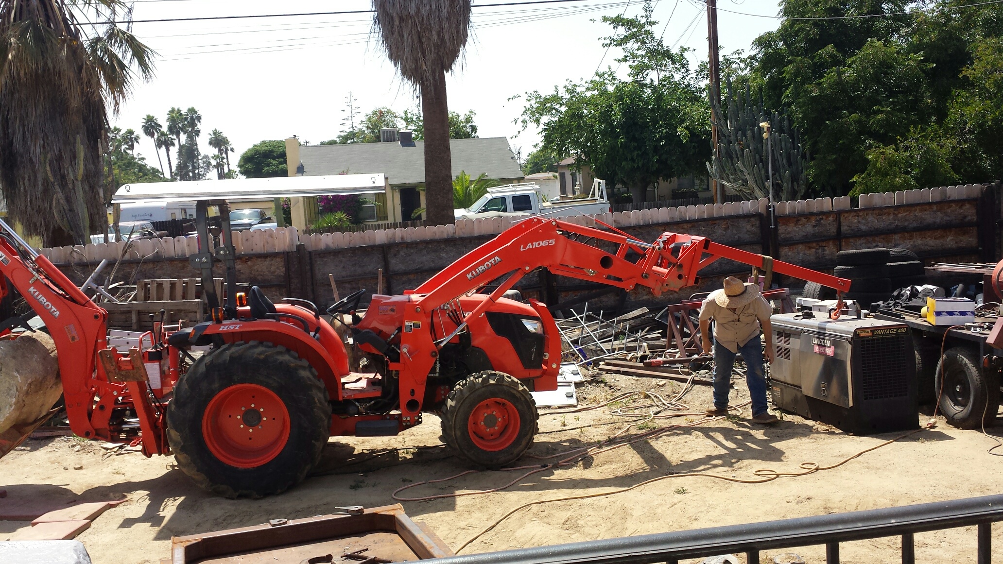

Here is a 12" bucket I modified into a Rock Bucket
I welded on (3) Carbide Bullet teeth to the back side of the bucket
(Not shown in this Pic is the Rock teeth I changed out on the front of the Bucket

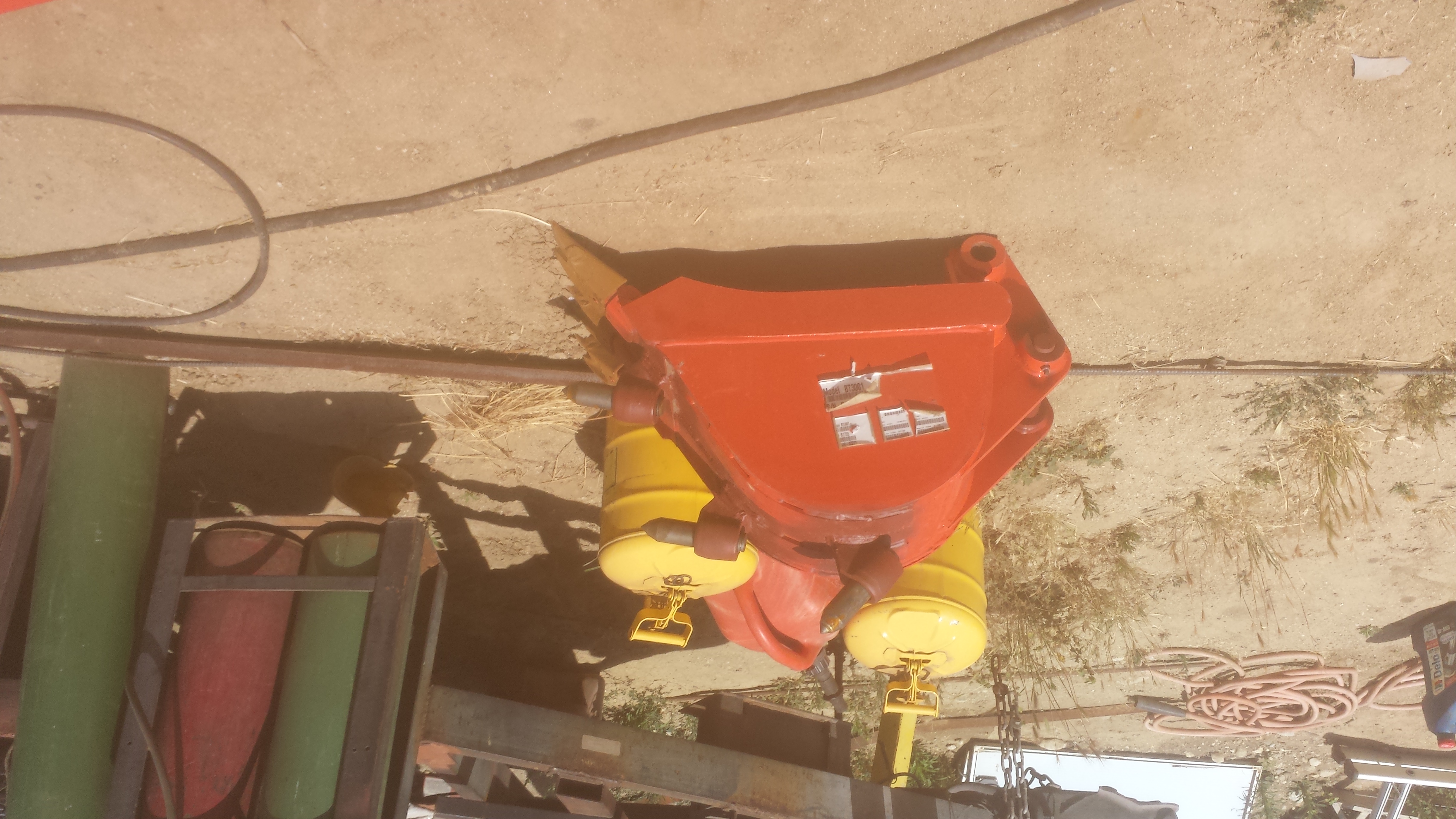

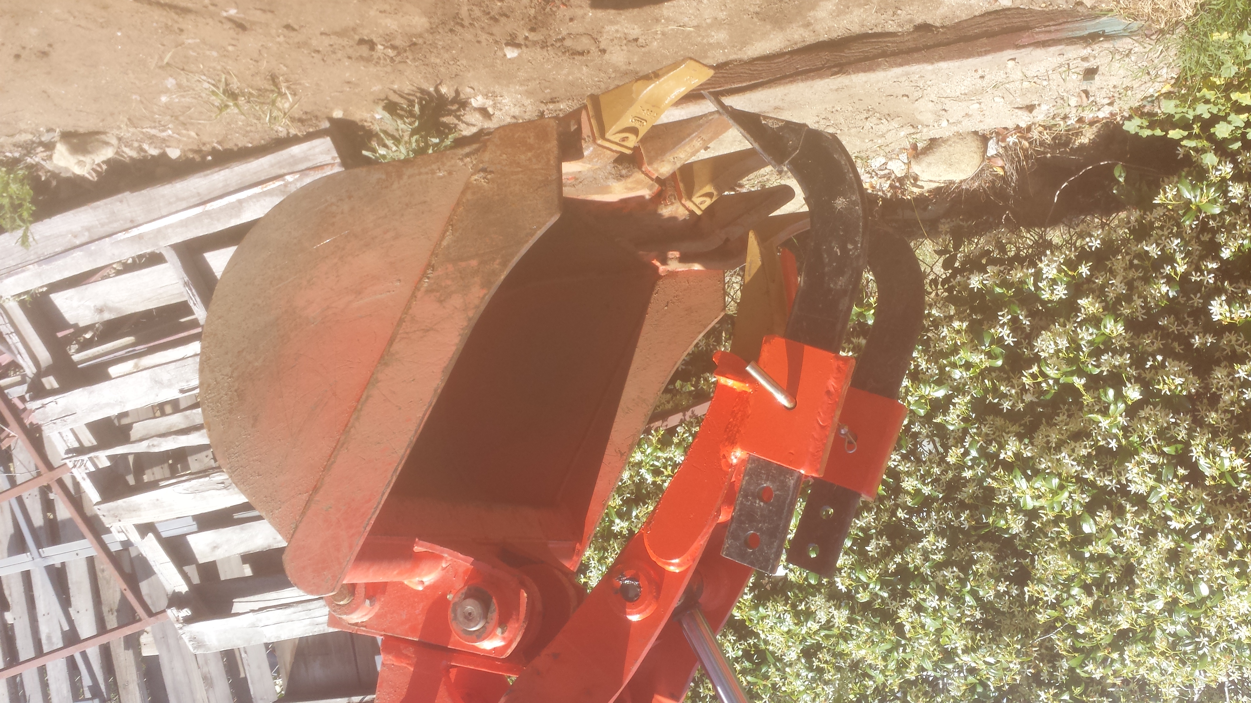

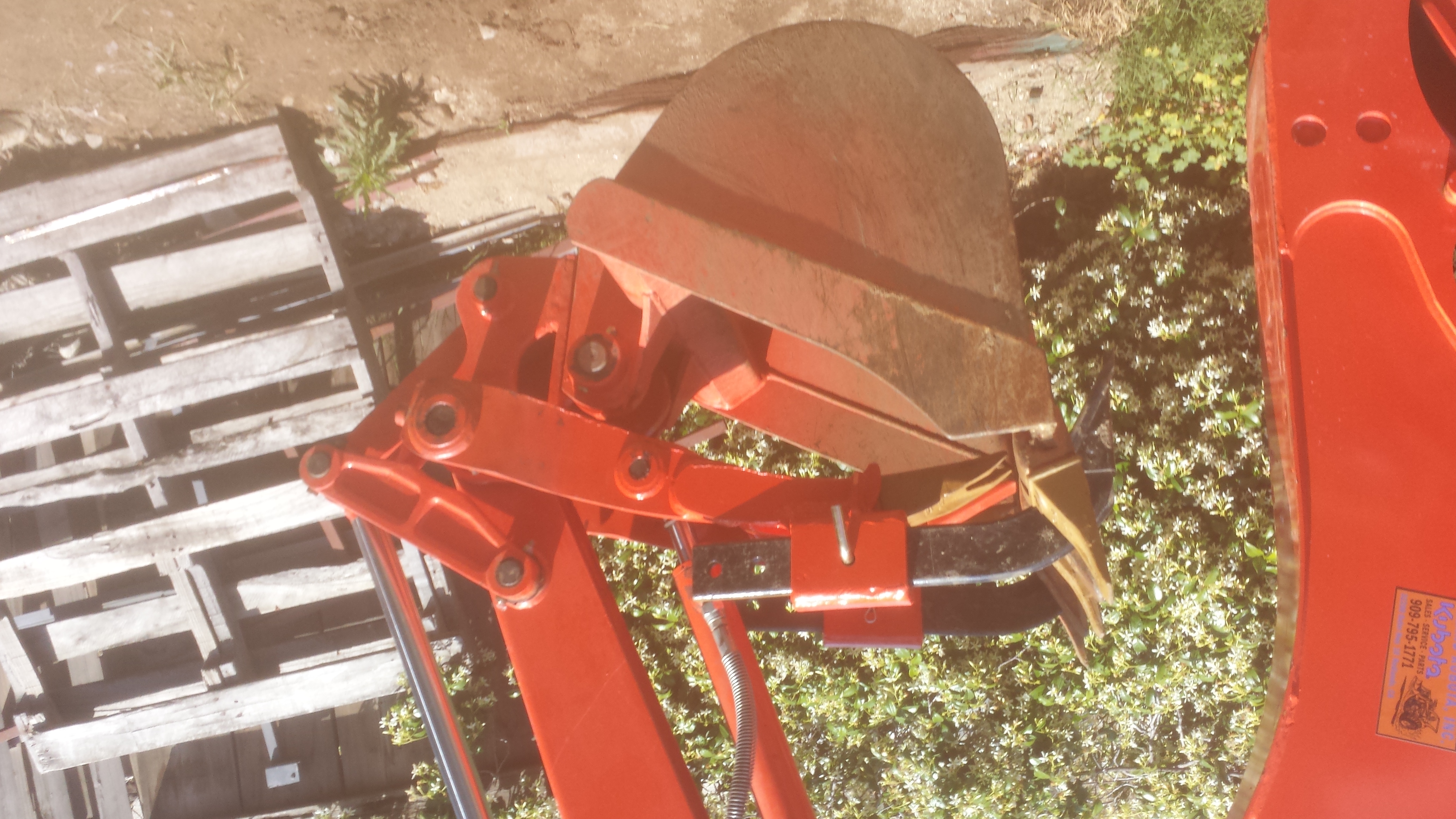

This is my altered thumb
I welded on some pockets so that I can adjust the 18" 4 hole Ripper Shanks and then welded 3 new teeth to extend the existing ones out I put 2 Tiger teeth and a regular tooth on that can be changed out to what ever I need
You can not see it very well but I made my own Quick Connect for the bucket.
It makes changing out the bucket to a 1 pin connection instead of trying to line up all of the parts for the Thumb and Bucket.

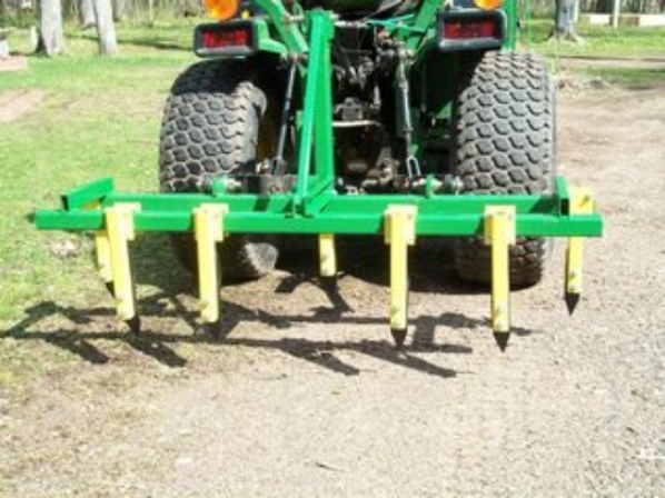

   / Lets see what you have Built for your Tractor #3
Just one of several things I built a number of years ago.
Adjustable for multi use, not fancy, did multiple jobs well enough that I needed to do.

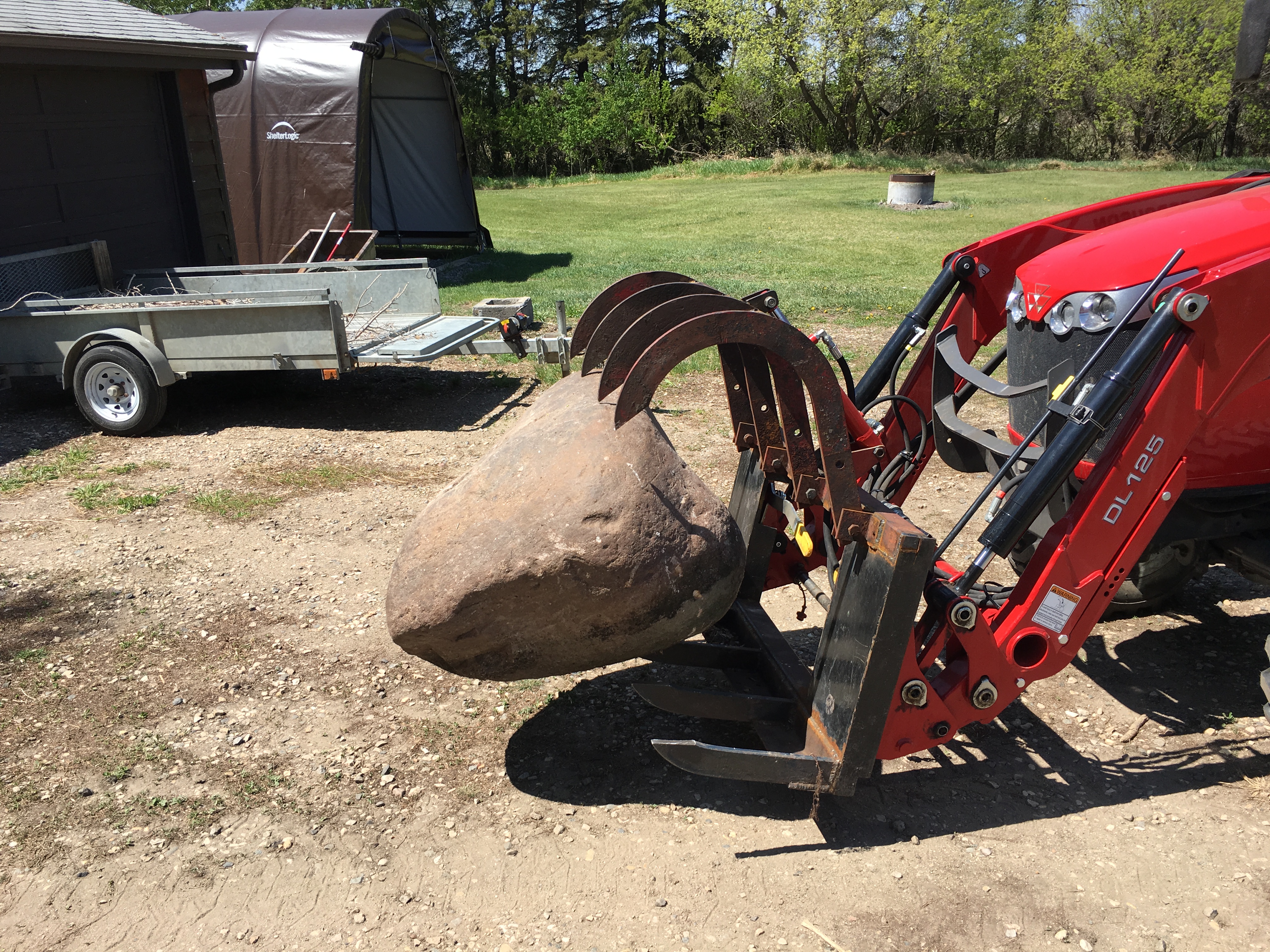

Knocked together a brush bucket to clean up the piles from clearing around the Tupelo Gum Brake.

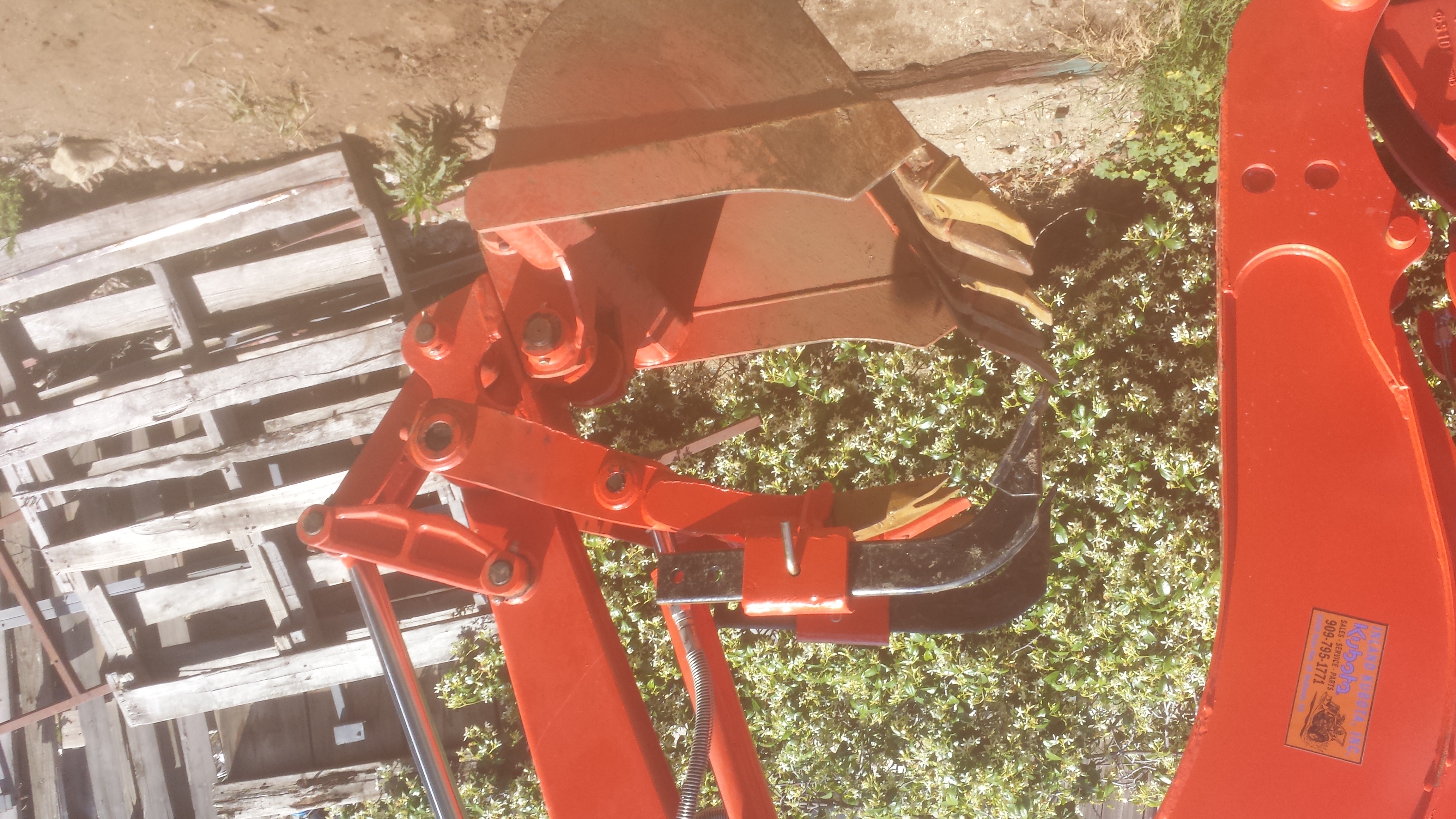

Here is an update on what My Thumb can do now that I made it adjustable 20190616_145542.jpeg20190616_145545.jpeg20190616_145030.jpeg

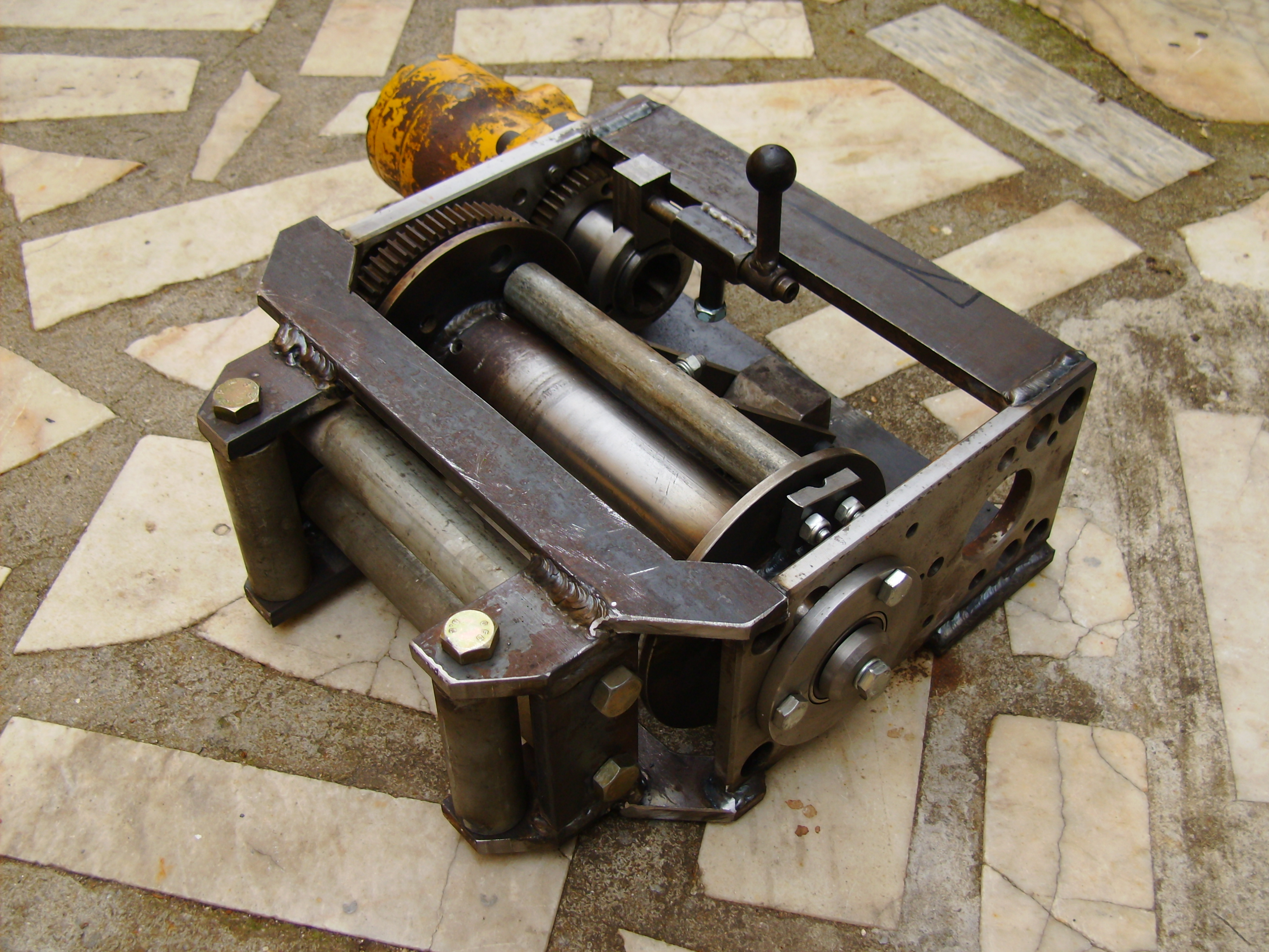

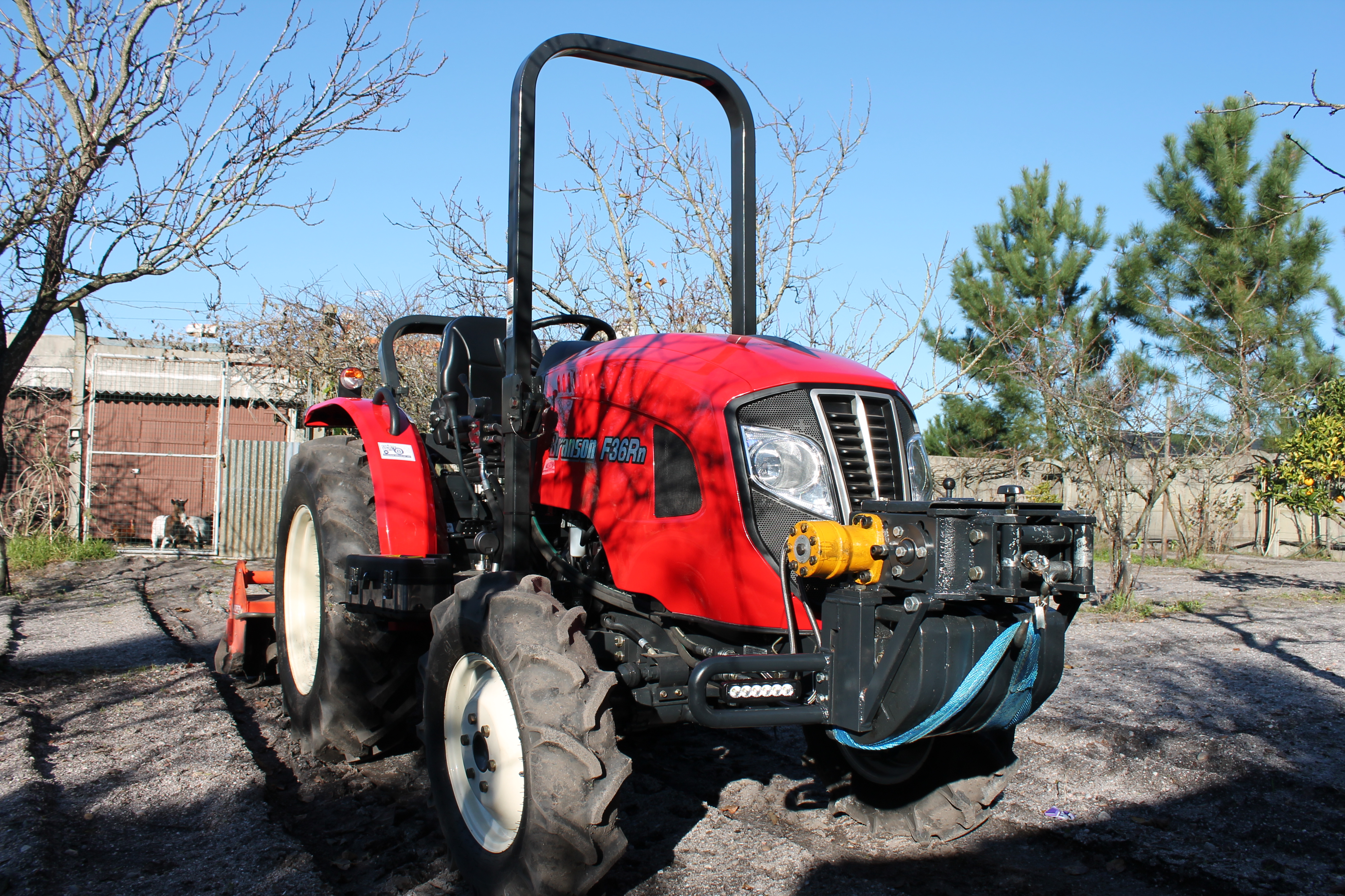

I've built a 13000 lbs (if I recall correctly) hydraulic winch, a hydraulic top link, added a couple of LED bars on front and back, added a toolbox and I'm currently building a loader.

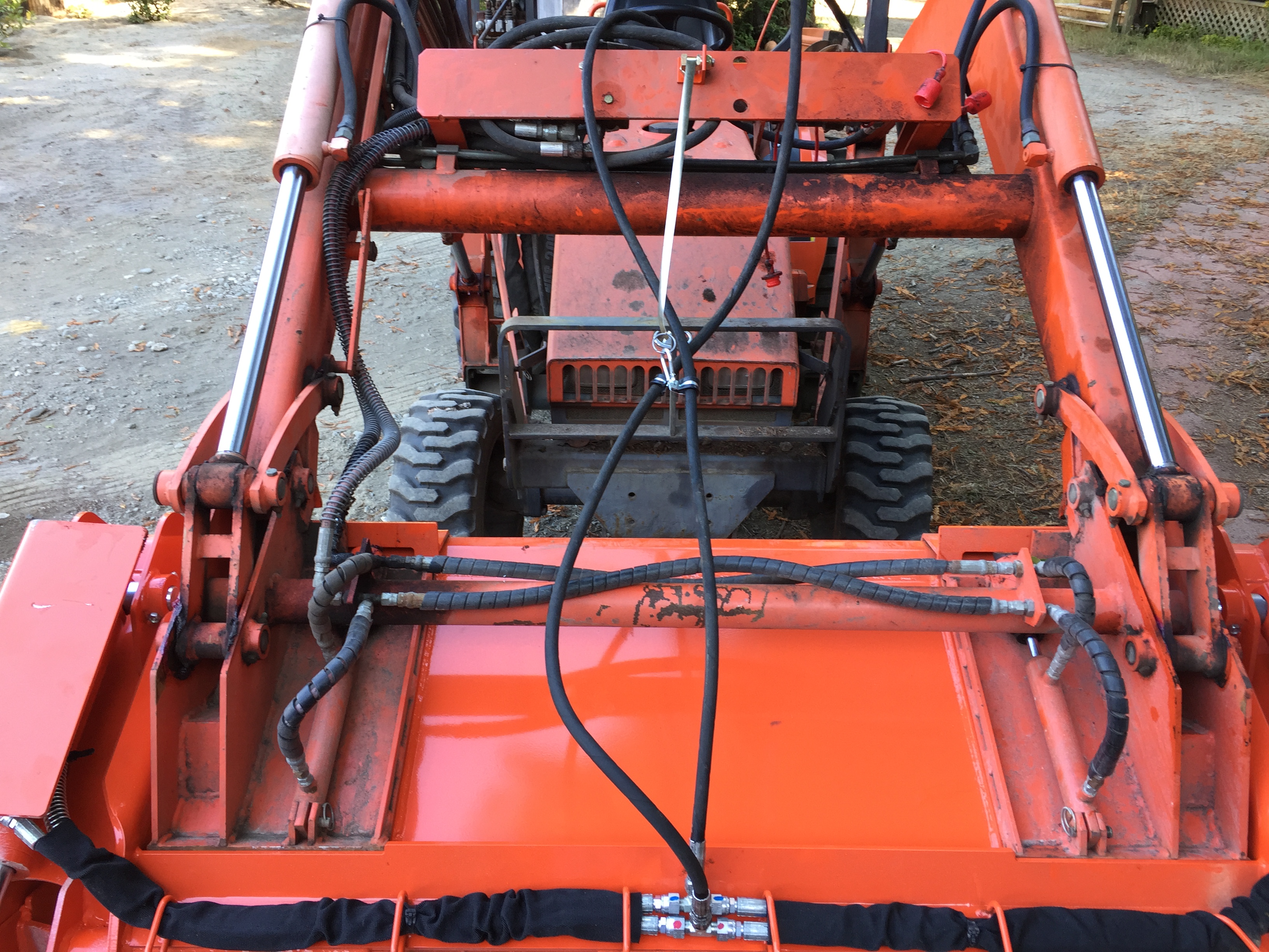

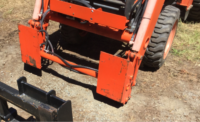

I made a SSQA adapter for my B21 with hydraulic actuation for the locking pins. Also a hydraulic thumb for the backhoe and a bunch of other stuff.
