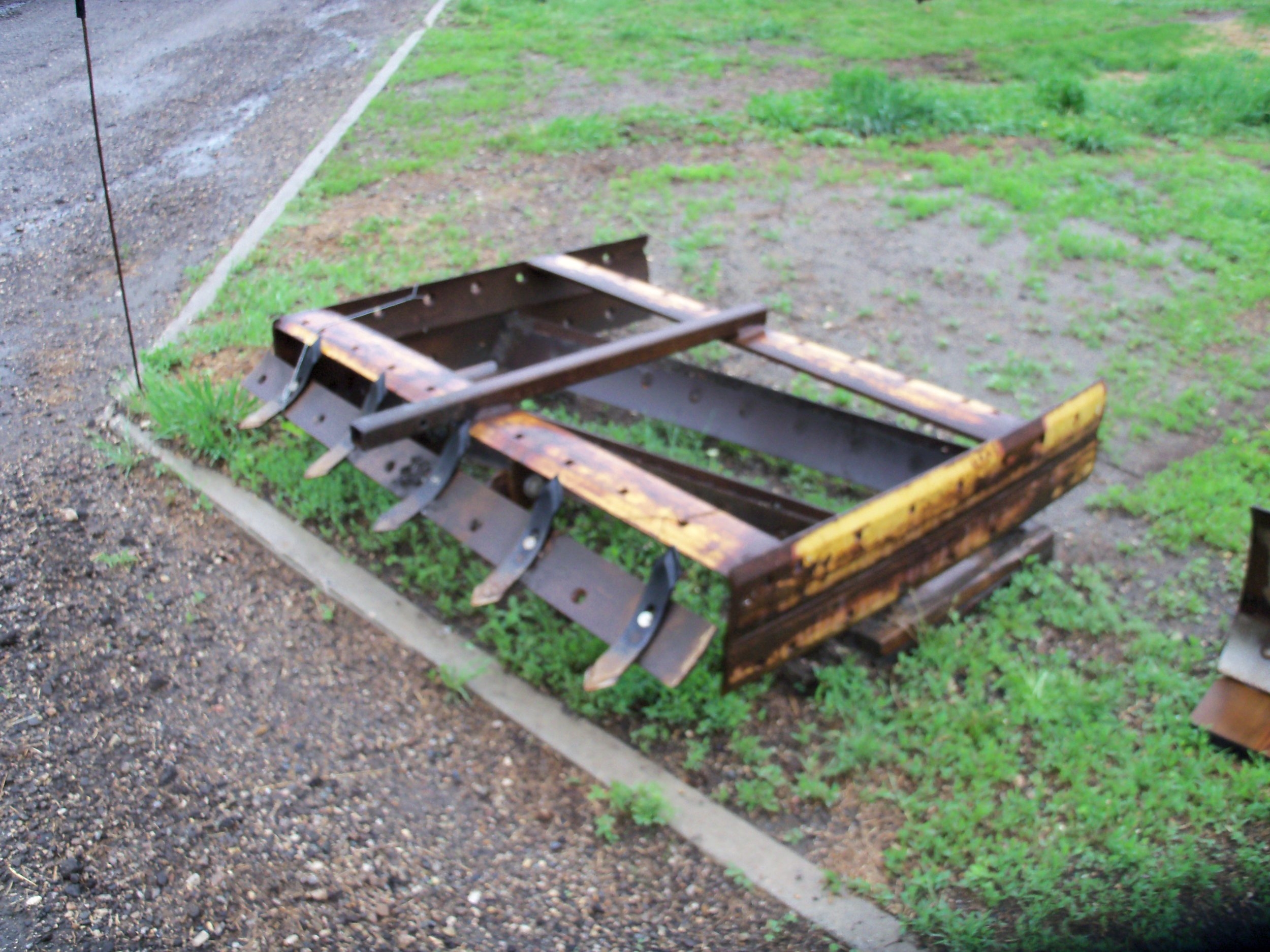

Fits in the 3 point receiver hitch. Built from what I had on hand at the time. The scarifier section was an afterthought that only sorta works.
Also later I discovered that it was too much weight for the hitch so I added a chain from the top of the hitch to the back of the plane and use a chain tension-er to take some of the forces off of the socket. The top link of the 3 point is used to adjust the angle so I can Dig, Grade, or smooth with it.
Crude and ugly, but it works for me when I need it.

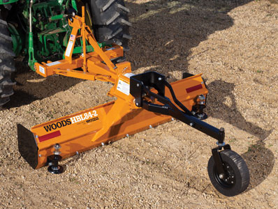

I got 1/4 mile hilly and twisty gravel driveway. Been using box blade with adjustable gauge wheels for 20+ years. I probably don't understand something, but don't see any advantage of using all those staff over my way. Anyone care to explain?

Adjustable gauge wheels make anything better.
   / Lets See Your DIY Tow Behind Landplane #24
The longer the plane is, the smoother and more level the surface. Just like when working with wood, the longer the plane, the straighter the surface.
   / Lets See Your DIY Tow Behind Landplane #25
The guide wheels serve to lengthen the "plane".
   / Lets See Your DIY Tow Behind Landplane #26
What is plane? Distance between tractor wheels and the blade?
   / Lets See Your DIY Tow Behind Landplane #27
I would describe it as the distance between the tractor wheels and the farthest thing back that touches tge earth, Ideally, the blade(s) would be in the middle of that distance - to shave off the humps and fill in the valleys. A rear blade or box blade with gauge wheels is a good example.
A Pony Grader is a really good example.
   / Lets See Your DIY Tow Behind Landplane #28
What is plane?
I would call the "plane" as the fixed and rigid smoothing device. A blade can follow dips just as the tractor tires or guide wheels. The further apart those wheels are how dips affect the grading surface gets less and less. A land plane or land leveler spreads the area of the weldment much larger than a box blade does. Each item has it's own purpose where it works best.

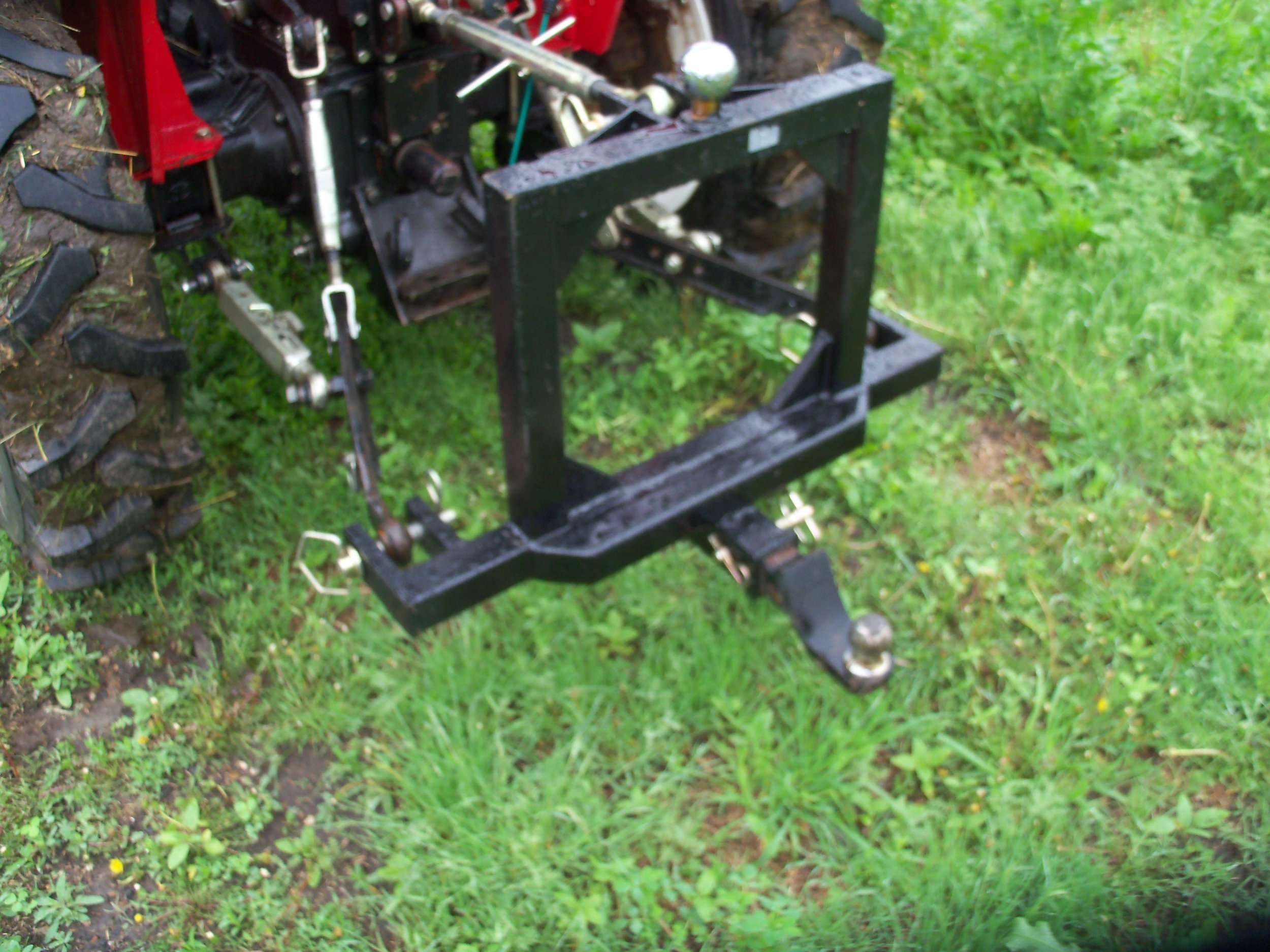

Is your's a three point like attachment? I can't see how you tow it.
   / Lets See Your DIY Tow Behind Landplane #30
No it fits in the 3 Pt hitch attachment that I already had. I didn't have the material to make the grader fit the 3pt directly.
It goes in where the ball is mounted and I run a chain with tension-er over the upper ball. Sorry I don't have any photos of it all set up and working.
I also have a 2 gang disc plow that mounts the same way.
