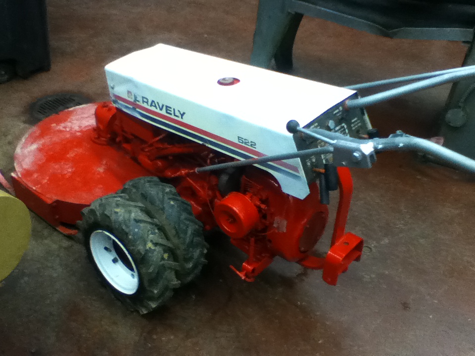

My Gravely 522 - I'm going to start overhauling the engine this week.
