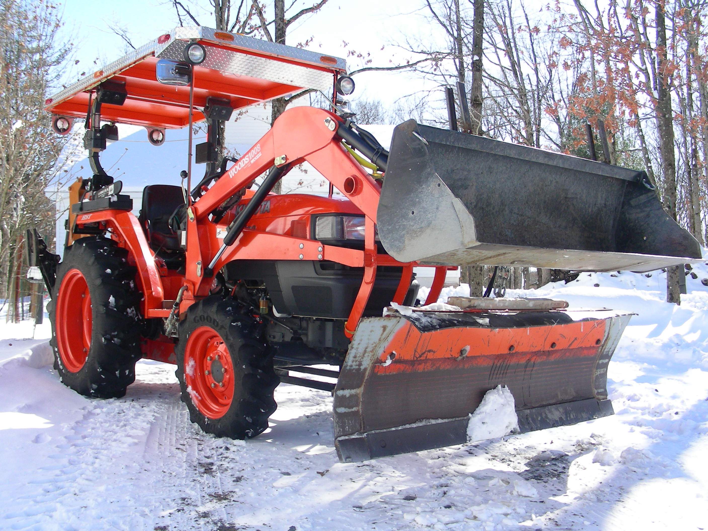

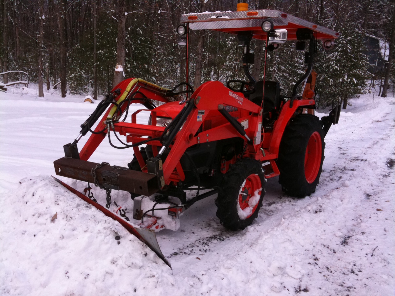

My Kub is a L2800:
I first attached the used plow I purchased off eBay to the loader bucket of my L2800 but found that precise steering was difficult in deep or heavy snow. Also the overall length of the tractor was much longer when the plow was mounted on the bucket.
So the next year I had a plow push frame fabbed up at the local welding shop and re mounted the plow on the plow frame who's aft attachment end is much closer to the longitudinal center of gravity of the tractor.
I re plumbed the hydraulics a tad so I could lock the bucket position where last located and swing the plow with the loader curl n un curl command. Than I would lift the plow by placing a chain up to the loader bucket. However this made forward visibility horrible.
So for the next winter I had the same fad shop make up a cross member that replaced the loader bucket, maintained the loader arms rigidity and provided a spot to attach the plow's lift chain.
My plan for this past warm weather season was to take the cross member you see in the photo below to the powder coaters n have it painted, however as we all know, $.$$ is no longer good in our once great nation for all but the wealthy, so just a rusty old chunk O steel is mounted on my lovely Kub still.
So, in conclusion, after 3 + seasons of re design, the Kub now plows good, steers good, visibility is good and the Kub is lots shorter when the plow on. But the job just looks un finished thats all, I guess a small price to pay, however it does bother me a tad to not completely finish a job on such a nice piece of equipment.

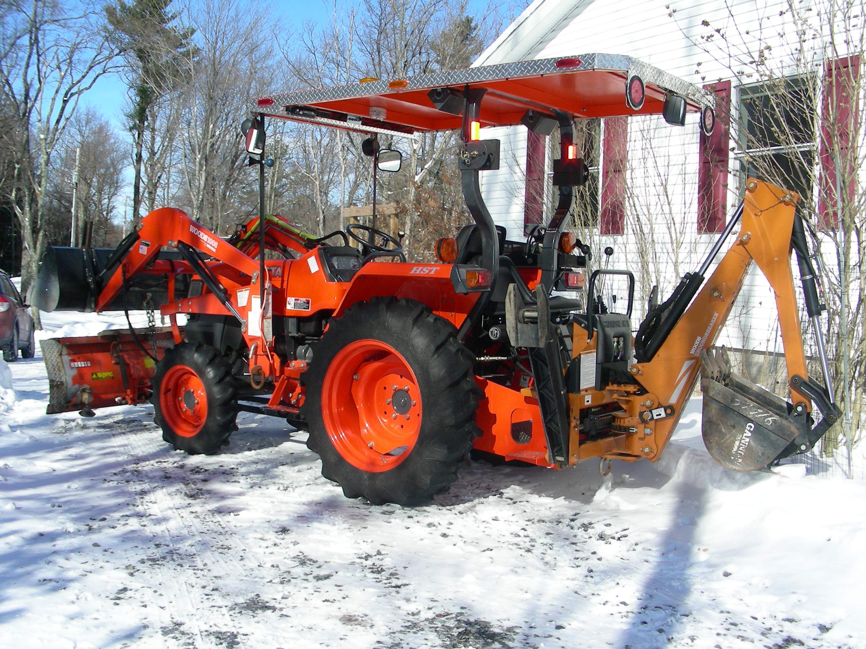

Well This is new for this year - been pushin'... now I'll throw it. I have 1/2 mile of private road up on top of a hill, getting pretty icy.
L3400, HST, LA524 FEL, BX32 Chipper, B22-60 rear blade and the
Erskine FM-601, seat heater :licking:

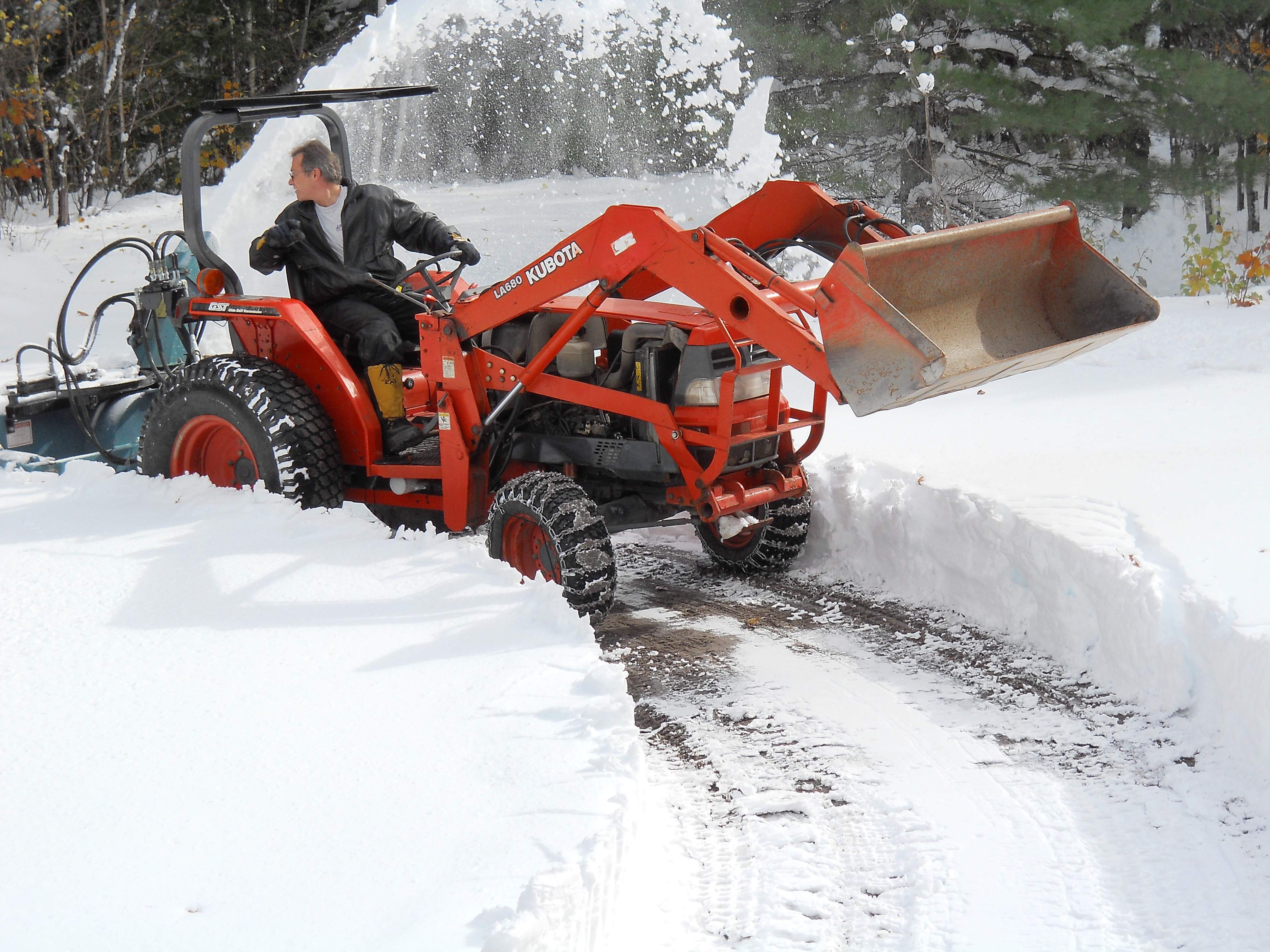

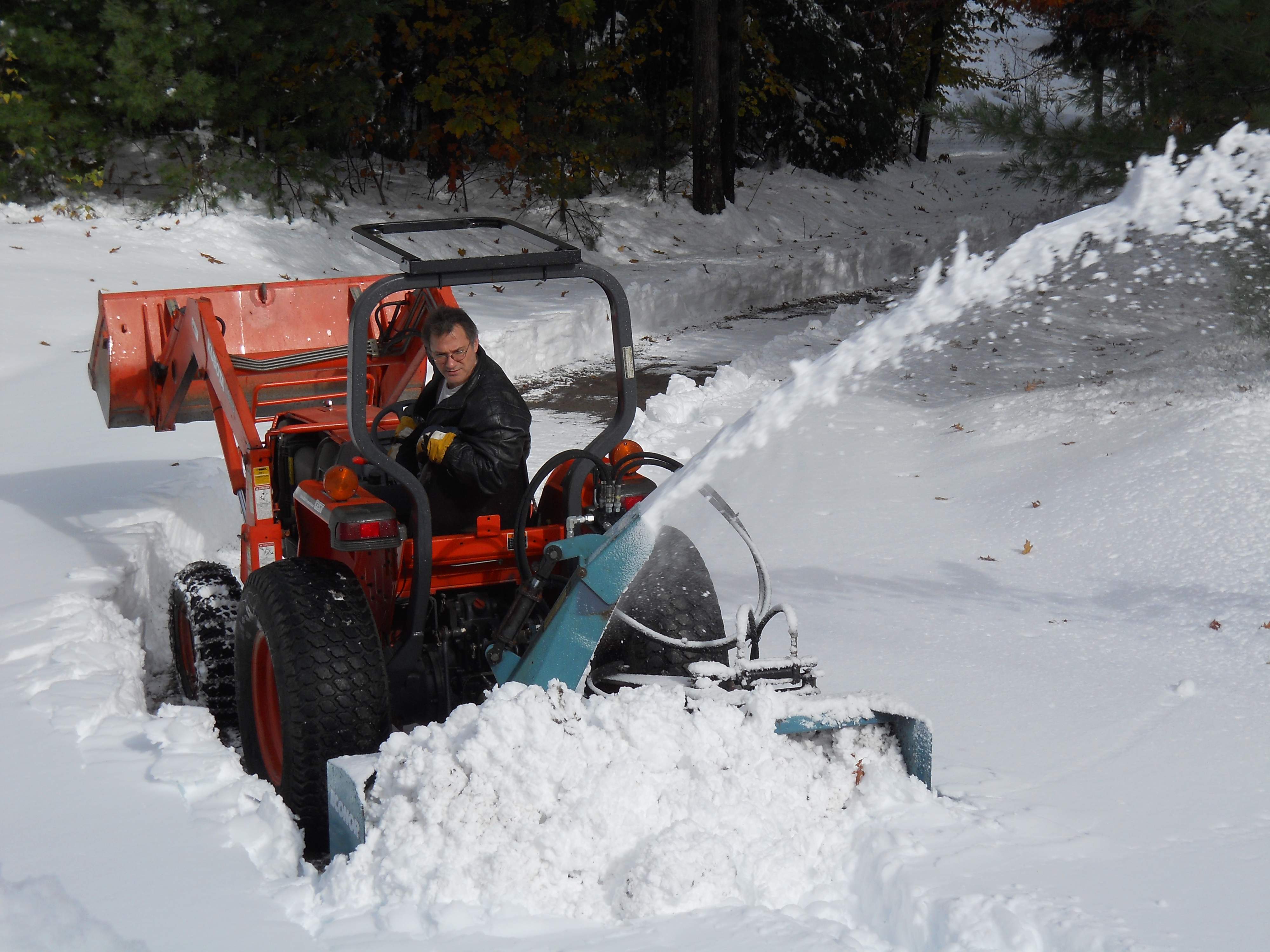

Here's me 3 weeks ago on Halloween day, when for SOME reason 2 1/2 feet of the white stuff fell out of the sky. Kubota L4200 w/ 6' Econor blower. Check out those funky hydraulics :).

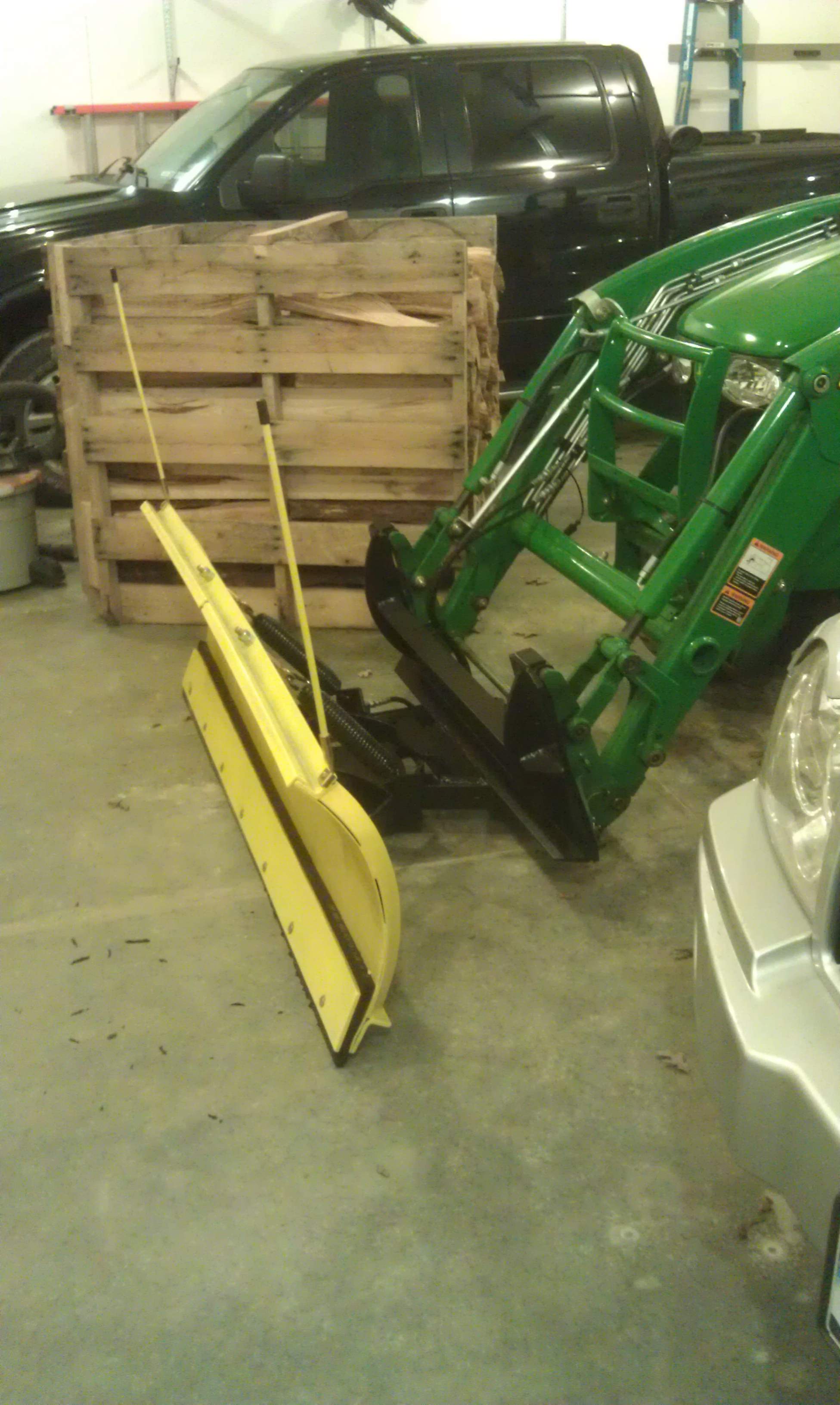

JD 3520, Farm King 074 with Hydraulic chute rotator (deflector also in the works), New FEL plow build, and a shovel.
What about this makes us like little kids praying for snow?:laughing:

Jay-- I heard you guys got nailed...we only got about 9"... but that was quite enough, thank you! I can see by the snow exiting the chute that yours was real wet, too. I started to clear mine with the FEL, since the blower was still "in storage," but I quit after a bit and got the blower out. Worked much better.
