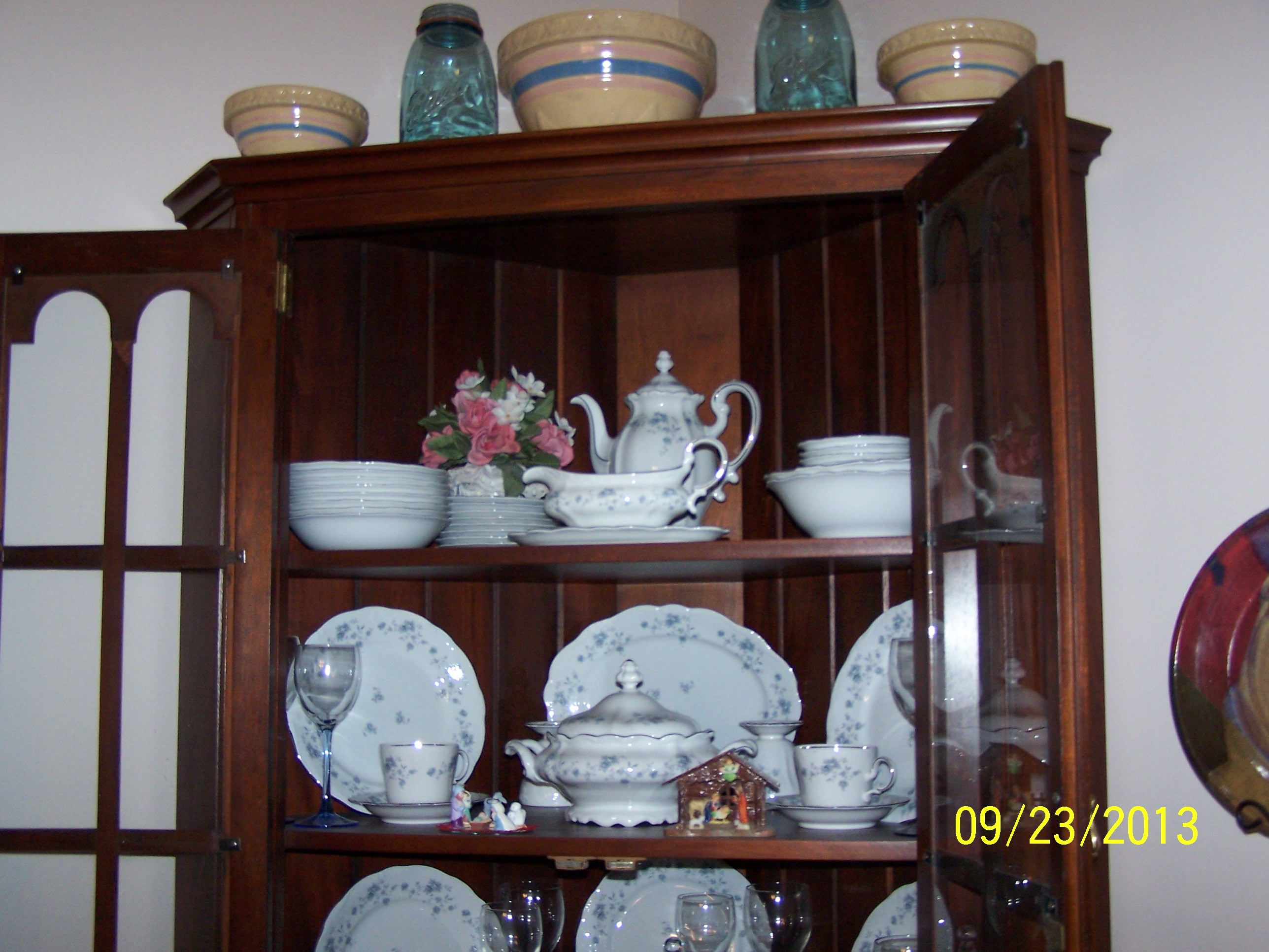

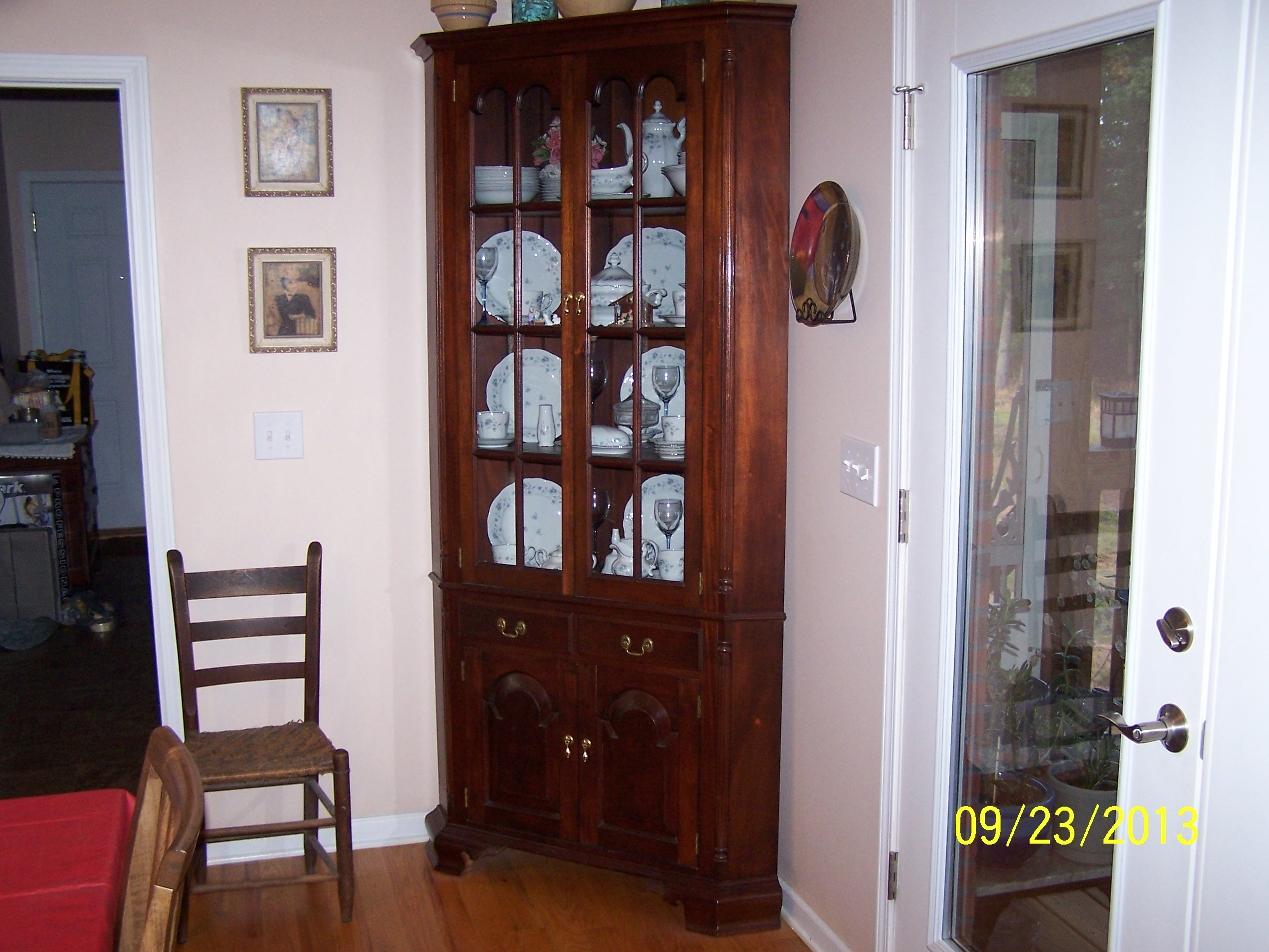

First set is a Queen Ann style corner china made from solid mahogany. Tough piece to make because of all the angles. The doors on the bottom were made with a table saw and block plane for the rounded top of the raised panel. The columns were 4 pieces glued together, turned, fluted, and split.

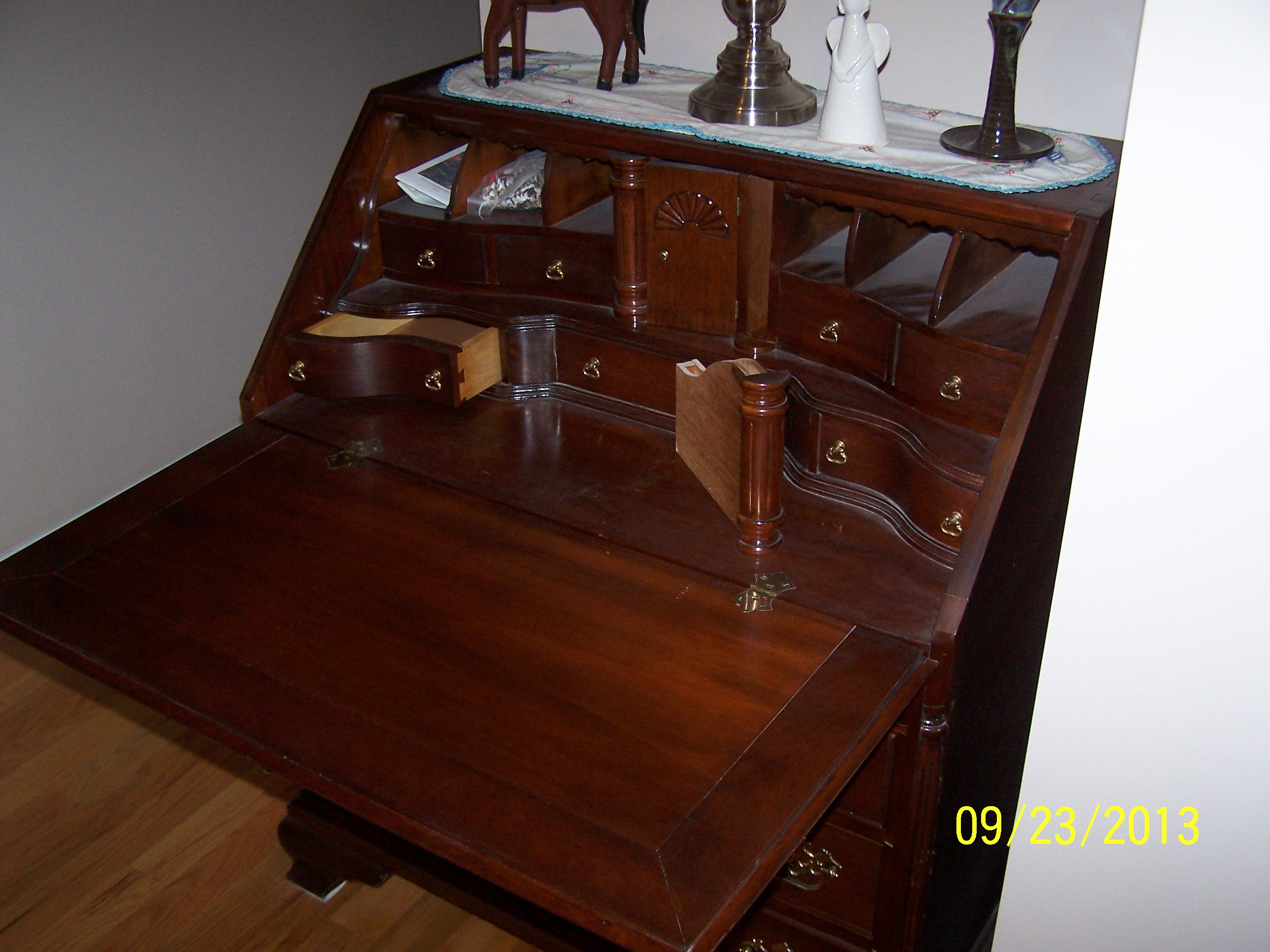

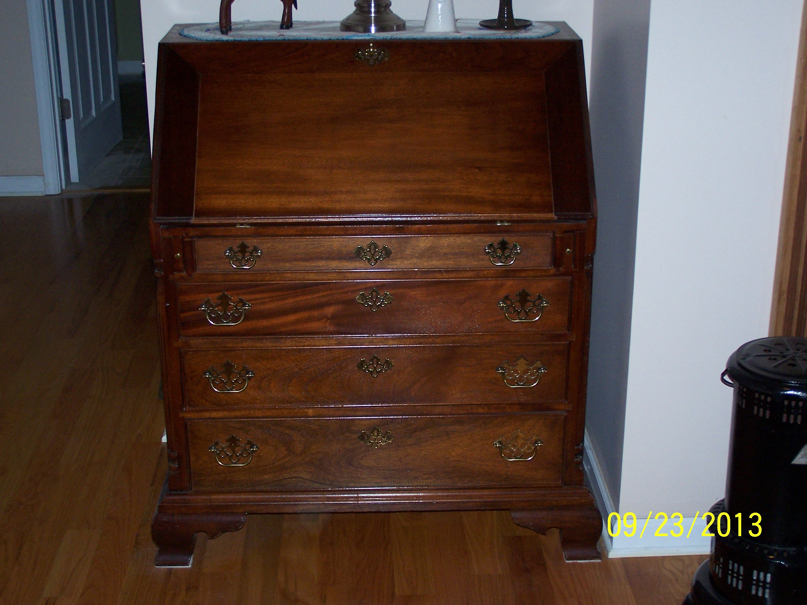

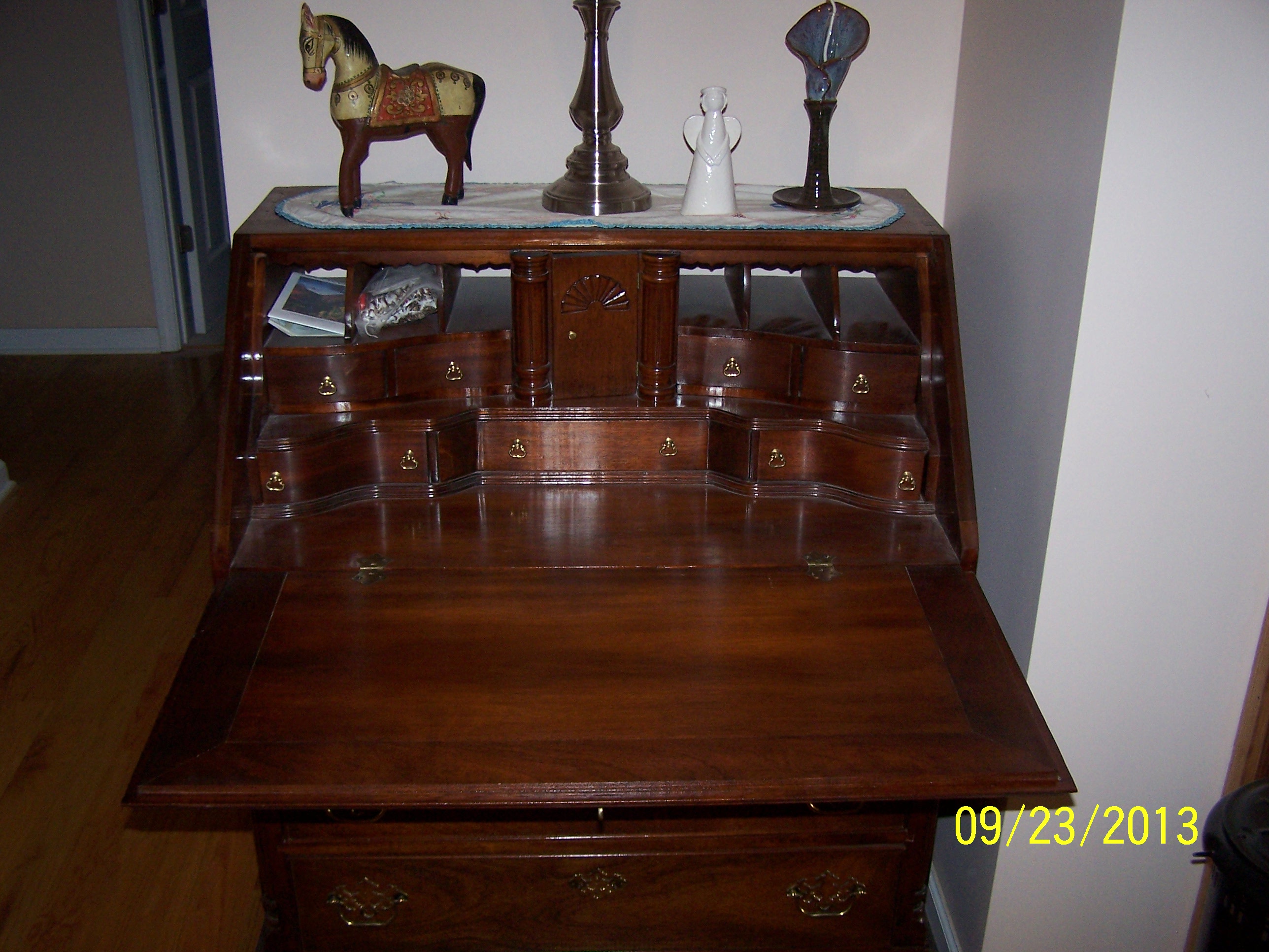

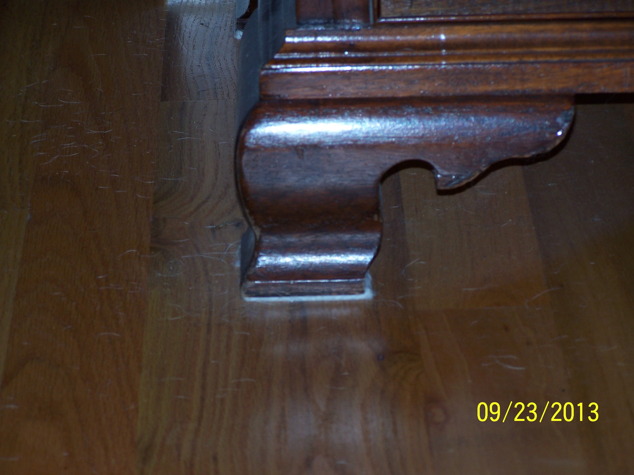

Second set is a slant top secretary I designed and built. All dovetails had cut, all inside drawers curved, columns turned and split. I made a book case to go on top but during our move I damaged part of it. I have it in the basement for repair this winter.
The O G feet are made by running a piece of 8/4 at 30-60 degrees across a table saw, raising the blade a quarter turn per pass. Then using a block plane to blend the profile. Bandsaw to cut the decorative shape.
The drawers have a bead around them to add depth, not too hard to do but does take some time.

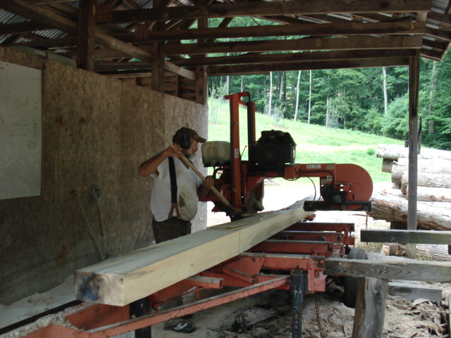

My woodworking starts at the tree.....
Then goes to the sawmill:

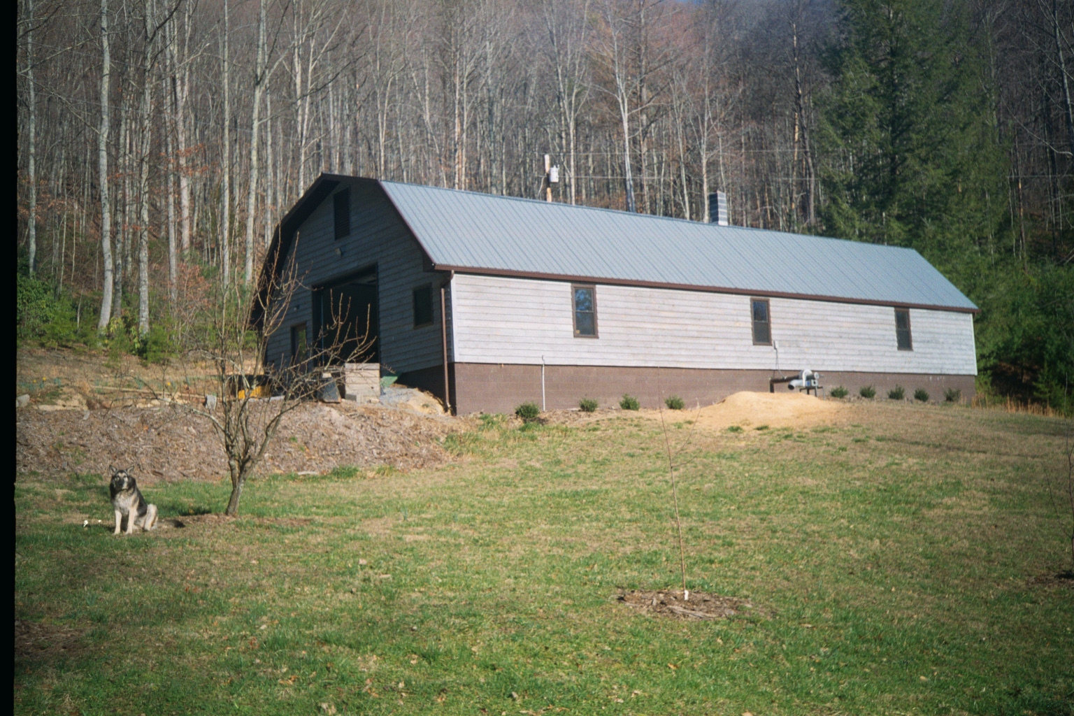

Then goes to the wood shop built from the wood that went thru the sawmill:

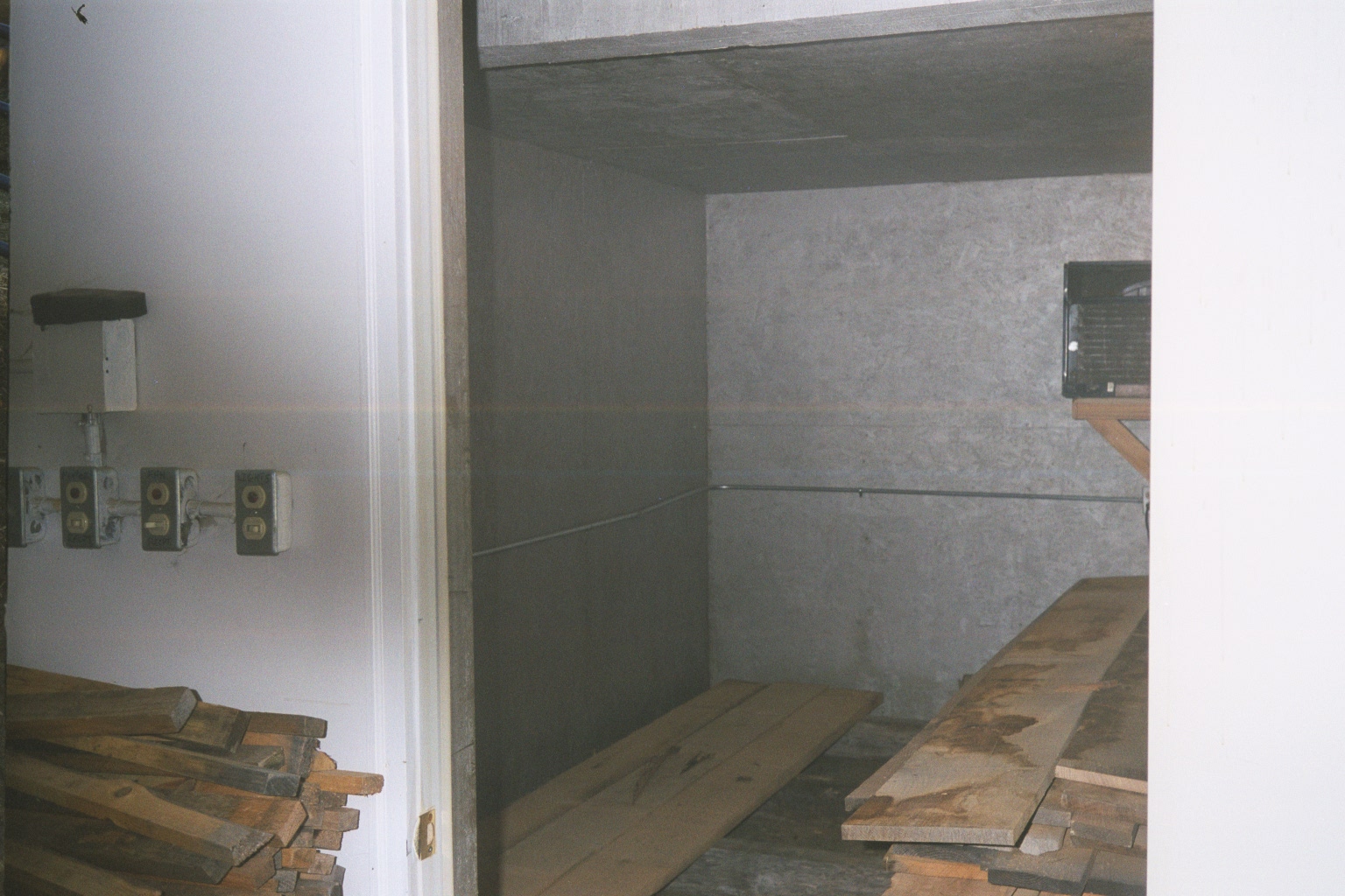

Then into the dry kiln inside the shop ( run with old window AC ):

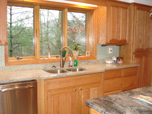

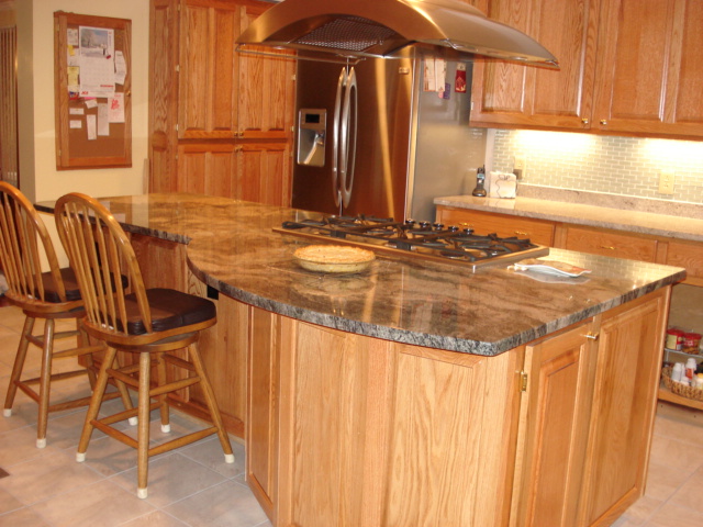

Most of the woodworking I do is cabinets and moldings, such as:

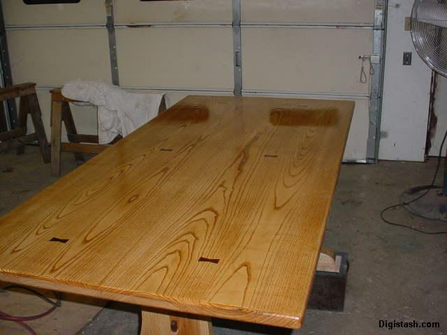

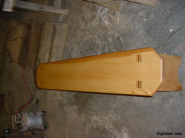

But sometimes I make some furniture. Ash table here for a friend, with walnut accents. Table and benches all from the same log.

Andy, now that is some nice craftsmanship on the cabinets and table.

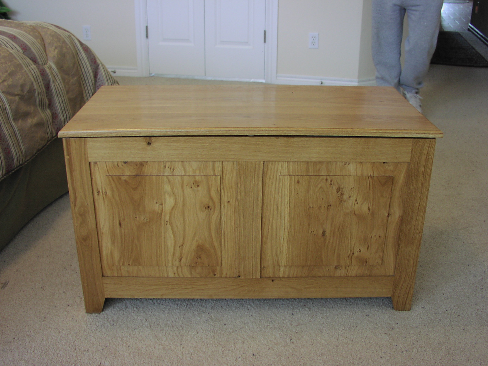

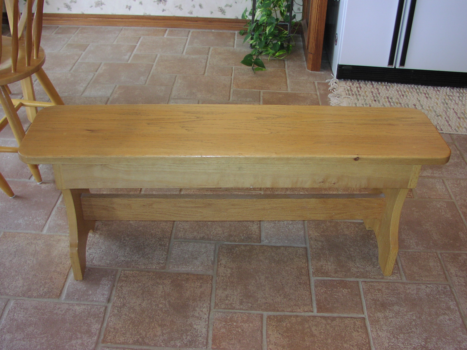

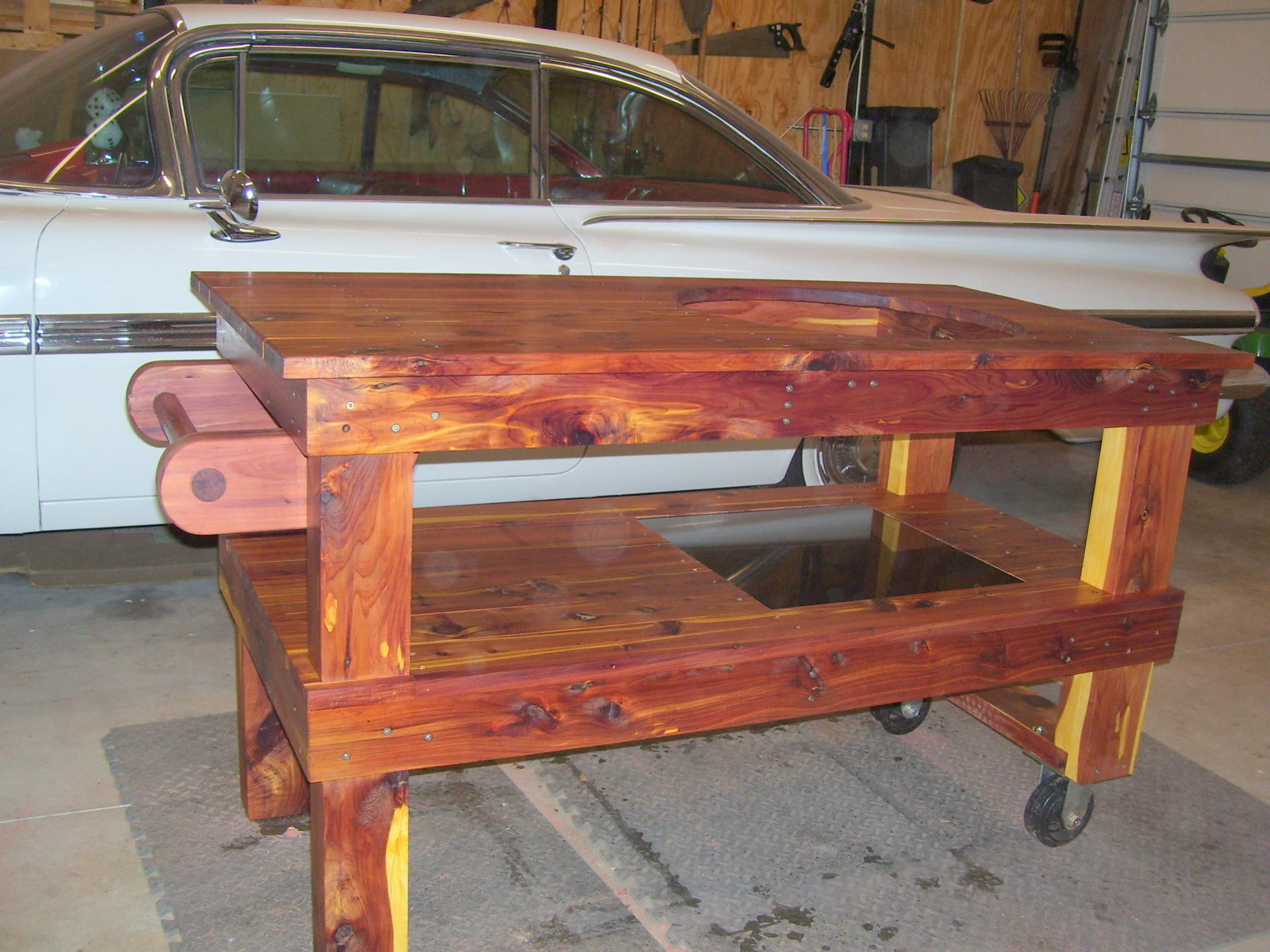

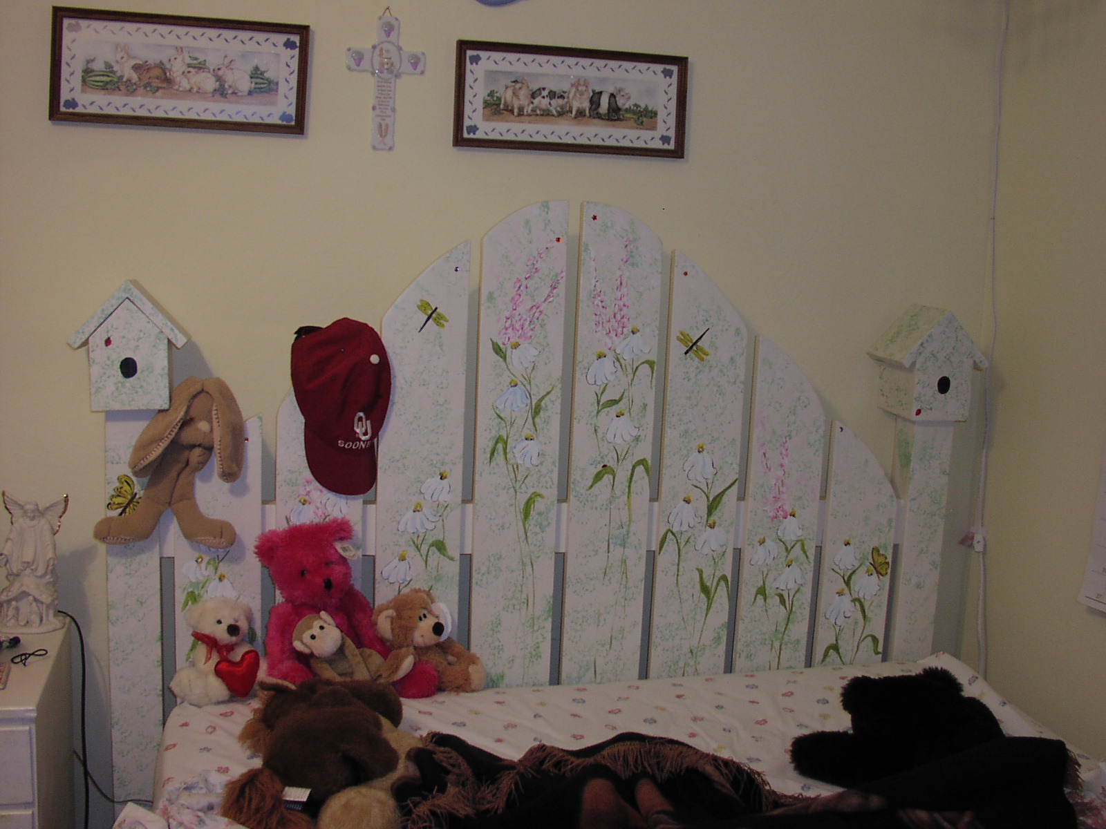

You fellows do some breathtaking work. Mine is a big simplistic by comparison, but I enjoy it and the kids don't mind taking it off my hands.

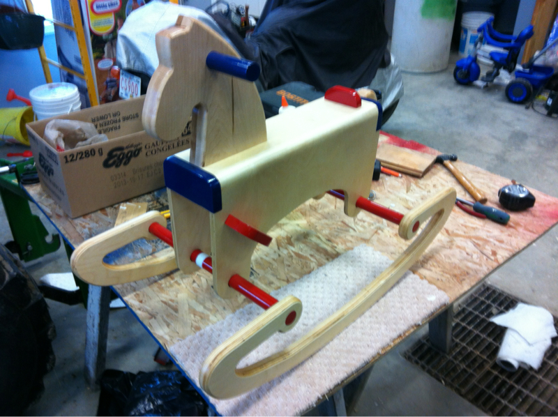

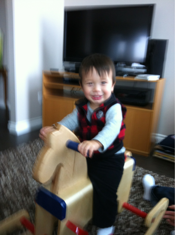

This is a recent project I built for my sons first birthday. The horse body is one piece of Baltic birch plywood that was steam and kerf bent to shape.
