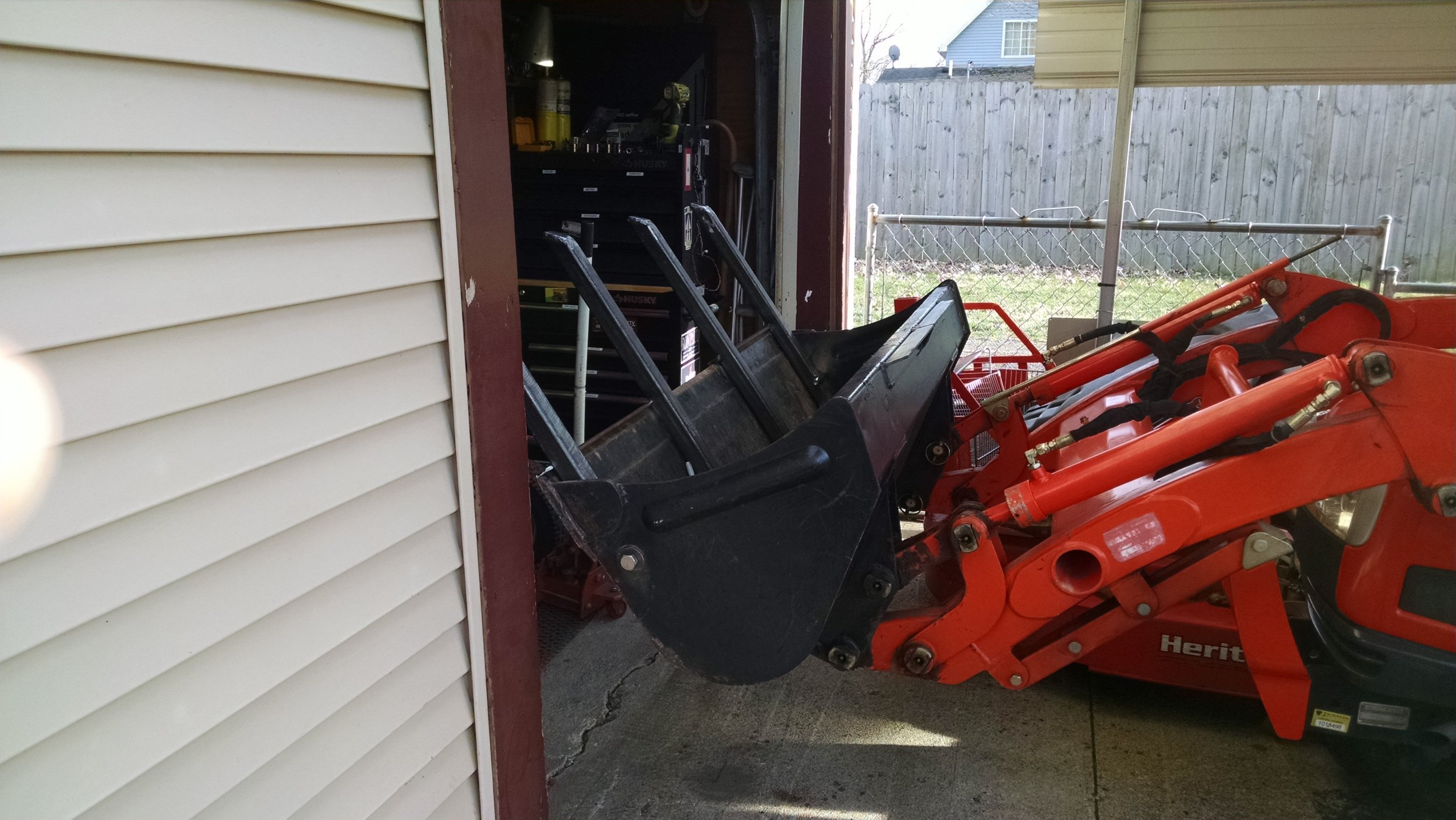

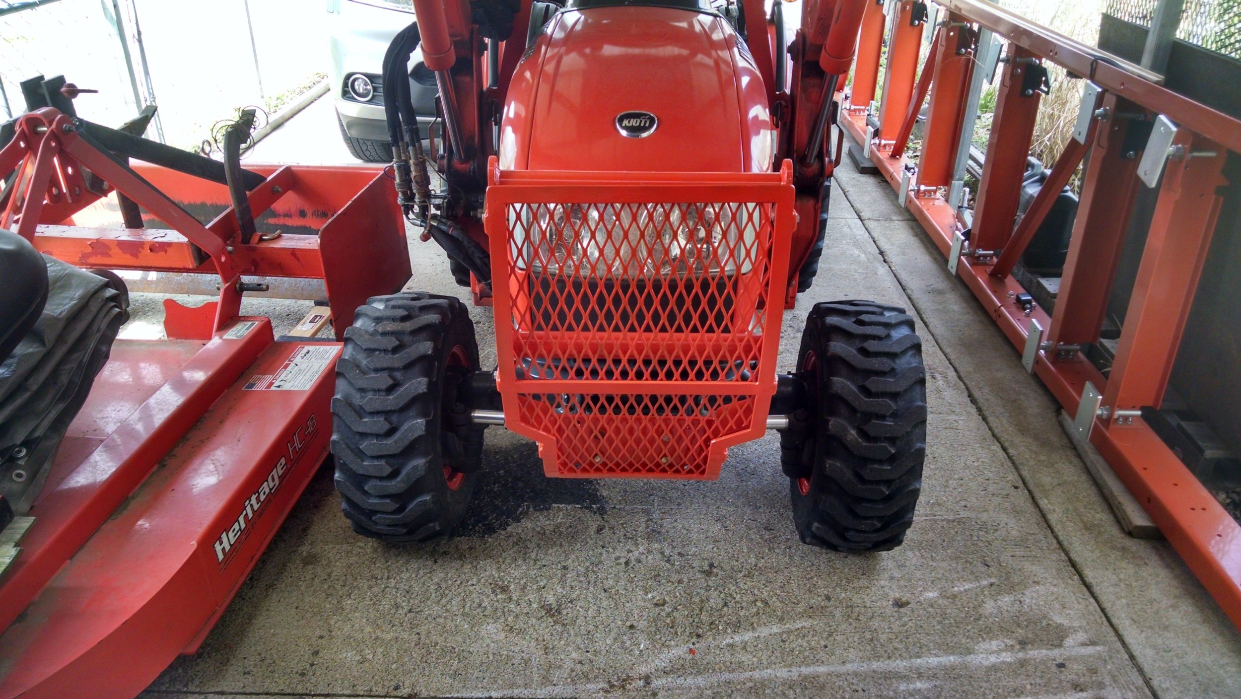

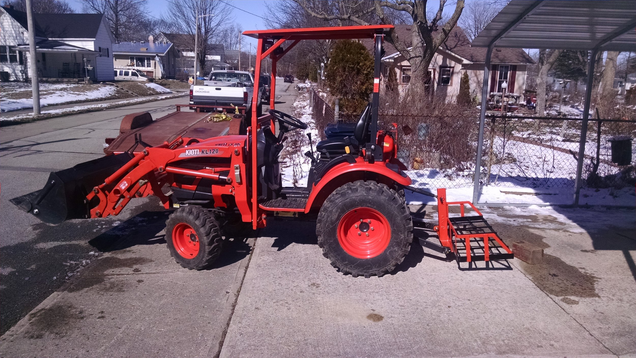

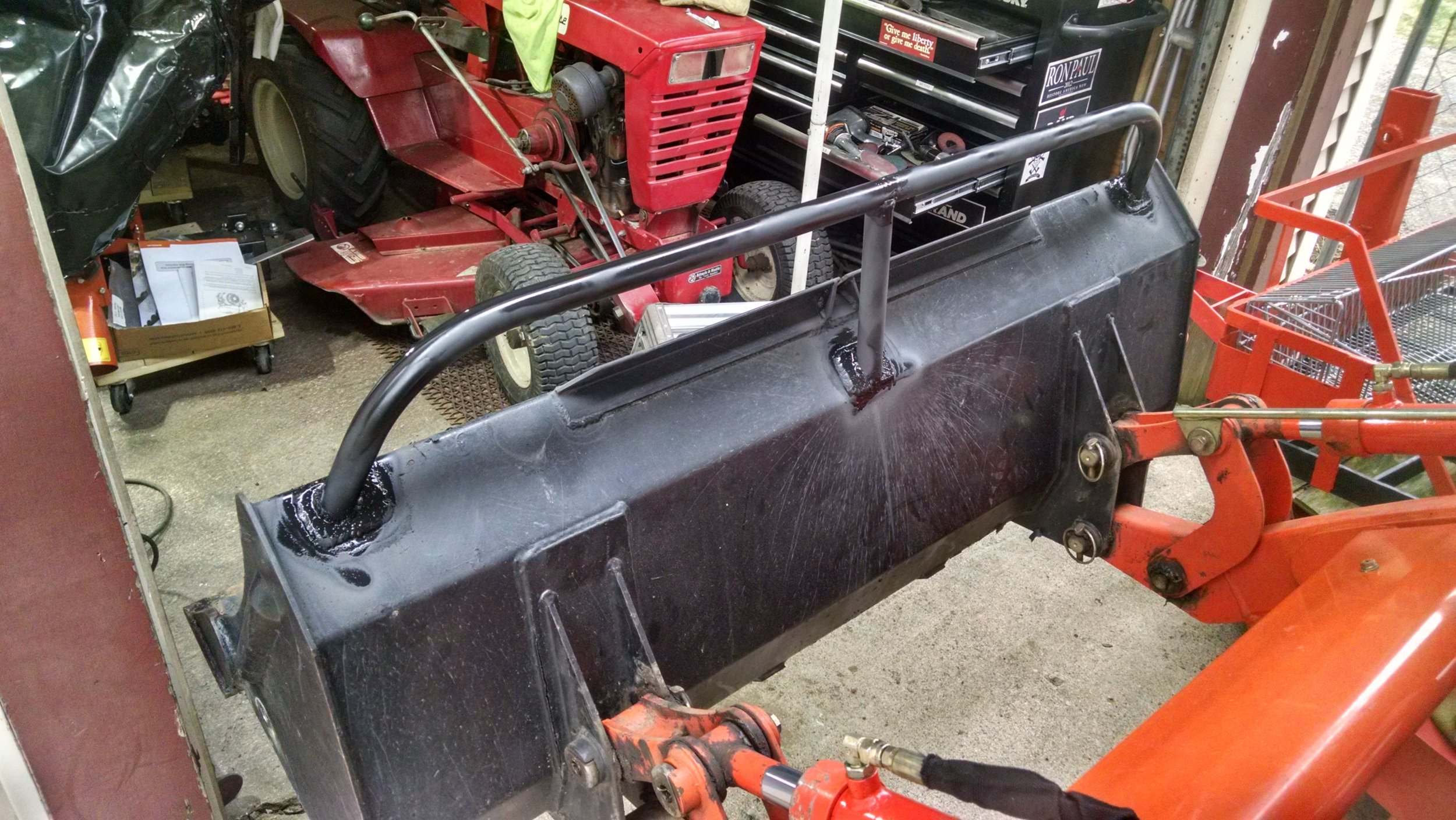

Within the last four years I have fabricated a full four-point canopy for my Kioti tractor (to protect my head from falling limbs in the forest), a carry basket for logs on the three point hitch. A log arch for hauling large logs. A carrier mounted onto the frame of my tractor canopy for carrying my chainsaw. A brush guard to protect the front grill of my tractor when in the woods. Quick removable forks, that bolt to my bucket, for moving brush and lifting logs. A safety loop over the top of my bucket to prevent the contents of the bucket from rolling back onto the hood of my tractor. I also cut down a larger box blade grader to size to fit my tractor and welded it back together. The box blade was built of 1/4" and 3/8" steel plate. It has held up very well to the abuse I give it. I've never broken one weld on it to date. I got excellent penetration on the welds that were easily visible from the reverse side of the plates. I've also welded 3/8" plate onto the bumper of a camper for carrying the spare tire. I have fabricated "rock rails" that attach to my Jeep's frame to protect the side of my Jeep when in the woods and also made some for another truck I used to own.
The point being to all of the above is, yes, a quality 110 volt wire welder can produce quality welds on metal up to 1/4" thick. Honestly, most projects for farmers and do-it-your-selfers will rarely require welding metal thicker than 1/4". Usually 3/8" steel or thinner. Those that regularly need to weld the thicker metals normally have a 220V stick or GMAW welders to do it. I totally agree with etpm that pre-heating the thicker 1/4" metal enhances the quality of the weld.

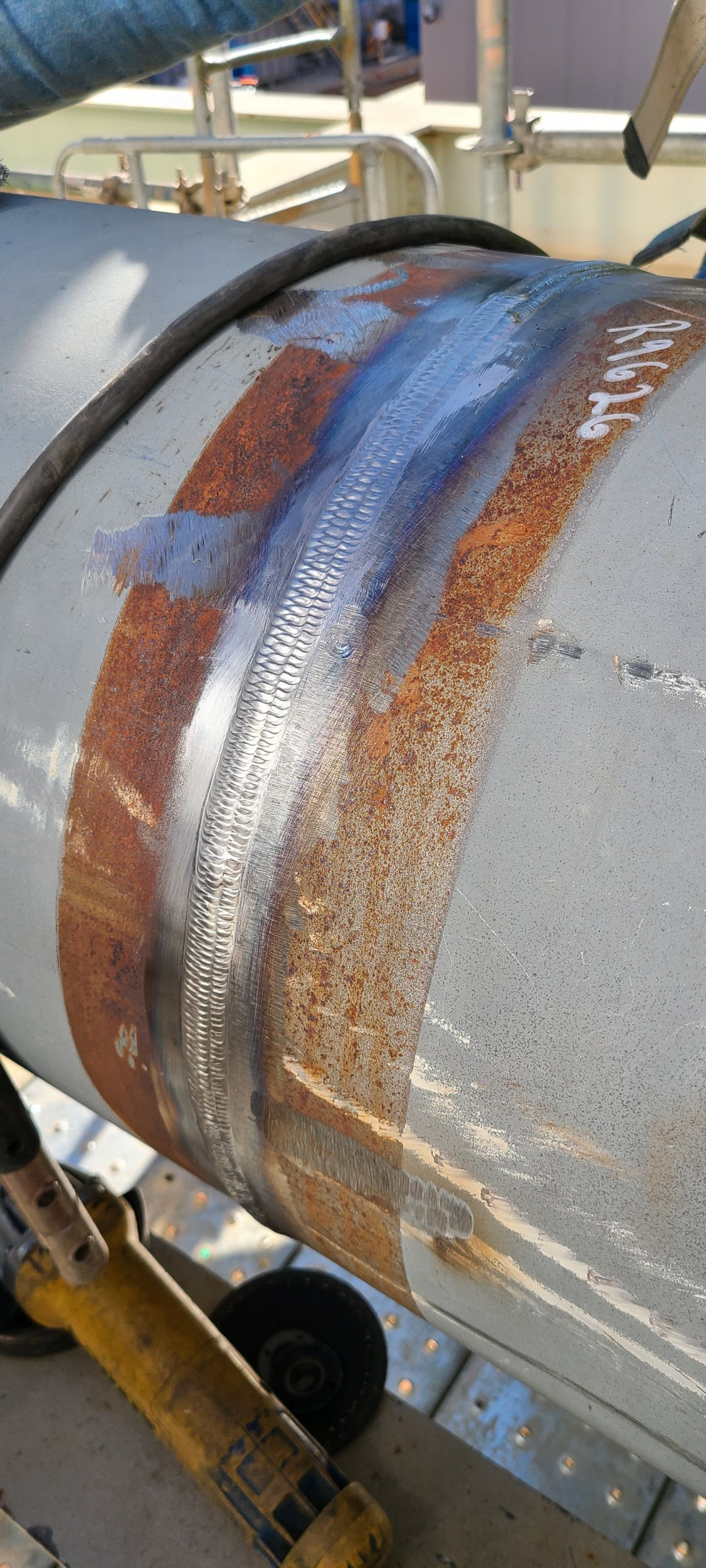

My Grandson is a Certified Welder. He can do better welds wrong handed than I can on my best attempts. Being a good Welder is an art. Some of us are artists, some of us are not... :)
   / Let's talk about MIG welding #12
I agree ovrszd, Your Grandson is an "Artist" and I will never be! That weld is a genuine work of art that will never be performed by me! Kudos!
Thanks for the compliments. Me neither. :)

Overzd grandson is an artist on that large pipe weld WoW
