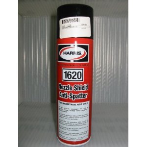

I'm going in the morning to get a can of Harris anti spatter.
It was 8 bucks for a can, it better be a gold plated can for that price. LOL

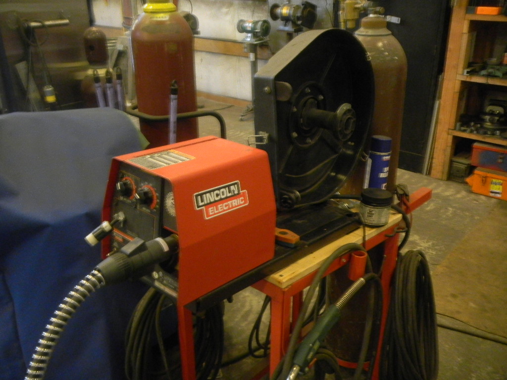

I too use 36-grit sanding pads for all clean up. I have a can of anti-spatter, but I'll bet it is over 10-years old, I never use the stuff. I do use nozzle / cup dip if I'm using the wire feed a lot! Normally all I do is clean the cup / nozzle out really good after it's hot, and dip it in the cup / nozzle dip, and sling out the excess.
2nd on the nozzle dip. It's a must! Don't bother with spray for to protect the nozzle.
