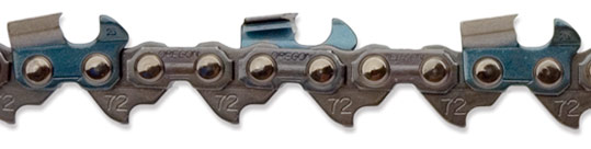

The only chainsaws I own are Stihl's. I love Stihl chains. I've been on Dolmar's website and like what I see. Very nice looking saws and alot of folks here use and like them as well. How do their chains compare to Stihl's? What does Dolmar make that compares with the RSC chain? Does anyone run Stihl chains on their Dolmar? Thanks in advance.

Dolmar and Husky use Oregon chain with their names put on it.
You can run any name chain on any name saw. Just match gauge, drive link, etc.

Stihl chain is definatally the best of what I have tried.
Oregon chain is also good as long as it has the cutters with the bluish tinted teeth.
Last time around, I got some woodland pro from baileys because I was also buying a bar, and trying to save a few bucks. Their 24" chain was $16 compaired to the $22 or so that the local stihl dealer charges me. The guy at baileys reccomended it as being the closest compariable thing to stihl.
I would not reccomend it to anyone though. For whatever reason, it comes sharpened with 35 degree cutter angles instead of the standard 30 degree I am used to. So needless to say, it didnt hold an edge long in our dead eastern hardwoods.
After filing the angles back to 30* though, it does seem to hold up pretty well, allthough not quite as well as stihl, but close. But alot of cutter material was lost and time wasted just getting back to 30*

Just ran some carlton K2 325 new loop I had on hand on a 45cc 346 I picked up last night. Like the bigger cutter of the stihl rsc 325 chain.
   / Let's talk chains. #10
I agree that Stihl has the best chain. But, recently I bought a loop of Windsor chain, and I very impressed. It's holding up as well as Stihl. I don't know the Windsor model, but it has a K3 stamped in the drive link. I think I paid about the same as Stihl.
