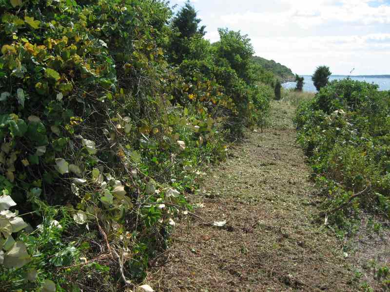

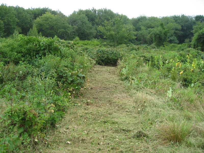

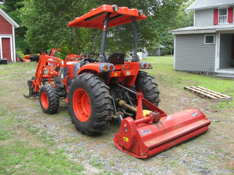

I have a Caroni TM1900 flail that I really like. I had previously used both bush hogs and rotary finish mowers. The flail cuts pretty close to the finish mower in quality but is more like the bush hog in its ability to cut rough stuff. I like the short projection off the rear of the tractor and the quiet (especially compared to the bush hog). I don't really have any negatives to report although it is clear that when it does come time to change knives it will take longer and be more costly than with either a rotary finish or bush hog.

I believe the cut is 75 inches. The mower is offset to the right about a foot (similar proportionally to Iron Horse's photos). I use a 41 hp Kioti DK40se but I would be confident using this size flail on a 30hp tractor in routine cutting of pastures or lawn and in a 35hp tractor for brush work. I believe it cost just about $1600 from AgriSupply (plus shipping). AgriSupply is a very good outfit that has carried the Caroni line for quite a long time and is, I think, the main importer of these mowers from Italy. They carry a full range of supplies as well as other Caroni equipment. Caroni may not be a name that you see at local tractor dealers but from my experience they are equivalent to Woods, Landpride, Bush Hog, Rhino etc in the sense of being a well established quality company.
