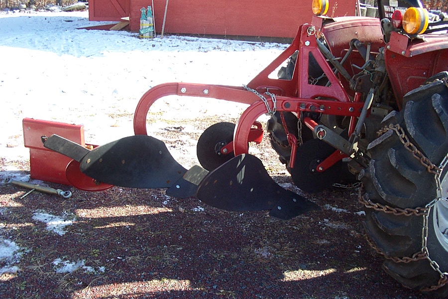

/ Let's talk plows! #7
I have a single 14" mold board that I bought at a auction for a $100 bucks.
Don't even know the brand but it works great.
I built this one out of large pull type that was rusting away in a pasture on a farm I hunt.
It was free just had to haul it off...

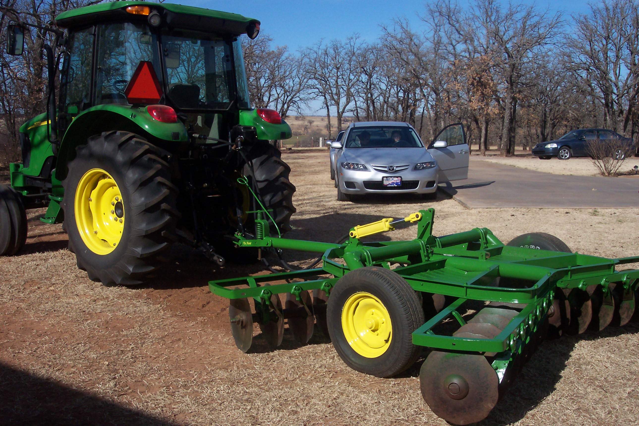

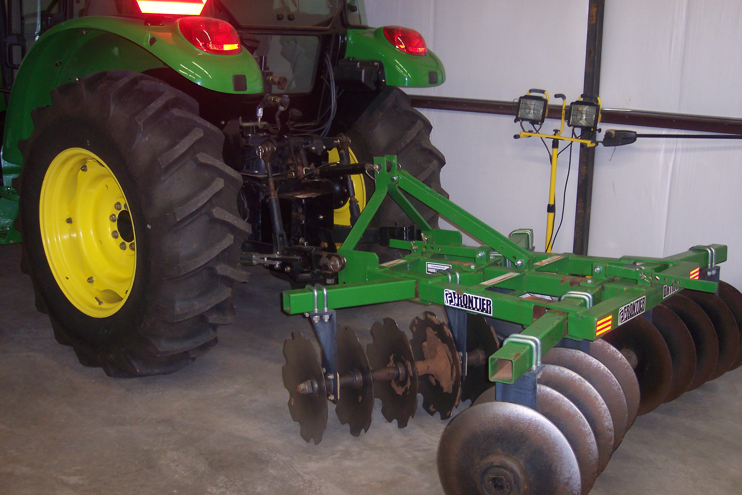

/ Let's talk plows! #10
I have both.. the 3 point can track straight...the hydrolic can "drift" if you try to float it too much.
The OP was asking about plows if I read it correctly, not discs.
One advantage of the semi mount plow is that it follows the ground contours better then a 3pt mounted plow will.
