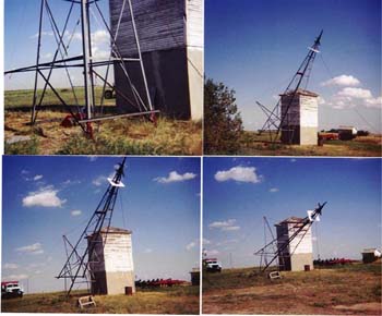

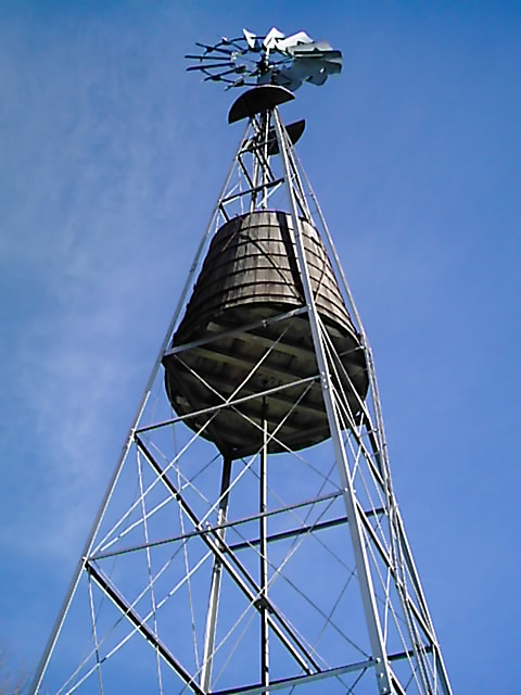

at one time most ever farm had a small water tower,
the attached picture is of lowering a windmill at my uncles farm, but in the picture is the water tower/ tank, it has a ceder tank in the upper half and this one at one time I think had a windmill on top of the building,
they also had windmill towers with tanks in them,

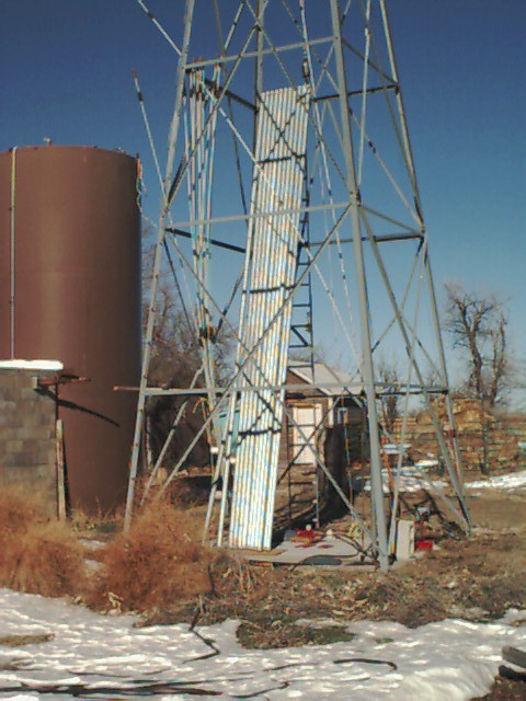

If you have any slope and extended property one can just set the tank up on the hill, one can use the the same pipe to pump the water up in as it comes back down it,
On my farm, have a twenty foot tall tank and basically use out of the top segment, but do have a pump and can use all of it, if needed,
(the picture is of pulling the pipe out of the well, but you can see the tank in the picture, (the inside of the tank is epoxied with a commercial tank coating for water towers/storage tanks).
