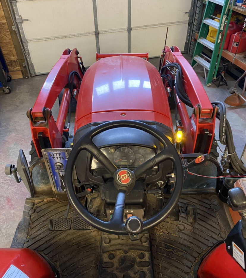

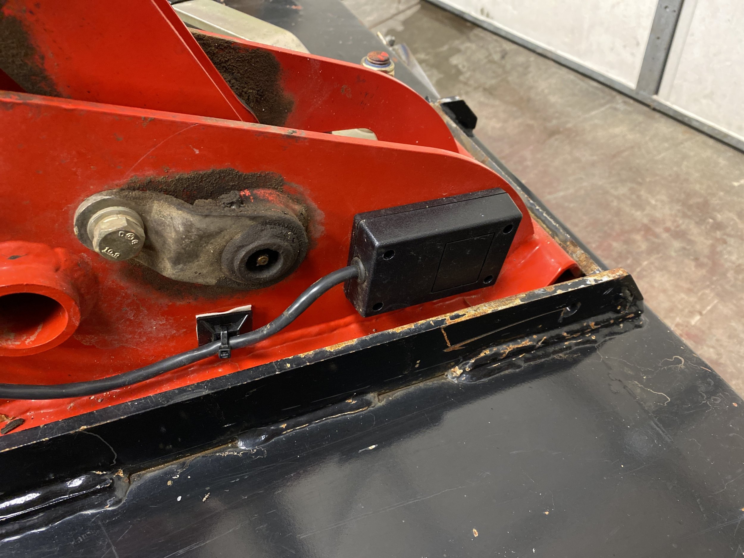

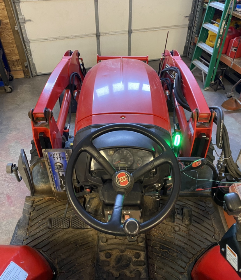

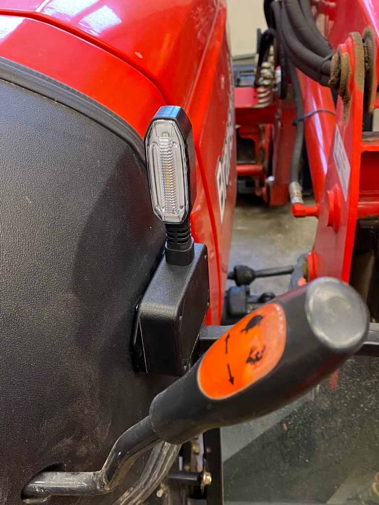

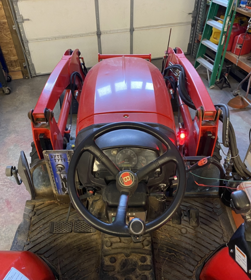

This is my work in progress… there’s two inclinometers, one on the tractor where the light is mounted and one on the quick attach. It’s hardwired between the two and has a power saver feature. I can select the base reference of either the tractor body or relative to gravity. In both modes, I can tare it to zero out (which is useful for different implements). There’s 5 light positions. Green indicates -3° to 3° reference while amber (between 3° and 5°) & red (more that 5°) flanks both side to denote how much positive or negative tilt.
Also added is the 3 level dimmer selection. All from one momentary button to select level mode, brightness, tare, and power on/off.
Pics shows mock-up testing of LEDs. It’s now hardwired into place and am doing trials.
What is the Byte Tyte to the left of the steering wheel? Very interesting setup on the leveling system!
Thanks, I’ve got to make a clean video of it in operation. The Byte Tyte is an aluminum chainsaw scabbard. Insert and a few turns of the handle grips it solidly. Comes in different lengths.
