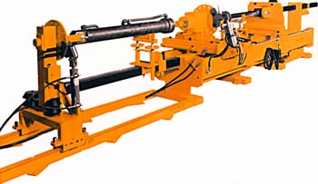

Herein is an excellent example of a hydraulic
cylinder repair machine for you all.
