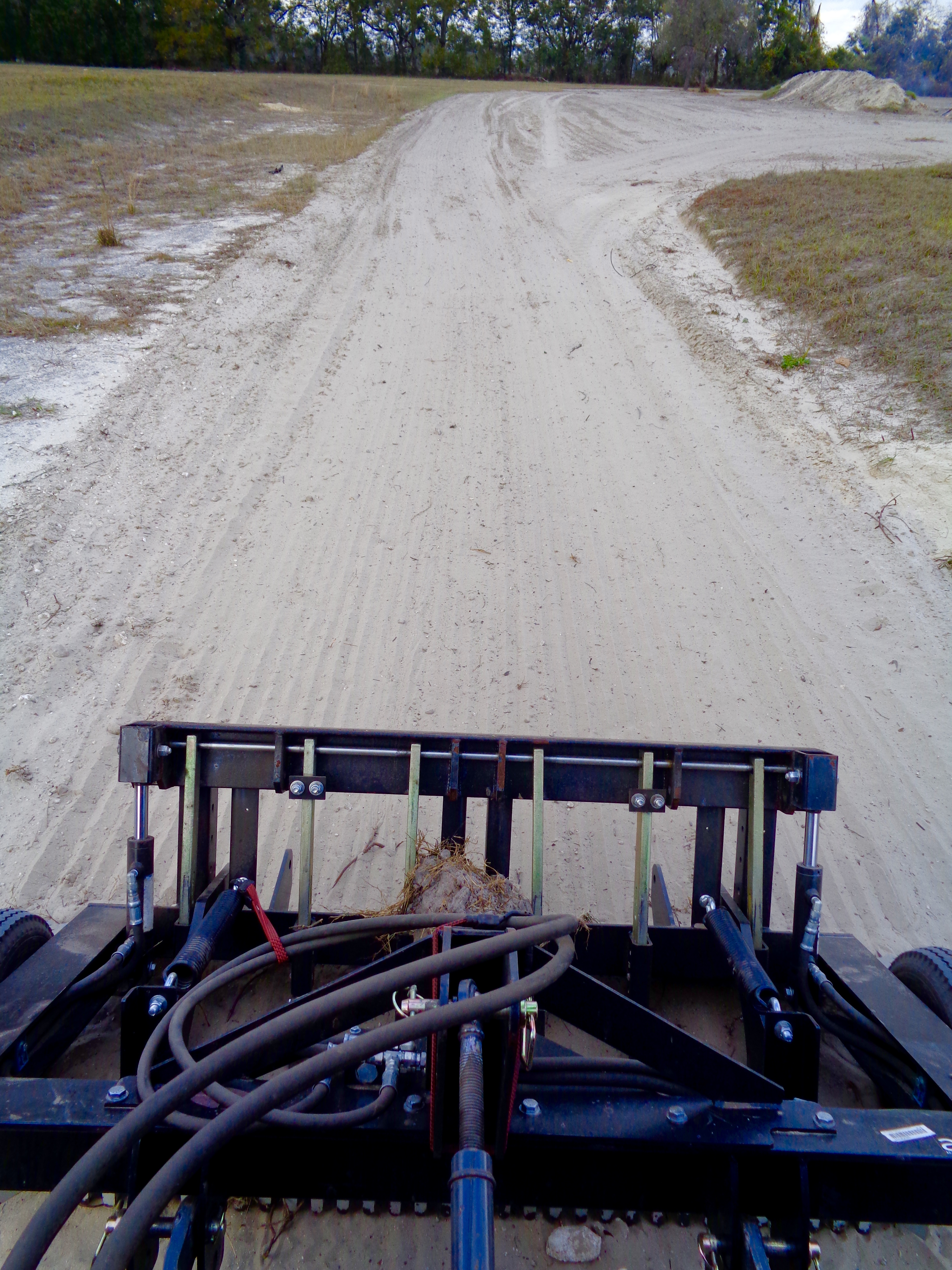

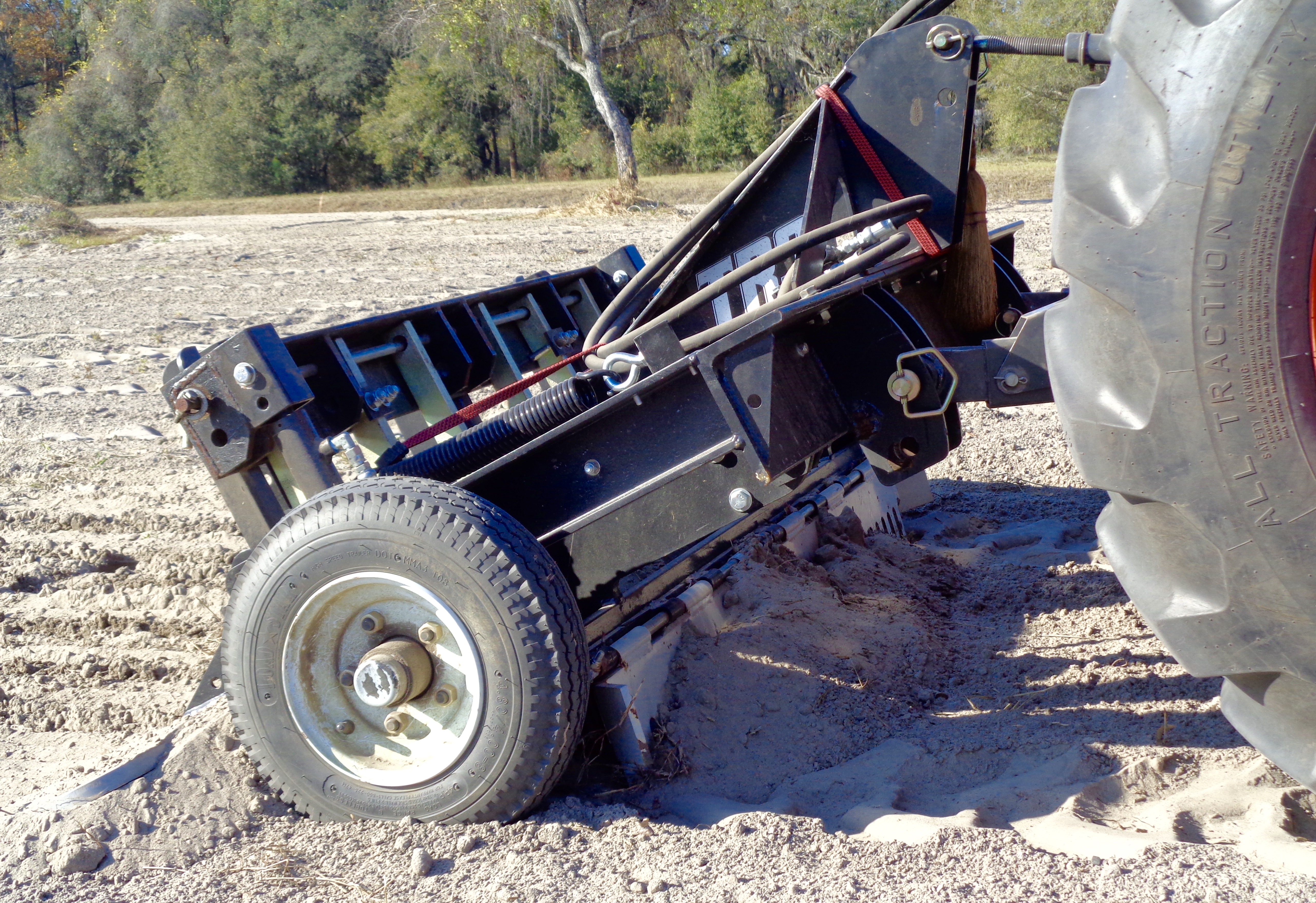

Disc Harrows are adjustable for cut. Adjust the front and rear Disc Harrow gangs to less aggressive angles, then disc again for smoother output the second run.
I second a Land Plane as the most reasonable implement to succeed the Disc Harrow. Land Planes work best where grass and other vegetation is gone. You want the LPGS to be a finishing tool, not a primary grader.
VIDEO: land plane leveler - YouTube
An ABI TR3 Rake, a dedicated smoothing implement, would also follow the Disc Harrow effectively. Pricey.
VIDEO: ABI TR3 rake - YouTube
