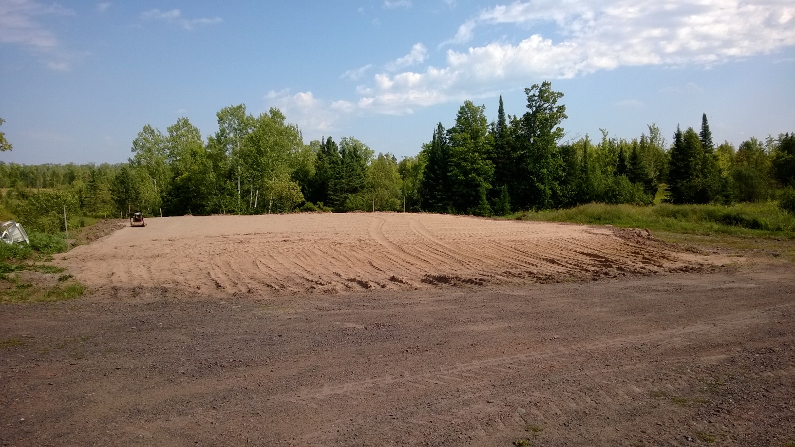

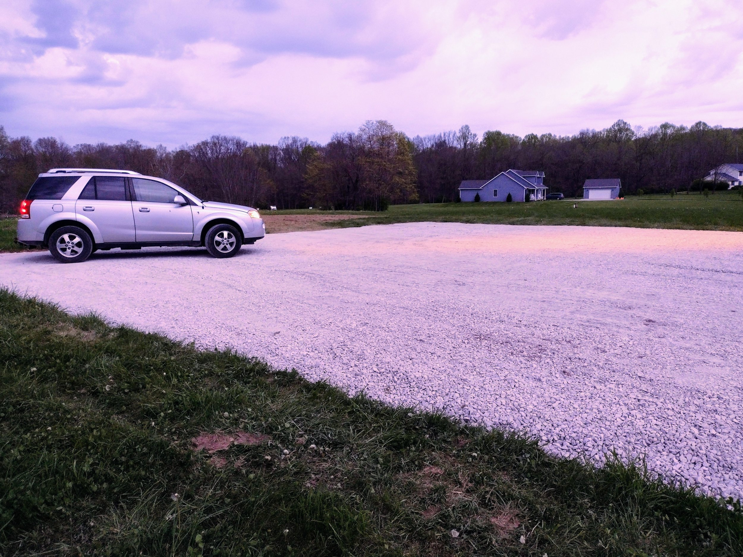

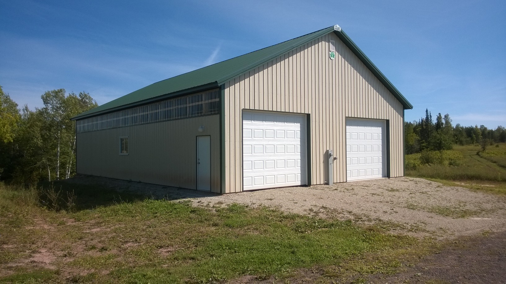

   / Leveling a barn site #13
Up here we don't build them even with the ground, because of frost. My 40x60 is on a raised sand pad, but the back end is on a hillside,
I had to use 400 yards of compacted sand.
A friend of mine bought a house with a pole barn that was even with the ground and the concrete is cracked and the barn itself is coming
apart in some places.

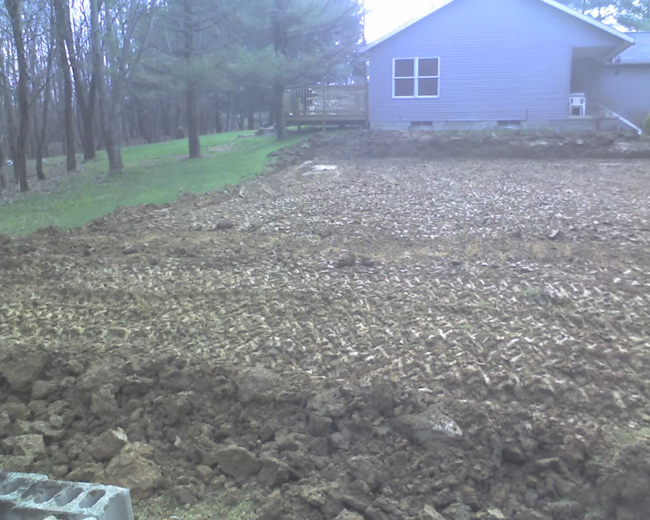

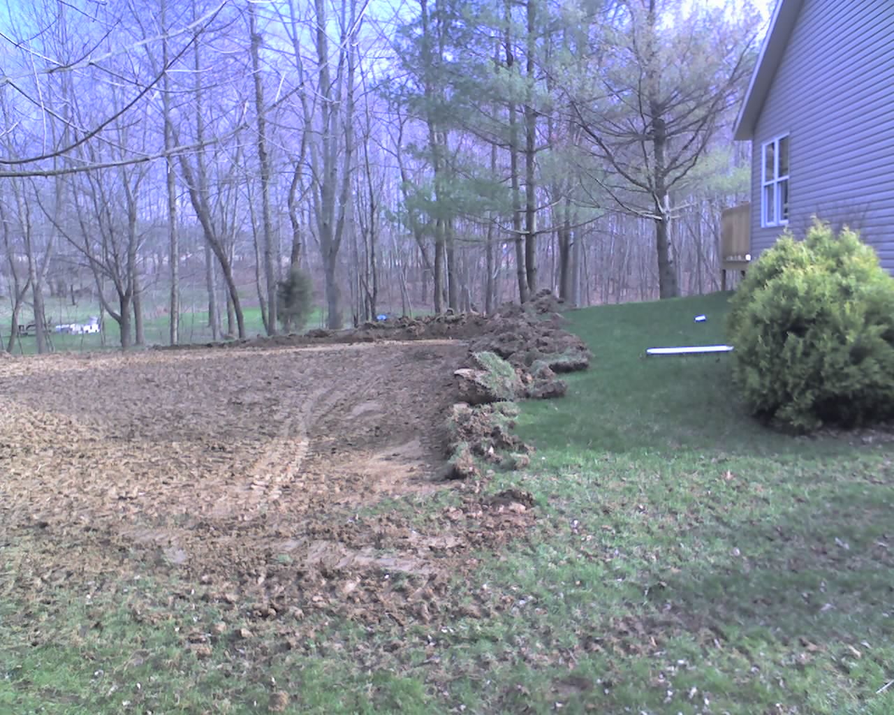

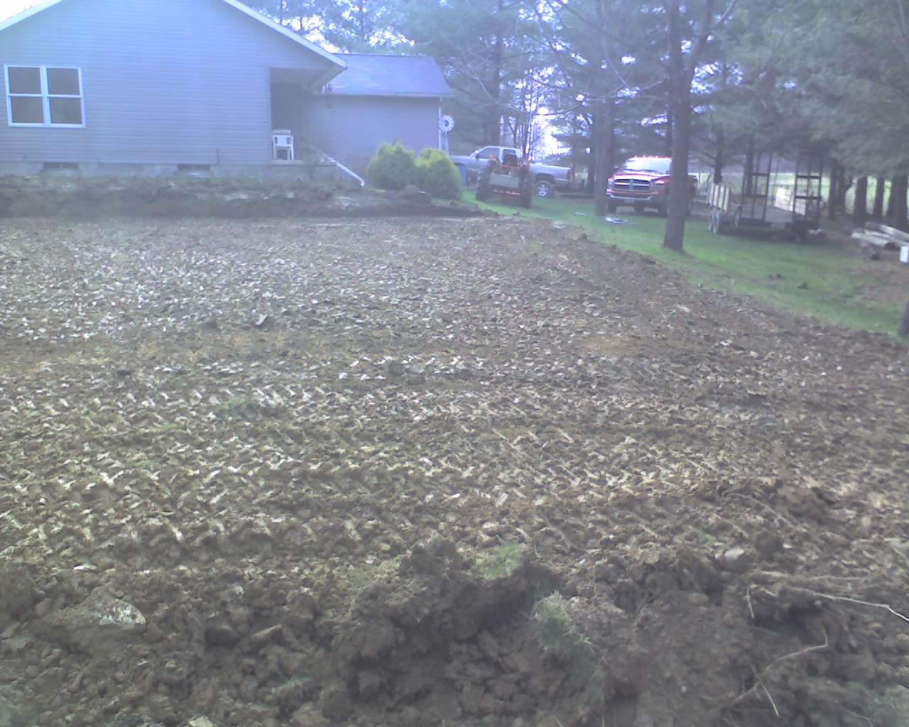

   / Leveling a barn site #14
Moving the dirt isn’t the problem, compaction is. Needs to be compacted in 3” to 5” layers with plenty of water to ever think about being done right.
   / Leveling a barn site #15
This is very conservatives you can be more aggressive then that, 6'' to 11'' depending on material size and compaction equipment and yes plenty of water.
   / Leveling a barn site #16
50' run and 80" elevation change....but at what width?
I had a real similar elevation change......around 6" over 50 when I built my first 30x50 polebarn at my old house ~15 years ago.
Had a L3400 kubota....did it in a day.
Assuming you are taking the 40" from the high side and building the low side up with that dirt til level right? Thats what I did......packed fine. Constantly driving over a single bucket load at a time.
IF the area is for a 30x50 pad similar to mine......and thats your plan......going from middle of the building slowly digging into the hillside......thats only ~50 yards of dirt.
I think others are making this way more complicated than it needs to be. Sure you could get an excavator or skidloader and do it in about 2 hours.......but its not like its gonna take you a week with a tractor like some seem to think.
A tooth bar would certainly help.....or another means of breaking up ground....(till it or plow as you go).....but clay that is moist isnt bad to dig at all with a FEL.
Here are 3 pics from about ~15 years ago..... This was done in ONE day with a L3400 gear tractor
