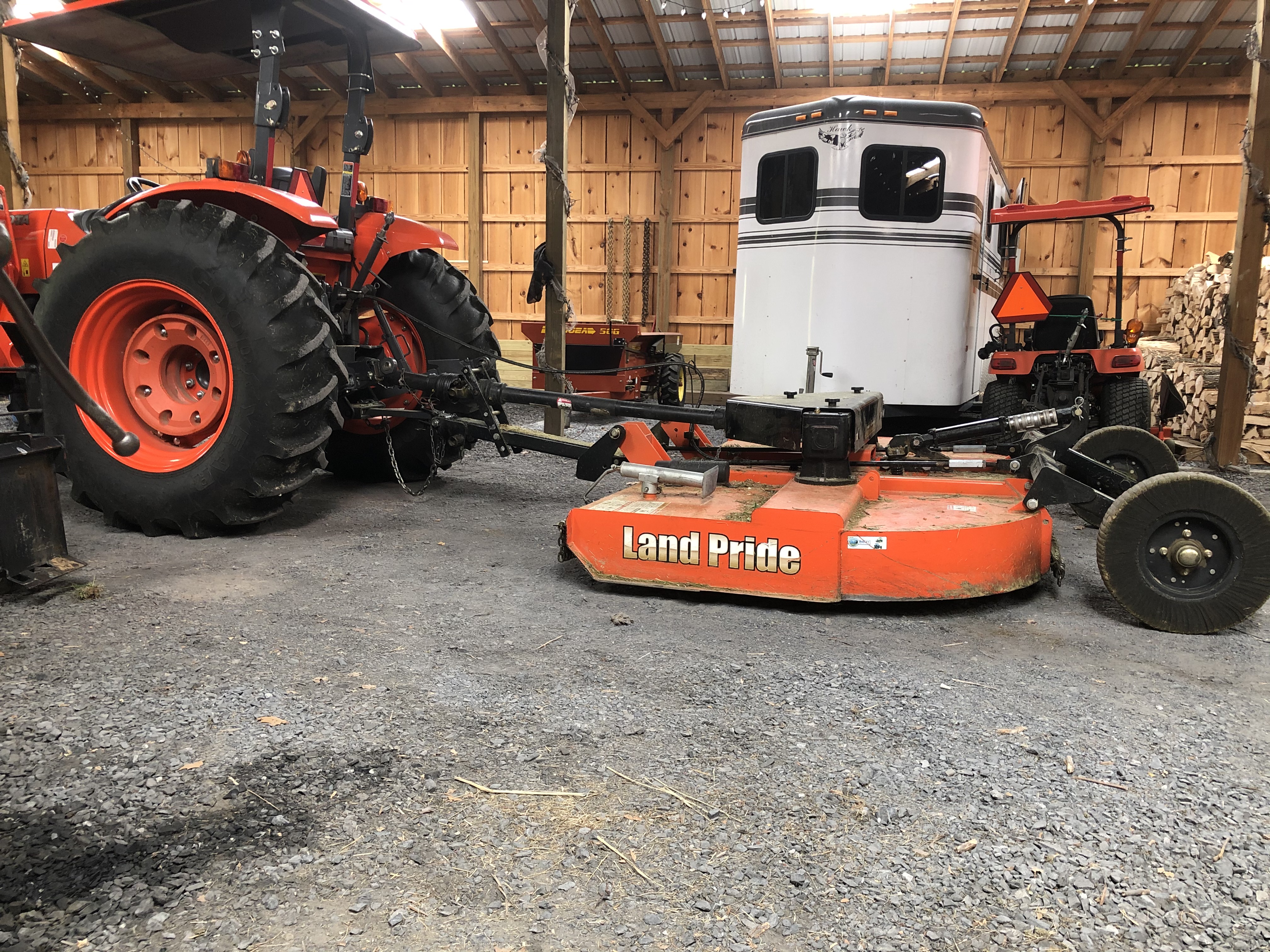

Posting a picture taken from the side at a low elevation might help diagnose.

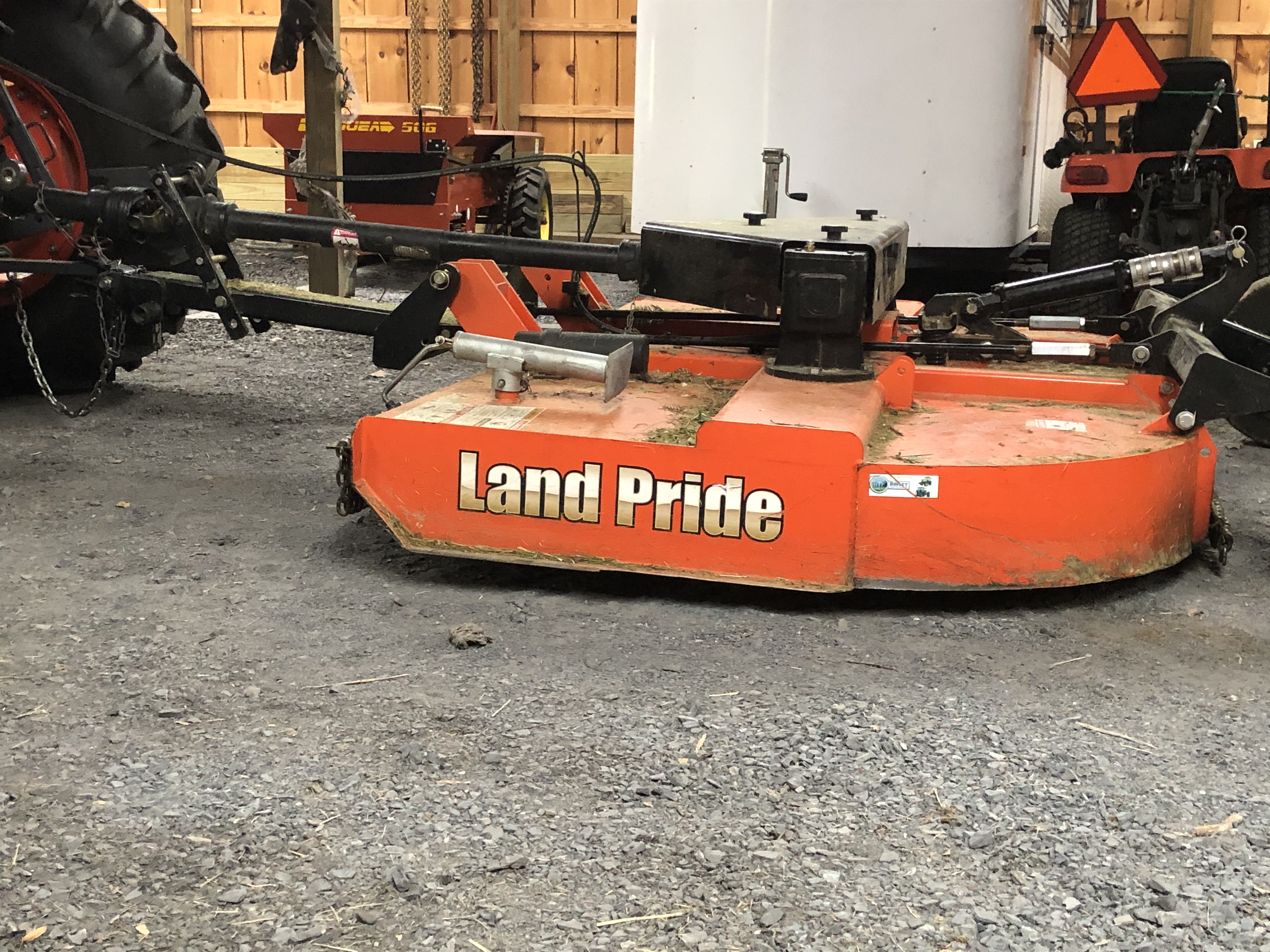

In any event, (hopefully) attached are 3 pics:
View attachment 652908View attachment 652909View attachment 652910

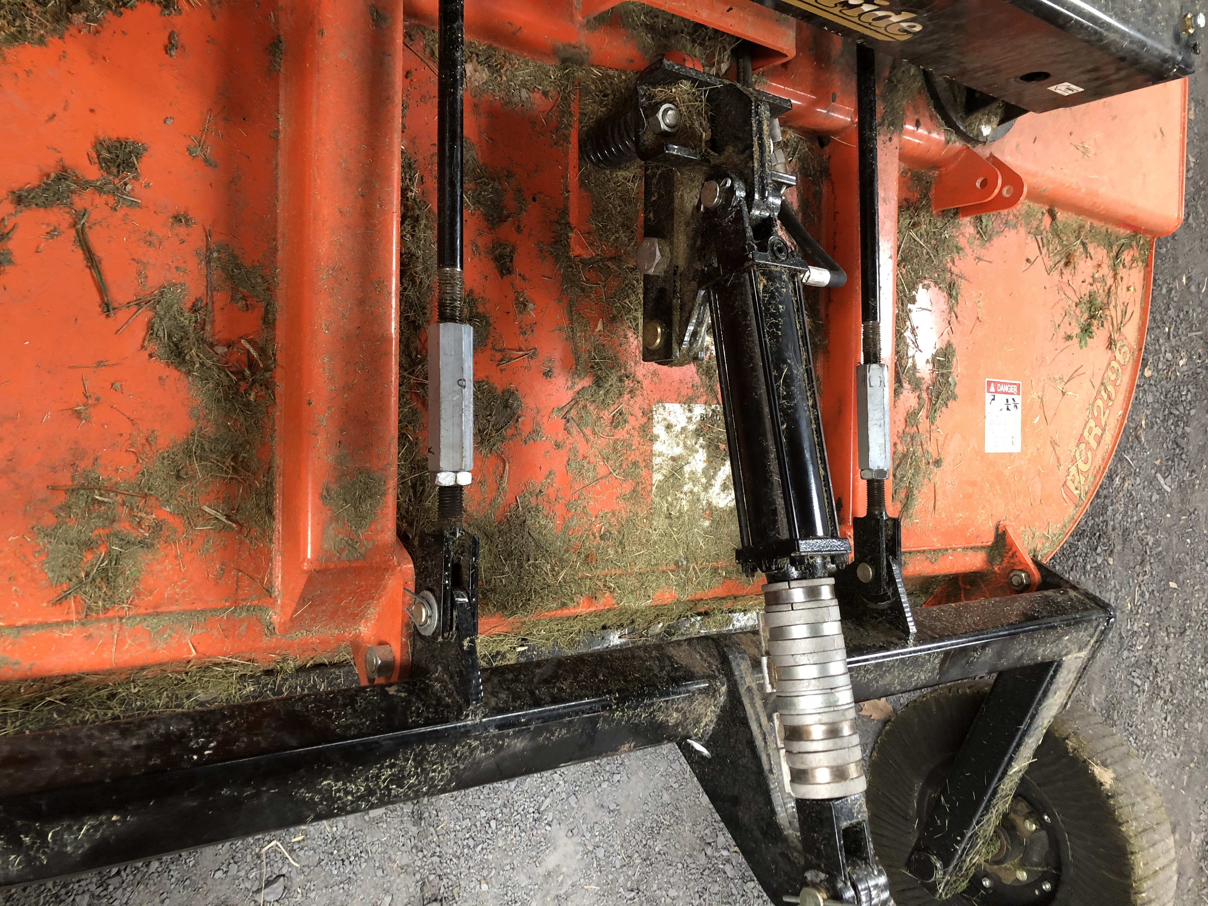

The 3rd is the leveling rods and stroke control spacers which allow me to adjust the height of the cut.
The 2nd is a side view of the mower - it is at the level which I typically use to cut. The pic should show that the front is clearly higher than the rear.

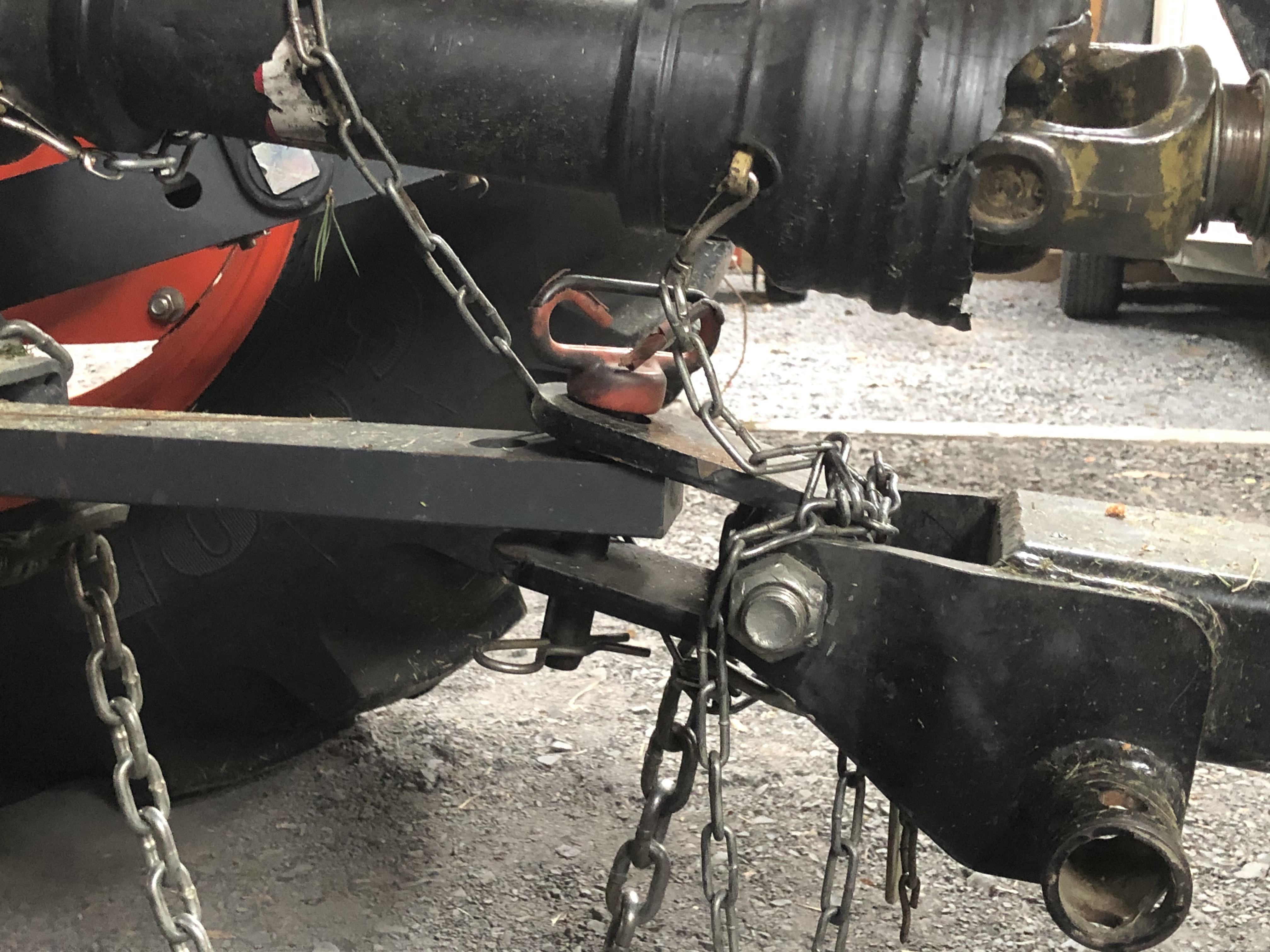

The 1st is the connection at the drawbar. The clevis slopes down a bit. If it didn't, the front would likely be even higher.

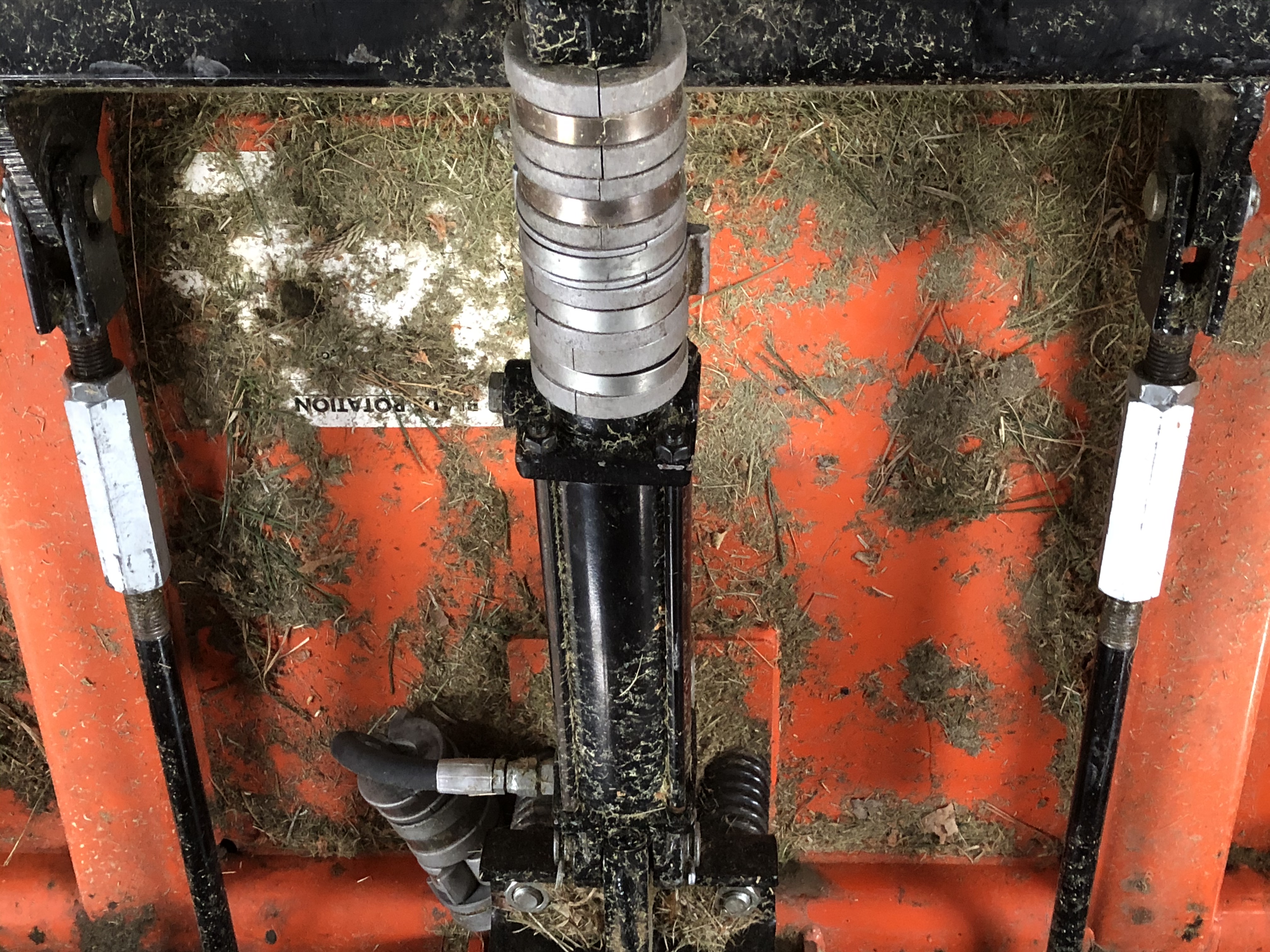

/ Leveling a Land Pride Pull-Type Cutter #6
I don’t have this kind of mower and maybe I’m missing something, but it looks to me like that assembly in the last picture adjusts like a 3pt top link. By lengthening it you will draw the tail wheel in thereby raising the back of the deck preferentially. It looks like it is at its shortest adjustment currently. ???
/ Leveling a Land Pride Pull-Type Cutter #7
The turnbuckle adjustment looks to me like it needs to be shortened to get the front of the mower to drop.

Fixed.
The hydraulic cylinder on the back sets the rear height. One uses the turnbuckle to adjust the front. As the back end is fixed, lengthening the two leveling rods push the front end down (just like the manual stated!).
It bothers me a little that the two rods (one long, one short) that screw into each turnbuckle have 3" of thread...to get the front end lower, I had to expose 2" of thread thereby leaving 1" of thread in each end of the turnbuckles. Wish the turnbuckle was longer than 5" as I would prefer to have more than 1" of "connectivity".

I ignored the lack of tension on the turnbuckle and kept lengthening the leveling rod.
It regained tension as I went and the front came down about 2X as much as the back. Had to add another stroke control spacer but when I was done, I was level. A few more twists pushed the front down lower than the back. So, I tightened up the jam nuts and declared victory.
I'm not 100% sure that it will be level at the travel setting (12-15') but it cuts better when level or slightly sloping forward...which is where it is now.

I'd say that the hitch could actually be a bit low, based on the prop shaft alignment. The top clevis would normally not have a pitch down angle.
The deck height is of secondary concern. I'd look at the BLADE heights, maybe gearbox differences ? blade upside down ? The usual.
/ Leveling a Land Pride Pull-Type Cutter #12
Can you flip the drop hitch to level the towbar angle ? Seems like the rod pull engagement would work as well.
