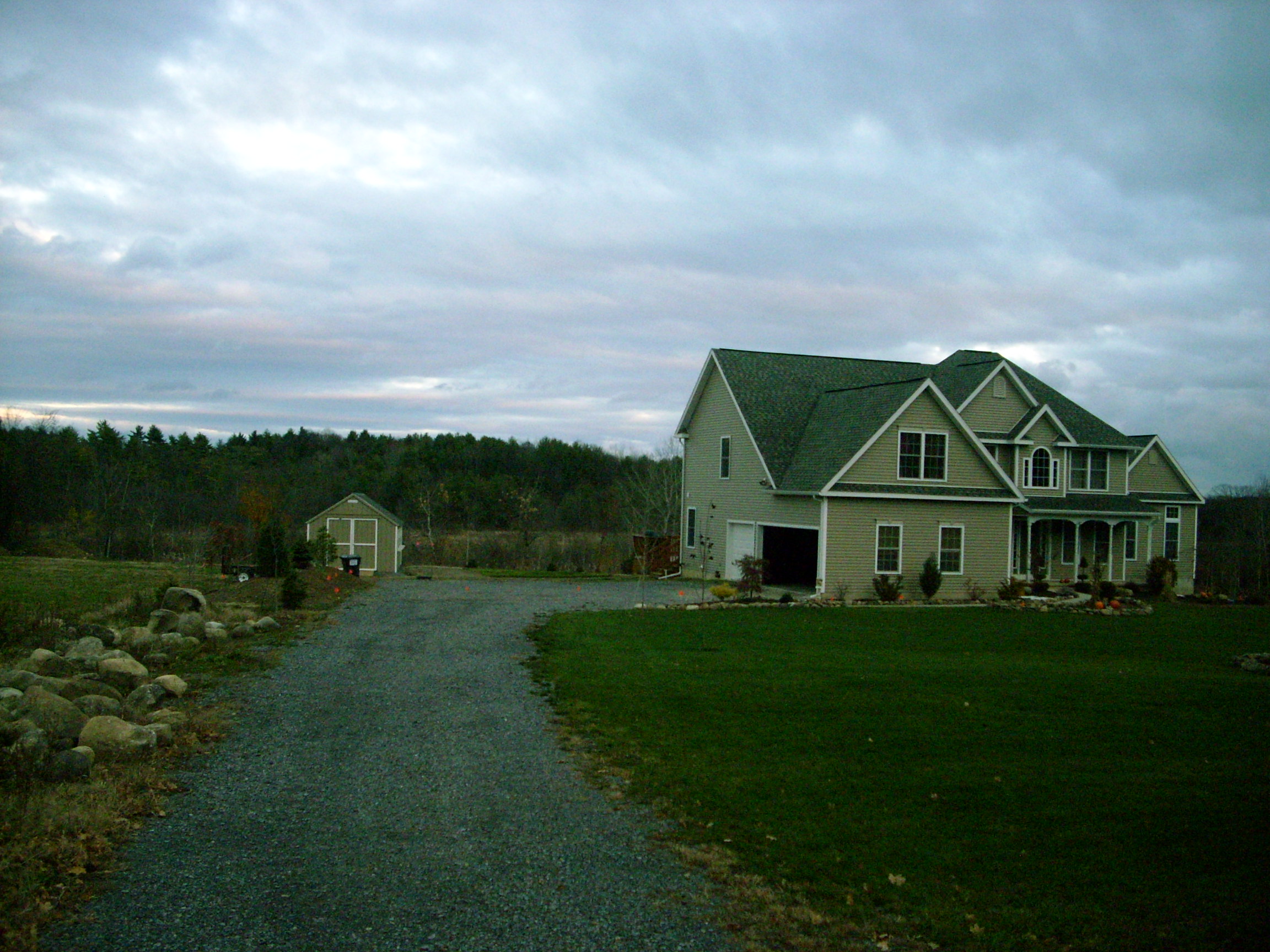

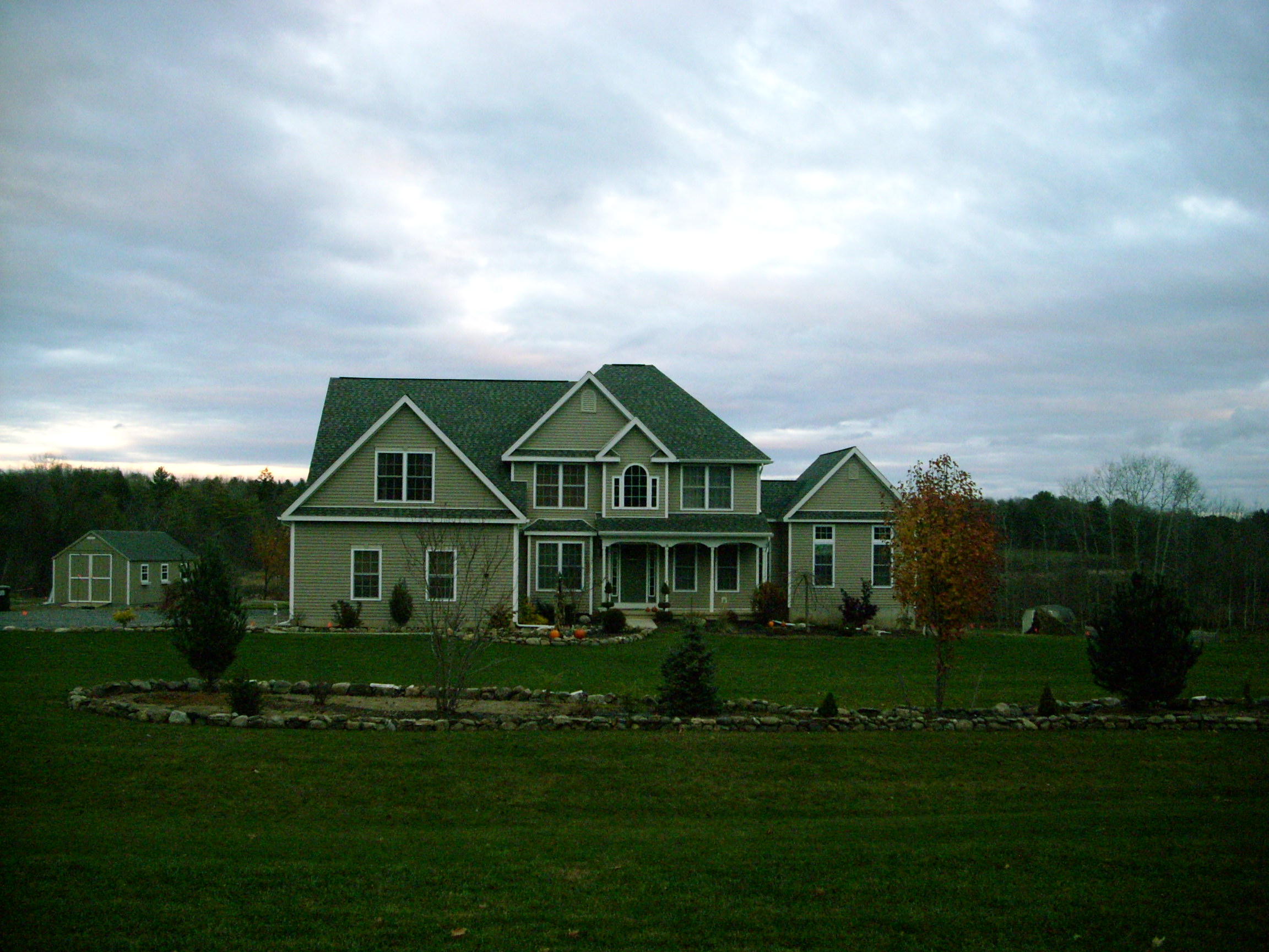

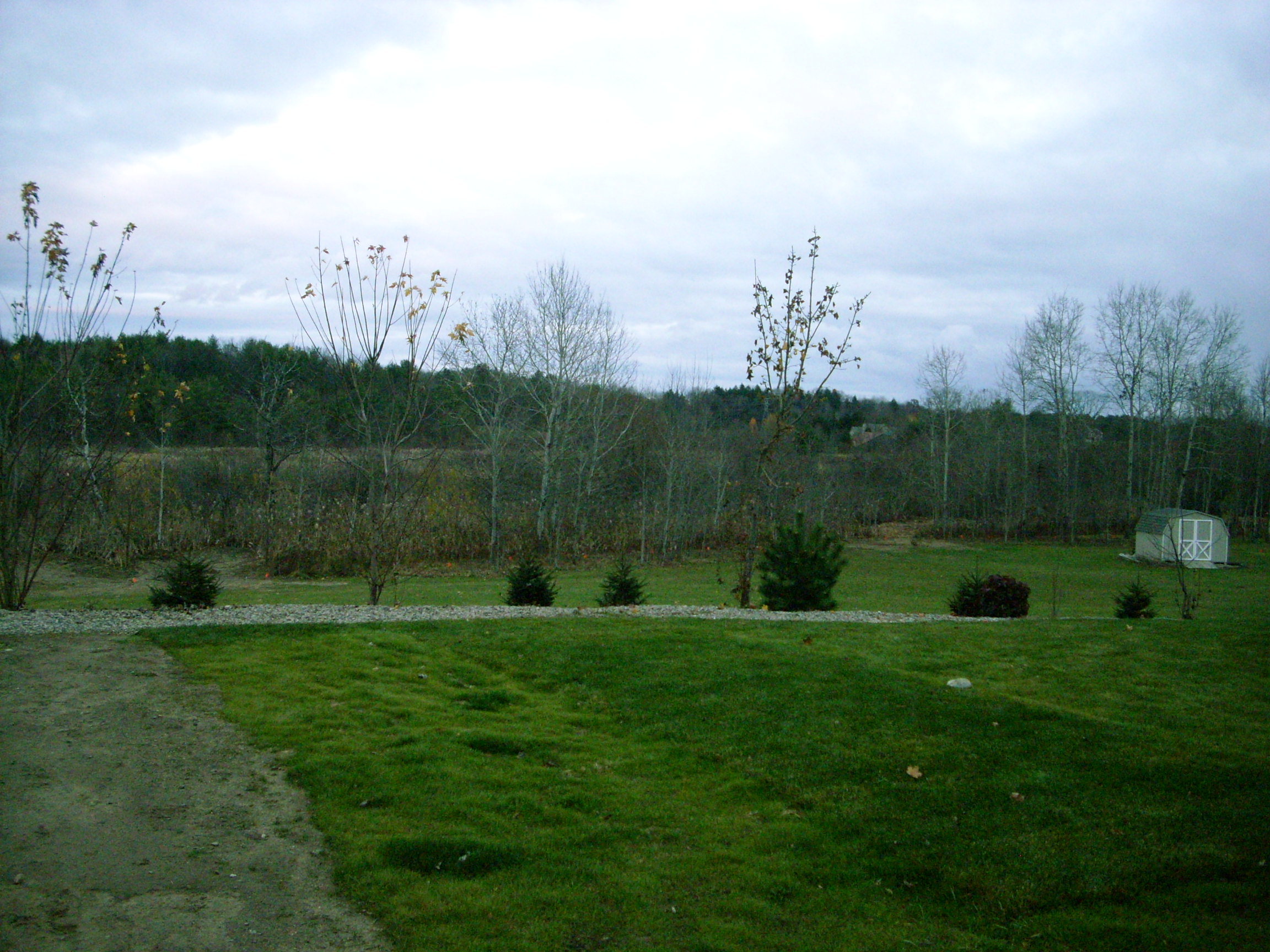

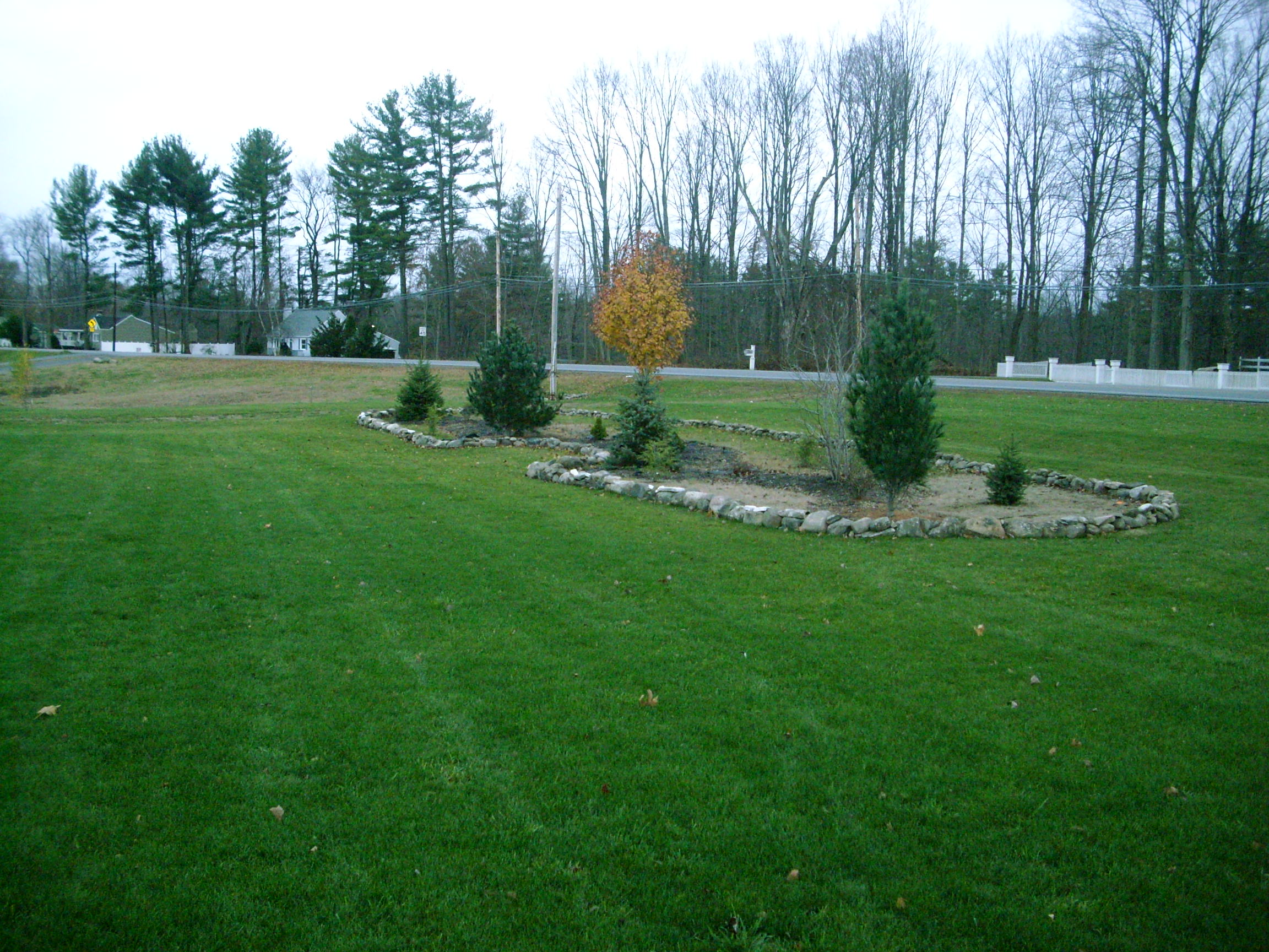

Hi Guys, I have about 1 acre of my property that has a mild slope to it and I would like to level for a flat playing area for my kids. They can play there now the slope is pretty minimal but I want to flatten it. It is old cow pasture so there is a root system growing that I just keep mowed down seems to be mostly weeds and some grasses. I have a landscape rake and a box blade to work with. I would like to do myself instead of hiring a dozer job out as I want to get more seat time in :D I would also like to do w/o spending a bunch of money on a rototiller. Do you think it would be possible to do myself w/ the 2 attachements I have or what would you recomend?
I tried taking a couple passes through the other day from high to low point w/ the rake down but it didnt seem to bite in enough to move enough earth. Thanks!

Thanks for the replies guys. Ideally when done I would want this whole area in question to be golf course materiel lawn. (I am a grass geek :D) So I will most likely have to bring in some top soil after its leveled before I had it hydroseeded. I only own 3 acres but maintain about almost 5 in which 2.5 of this is wooded so my plan is to have all the open areas of my property plush lawn. I plan on ripping everything up and again having everything hydroseeded. The rest of the property really needs no leveling so this I will most likely round up everything, use my walk behind tiller and then york rake it out and spread some top soil and have hydroseeded. I have attached a few pics of the back area in question. The first pick is the area we have been discussing (behind the tree line) Actually on the right of this field and the back along the wood line is nice and flat its just the left side that has this mild slope. I also have plans on a stream and pond back here as well. Other pics are of the front that I plan on also ripping up and starting from scratch. I was origiannly just going to hire out a dozer job for the back but I was hoping I could tackle myself and get in as much seat time as I could.
