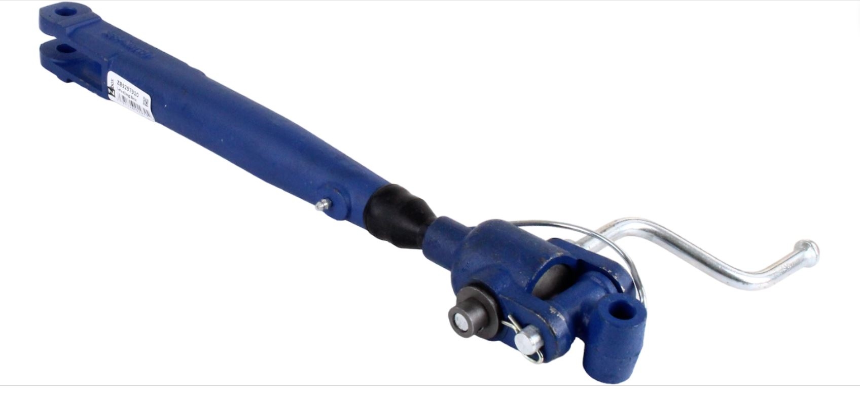

I am thinking of buying a box scrape.
If I want to create a slope with the box it will be necessary to raise one side of the box scrape. That being said, I saw a "Leveling Box Lift Link 3 Point Hitch ".
How does it work? I assume it is easier than using the threaded side lift arms, is it?

It is easier than using the twist type links. I can sit in the tractor seat and turn the crank and adjust the leveling on the attachment. You will quickly learn to adjust the link with no load on the arm.

If you don't want to invest in to that set up. The Leveling Box Lift Link, could work for you. I would replace the "fixed" side link with it. (the solid bar side, so you'll have one on each side).
You'll need to make sure the ends will fit your tractor model...
Either way, I find that adjusting the side link, (before hydraulics!) it's easier if you place a 4"x4" in the middle of the box blade. Raise and lower the BB on that piece of wood and you can make adjustments faster. Raise and lowering relieves pressure, so you can adjust it not being under pressure.

I'll second the top and tilt. That makes box blading a lot easier. The top link is more important than the tilt as it controls how hard the blade bites. The tilt is needed when you want the blade to be at a different angle than the rear axle, like when you're trying to put a sideways slope on a road.

Convenient but way too expensive for occasional use. A bevel box levelling arm is a much hbetter alternative and besides, you don't need an additional hydraulic outlet set to operate it. Keep it greased and be happy you didn't spend thousands on a hydraulic link when you can buy a bevel box for under a hundred bucks, www.agrisupply.com

You obviously have more spendable income than I do but then a hydraulic top link was never in the cards for me. Besides both my M9's have factory bevel boxes as well as extendable / retractable lower links on them plus I have the fender mounted 3 point actuators on both. A grand plus versus 200 bucks (top end bevel box) is a no brainer for me. Even my 71 year old wife can crank it just fine, but I keep it greased, just like the rest of the units...

I love the one on my 67 Ford. Just crank right from the seat. Way nicer than the turnbuckles on my newer tractors.

your leveling box looks like exactly what I need. The side lift arms on my mahindra have forks on both ends and I can only find the boxes with the knuckle on the top end. Do you have a link to the one you purchased?

Here you are Keith; you may want to email the seller for dimensions just to confirm fit.
I hope it works for you! I've been happy with it; it may not be hydraulics, but it's night and day over a turnbuckle.
