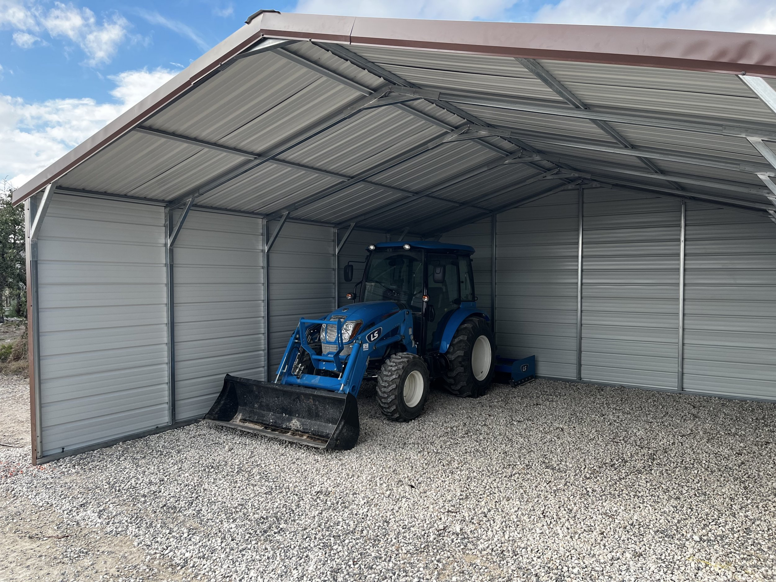

My tractor has a cab and it fits inside an 8' garage, its exactly 90" tall to the top of the cab. The shed I'm building is 8' side walls, its gabled trusses so the sides are the lowest spot.

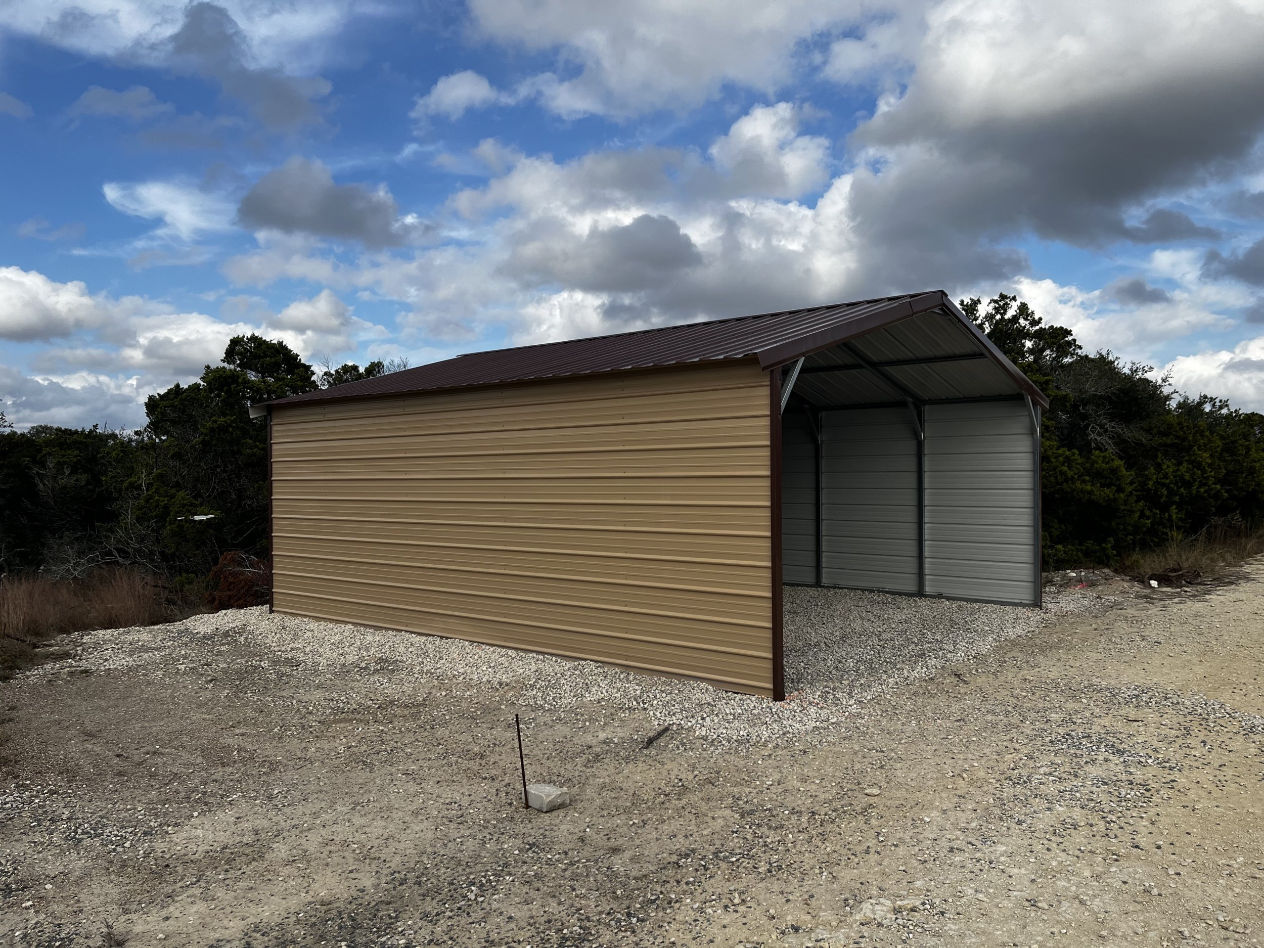

What type of metal shed are you putting up? How is it going to be anchored to the solid rock under the gravel?
I priced a similar project a few years ago. The price for the building looked good until I found out the contractor charged a lot extra for rock work. Since the proposed building was on ledge rock, the cost almost doubled and I was forced to make other plans.

I'm installing from a local contract that has been building these in the area for over 10 years. The brand is "quality outdoor products". The framing in constructed of 12 gauge steel and the roof trusses are prebuilt/welded. Since the area I live in is predominately rock (less than 2" of soil depth anywhere on my acreage), the installers are equipped to deal with it. They basically drill 2' deep holes into the rock with a bit that is slightly smaller than the anchor pins they drive in. The building and anchors are rated at 130MPH winds, so I hope it all works as they say.

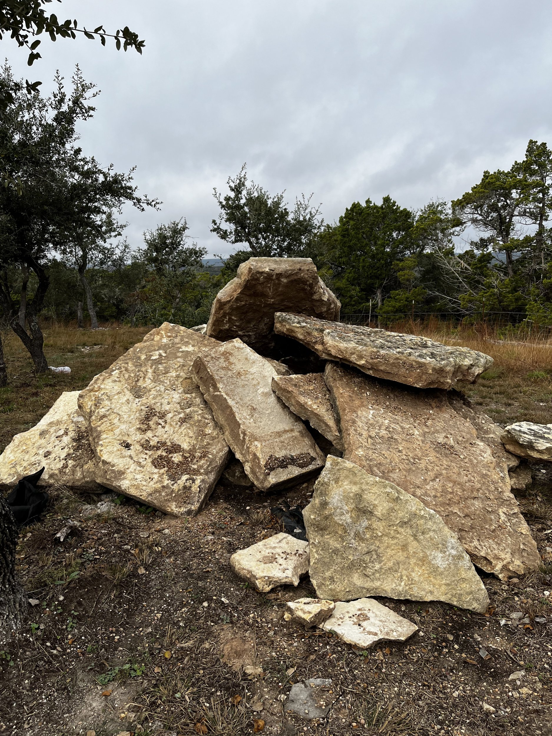

I was able to borrow a plate compactor and run it around the perimeter where the base plate will install. Fortunately (or unfortunately) things around here don't settle or shift since they area is layers of limestone. Below is a picture of the layers of rock they busted up and stacked up when we had our pool built. Each of of those slabs is at least 3'X3' and this is just a small pile of them
