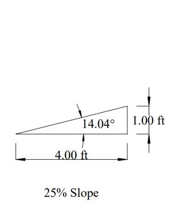

So, we are all talking about the same thing, attached drawing explains % slope and angle of slope
Normal highway slope is 2 horizontal to 1 verticalView attachment Slopes Explained.pdf
Normal highway slope is 2 horizontal to 1 verticalView attachment 666132

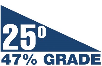

I wondered if anyone wound notice the 25% Slope in the title of this thread.
25% slope is only 14 degrees, not steep at all:
25° is a 47% slope, steep and hard to walk on:

In all my years working heavy construction I never saw a slope shown as % or degree, the were always shown and staked as 1.5/1,2/1 etc. The steepest slopes I ever encountered were 1/2/1 and that was in open pit mines and looks vertical to the naked. I landscaping there were a lot od 3/1 and 4/1 etc. . As noted the first number is horizontal and the second is vertical.Grade checkers kept track of progress using a hand level and engineers folding rule to place progress stakes every 3 to 4 feet. Surveyors placed stakes at the top of cut slopes like the op is talking about or at the bottom of fill slopes.
Usually the steepest fill slopes allowed are 2/1 and, depending on the type of material, cut slopes may be as steep as 1.5/1 but in modern times are more likely to be 2/1.
