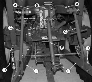

I feel like a moron for asking this. How do I level the rear blade? I have a little MF SCUT with a woods 60 inch RB. I'm trying to use it to clear our driveway. When I angle it to plow the snow to the side the leading edge really digs in. (As per this site's advice I've tried usng it backwards, it doesn't dig in, but I cant get much of an angle to push the snow to the side) It's visibly uneven, I tried adjusting the turnbuckle on the right side but it never quite worked.
Am I missing something really obvious.?
Be kind I have about 4 hours total in my life thus far using this type of equipment.

On one of your lower arms on the three point hitch.....don't you have and adjuster that you can turn to bring the blade to level? It is usually on the right lower arm.
   / Leveling rear blade, How? #3
See the attached picture for reference. On my JD990tractor, the right hand 3PH arm has an adjustment mechanism so you can raise or lower that side to level the implement. In the picture it is labeled as Item "G".
