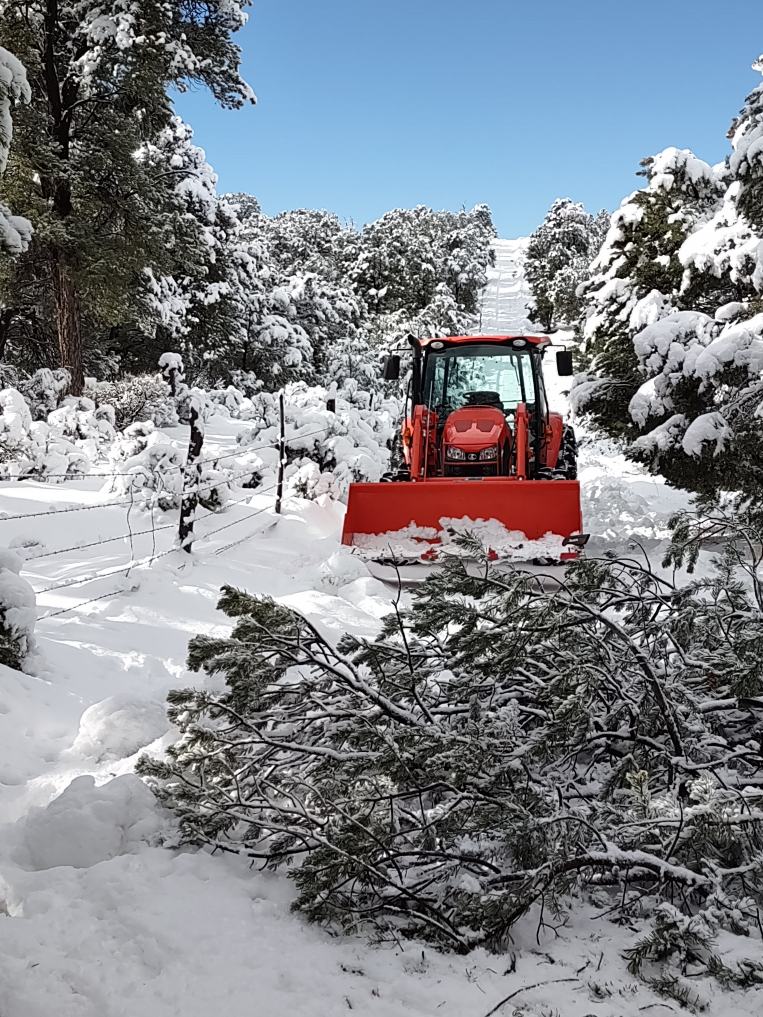

^^^Very nice blade. You should be able to straighten out your "roller coaster" roads while plowing snow with that thing. Many of us don't plow unless the ground is froze. We just drive on the snow to make a packed down layer that allows the plow to ride on. If you rarely freeze up, that would be a mess all winter long....good luck.
Thanks, I can't wait to get this WR Long kit so I can adjust most everything on this blade from inside the cab.
Last year we got 20 inches of snow over a couple of days. It was wet and heavy and started to melt in the afternoons. I plowed it twice with the rear blade, leaving about 1-3". It got packed down with traffic, but it's not like in colder areas where the packed snow stays as packed snow. Here, with the warmer temps and the sun, it will start to melt and re-freeze into ice. So my roads turn into ice covered roller coasters.
